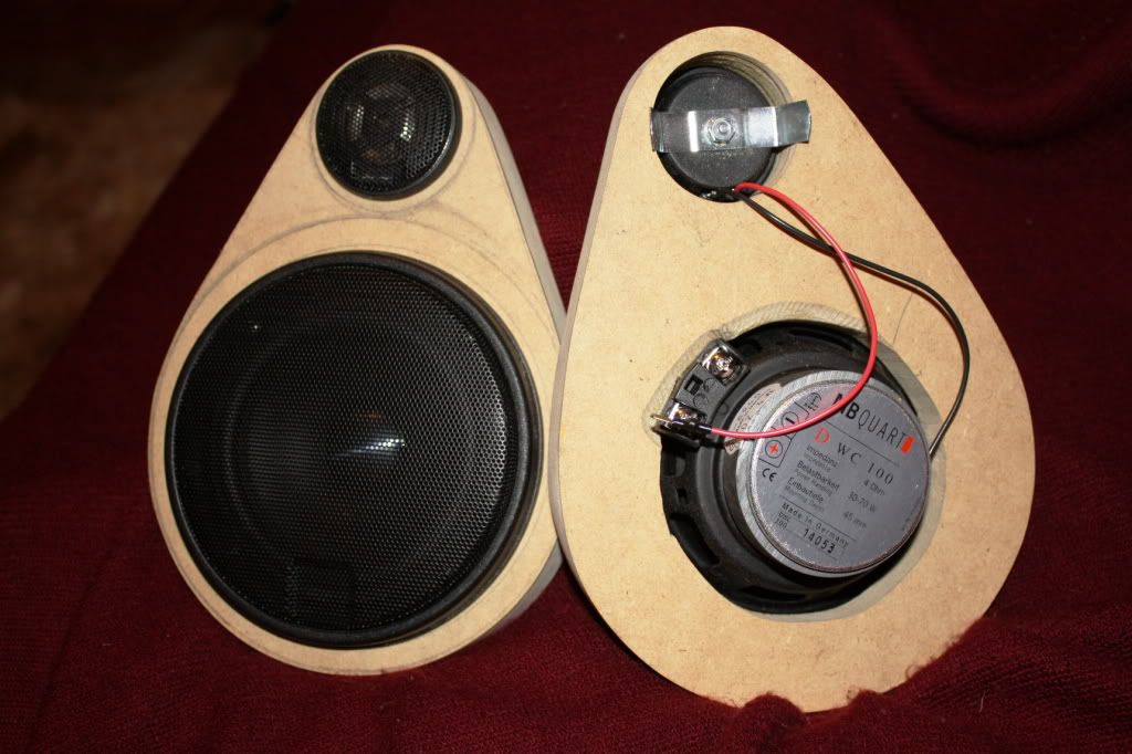

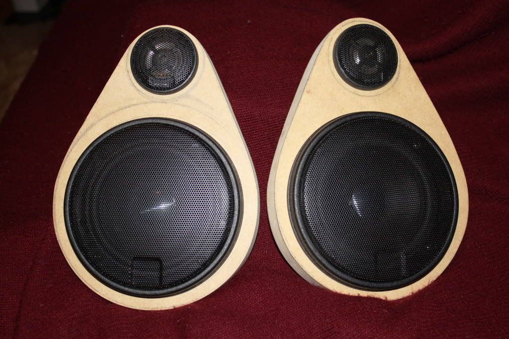

This update really isn't anything you guys haven't seen
before but its not yet documented in my build. I drew
up a tear drop shape for the Quart 4" and tweet. Cut
that out and drew out where the mid and tweet would
be located. It really looked too large so I reduced that
down quite a bit to a shape just small enough to hold
the drivers. These parts will be painted red (I think)
with the rest of the kick paint matched to the exterior
of the car. I took the factory kick panels out of the car
and took a mold of those. Again, nothing you guys
haven't seen. I had some issues with some old resin
not setting up so I went and purchased new. I had to
make up some hot batches to flash the old resin. I'm
quite glad this worked, I **** sure didn't want to re-
mold them. I hope this weekend I can get those molded
parts trimmed to near the shape they should be. I'll then
remask the inside of the car, place the new kick in and
bondo them for a more exact fit. Again, nothing you guys
haven't done. However, I will take pics of this process to
show just how cramped the working area and what lies
behind the panel. You'll see how very well made these
little cars are.
