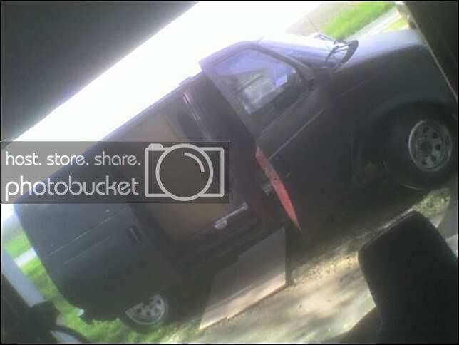

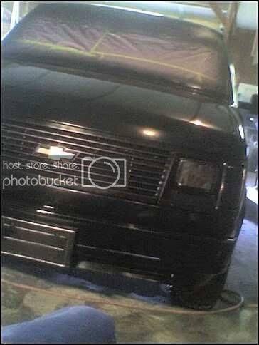

I recieved this van in pretty poor condition...
Busted motor mount, hole in fuel pressure regulator, ****** slipped, etc.. etc..
A big *** dent in the front right quarter panel, and dents in the roof, from being walked on:rolleyes:
I yanked a rats nest of wires, buttons, switches etc.. Was like my little nephew wired this thing..

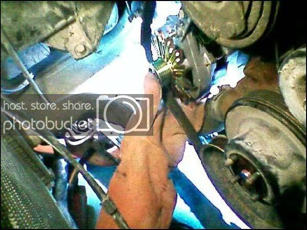

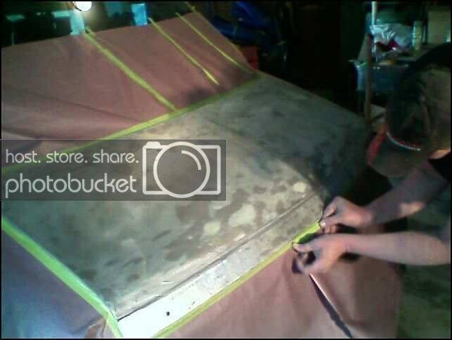

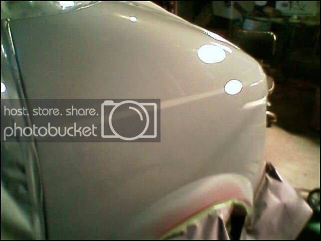

Anyway- Pulled the smog pump, pulled the dent out of the fender, pounded the dents in the roof up, thats was fun- and had to chisel a piece of the motor off to get the 2nd alternator in..
Im sure it was just their for decoration anyway;)

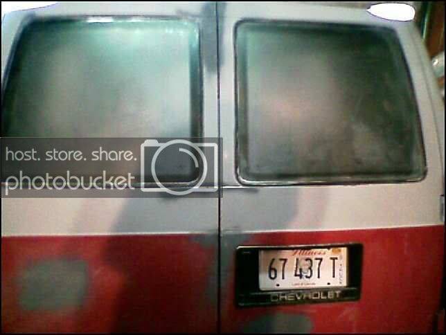

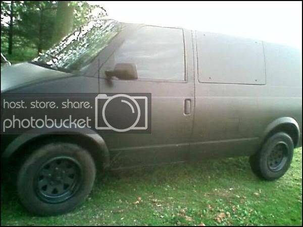

I DA's the side and rear windows w 60 grit, and painted them too //content.invisioncic.com/y282845/emoticons/wink.gif.608e3ea05f1a9f98611af0861652f8fb.gif It worked out **** well!
Rubbed it down with Scuff Stuff and a scotchbrite- Shot the ***** with flat black rat-rod primer from Kustom Shop-
Painted door panels, dash etc.. black

1- 200 amp Excessive Amperage alternator in stock location.
1 300 amp Excessiv. Amp. alt in smog pump location.

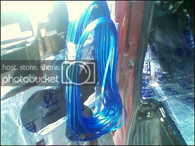

4 runs of 0 ga from front batt to rears.

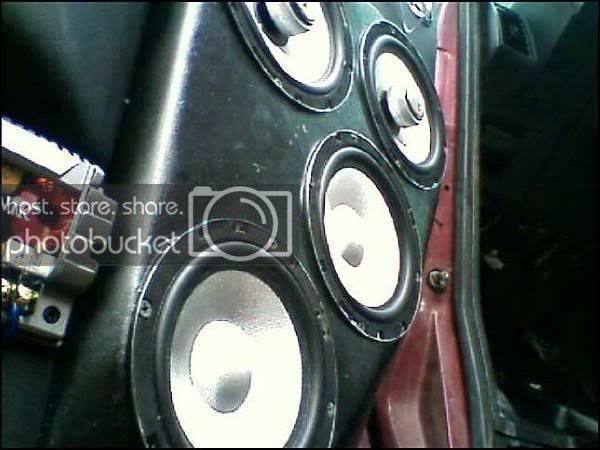

2 sets of Visonik components, and 2 sets of visonik 6 1/2's in the doors. I know i know, but they were free..

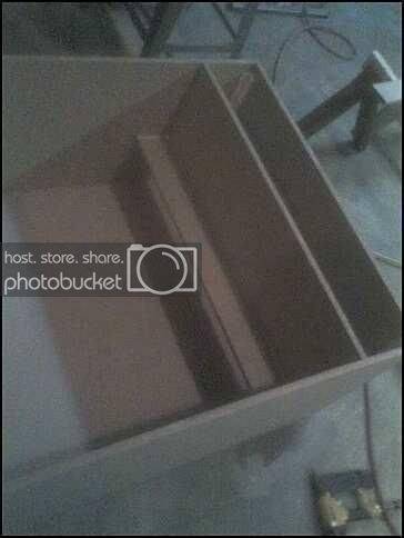

Wall is 21cu after displacement- tuned to 30hz

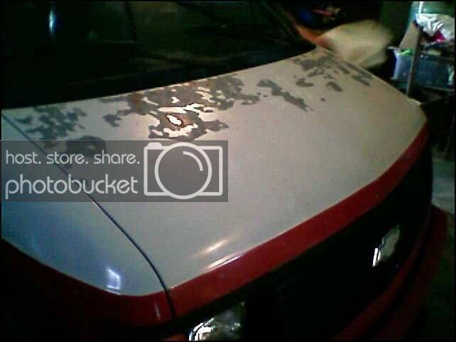

why paint fender white if you just going flat black?
t wasnt white-was grey, i diddnt do all the work in one day, so if you have nothing but metal, humidity makes this stuff called rust.. So you have to cover it w something //content.invisioncic.com/y282845/emoticons/wink.gif.608e3ea05f1a9f98611af0861652f8fb.gif

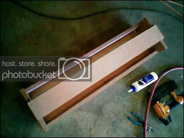

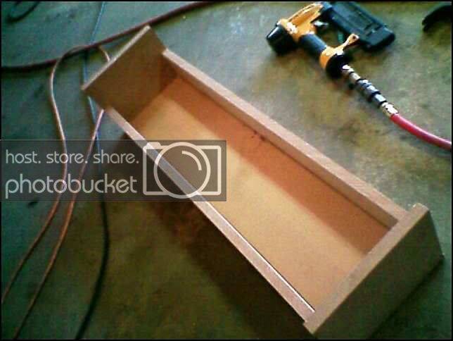

So its almost done, taking a little longer beacuse im building boxes, and installing for customers... It's that time of year.

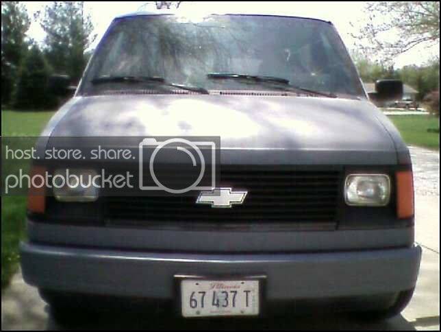

So this is my daily street pounder, and ill getcha numbers soon
Not much of a shop, i basically order when someone wants-- no overhead //content.invisioncic.com/y282845/emoticons/wink.gif.608e3ea05f1a9f98611af0861652f8fb.gif
