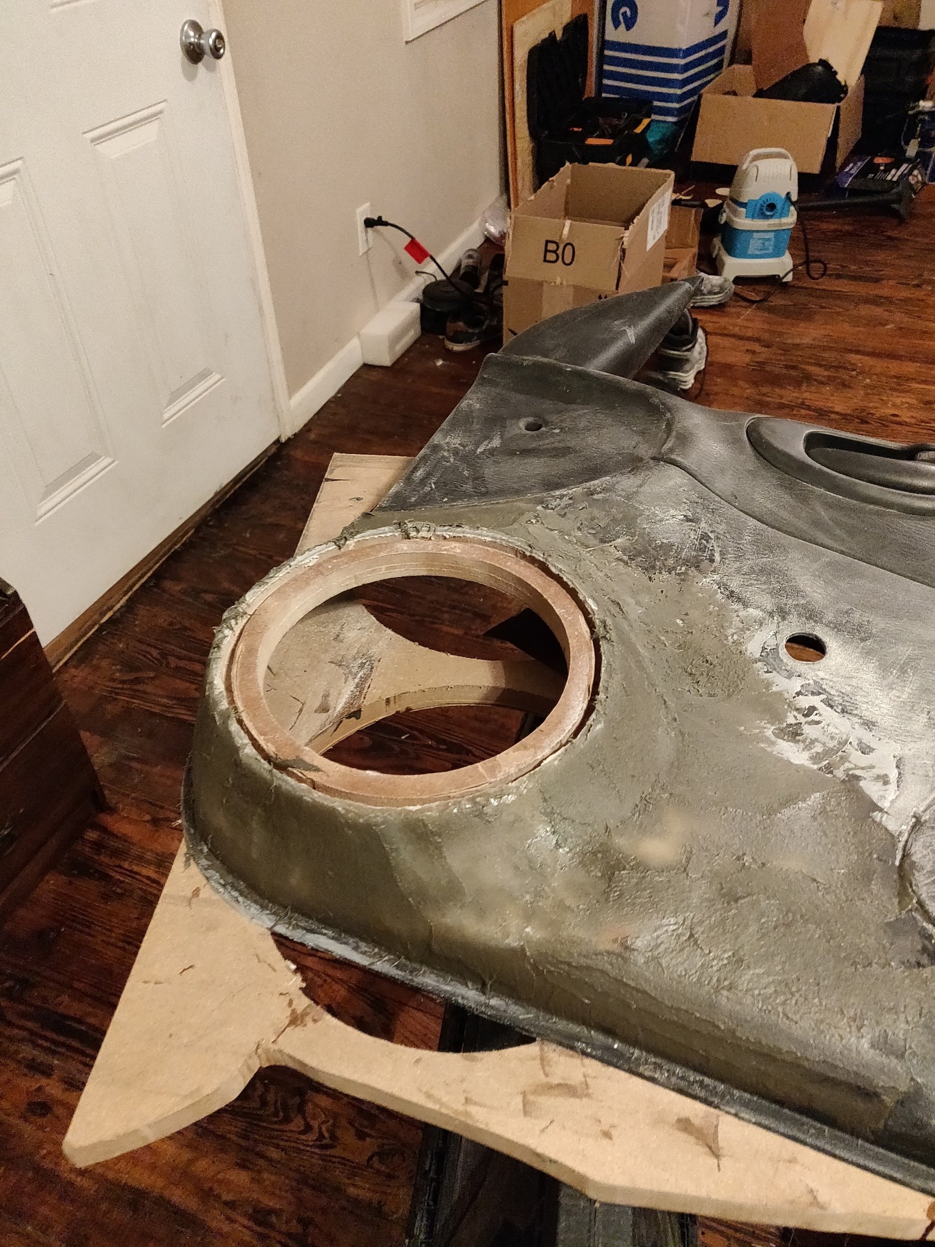

I'm in the middle of the glass work now and I'm finding it challenging with a busy work schedule, but it'll get done eventually.
I'm glassing my card to hold a ring that a grille will snap into.

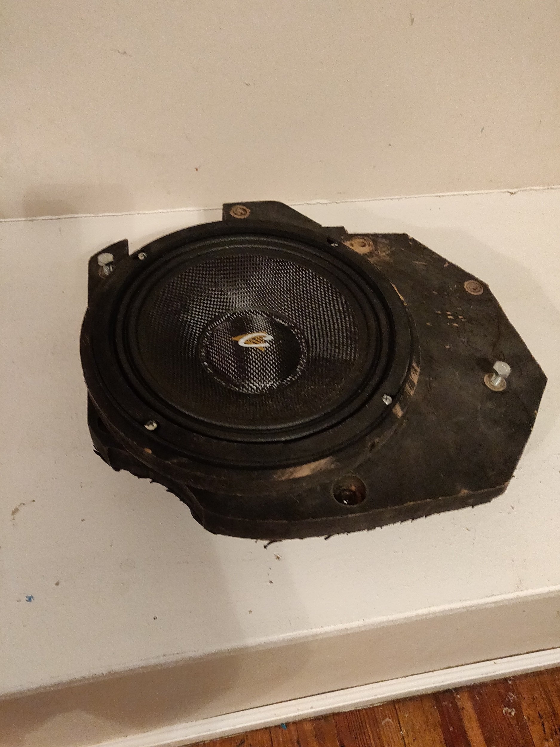

This is the baffle for it. It will get sprayed with bedliner before the final install.

I'm glassing my card to hold a ring that a grille will snap into.View attachment 19990
This is the baffle for it. It will get sprayed with bedliner before the final install.View attachment 19993
So assuming that baffle will bolt onto the door panel from the back side?

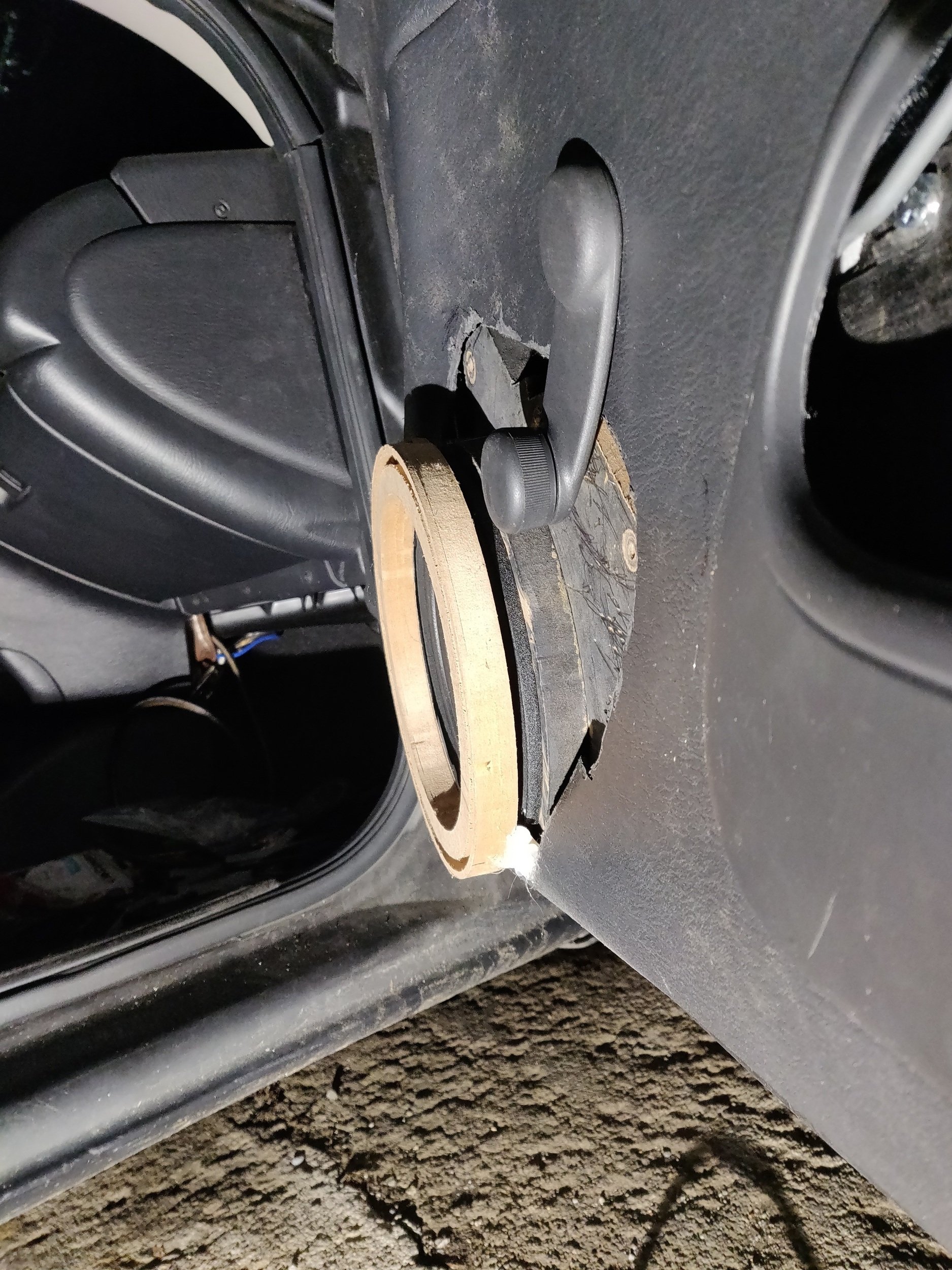

My thought was to remake the door card so that I can mount a grille in the card that will be less than half inch from speaker so I can put a foam ring around the speaker... then the sound is going straight through the grille. This is a pic of me finding the right depth for the "grille ring". I just use a hot glue gun to temporarily hold the ring where I want it.
19995
The bolts in my baffle just thread through the sheet metal.
I lost my phone that had most of my pics but I might be able to get a couple more for you later.
