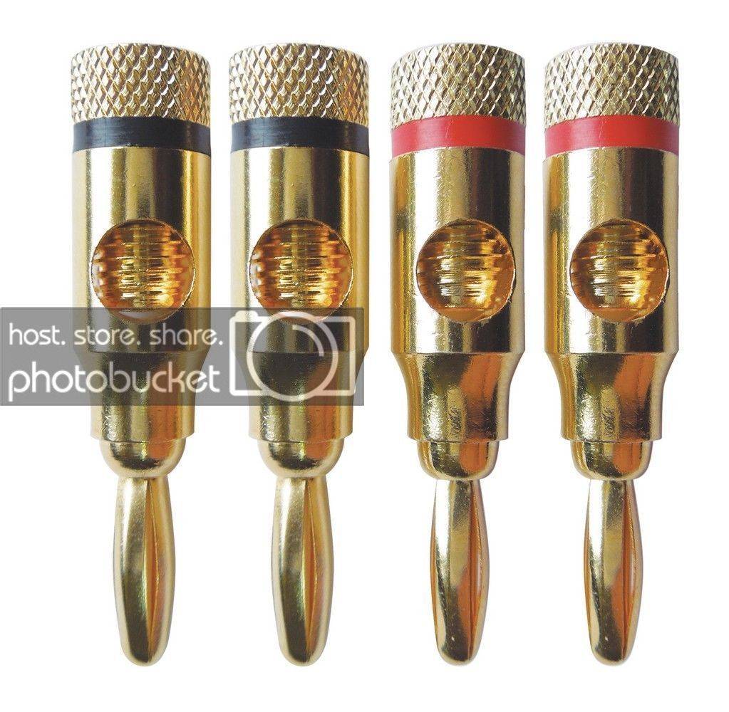

Speaker wires from amp connected to one pair. The other pair inserted into the speakers connectors with jumper wires going to the second coil. Now plug the signal wires into the plugs connected to the first coil piggyback style. best of all, 8awg all around
