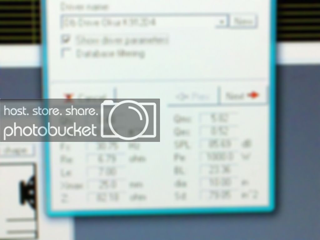

klippel accurate
Fs 28
Qts 0.47
Vas 1.6
Sens 85.6
xmax is 25mm one way linear
box suggestions 1.7 cubes @32hz - 2.2 cubes @27
