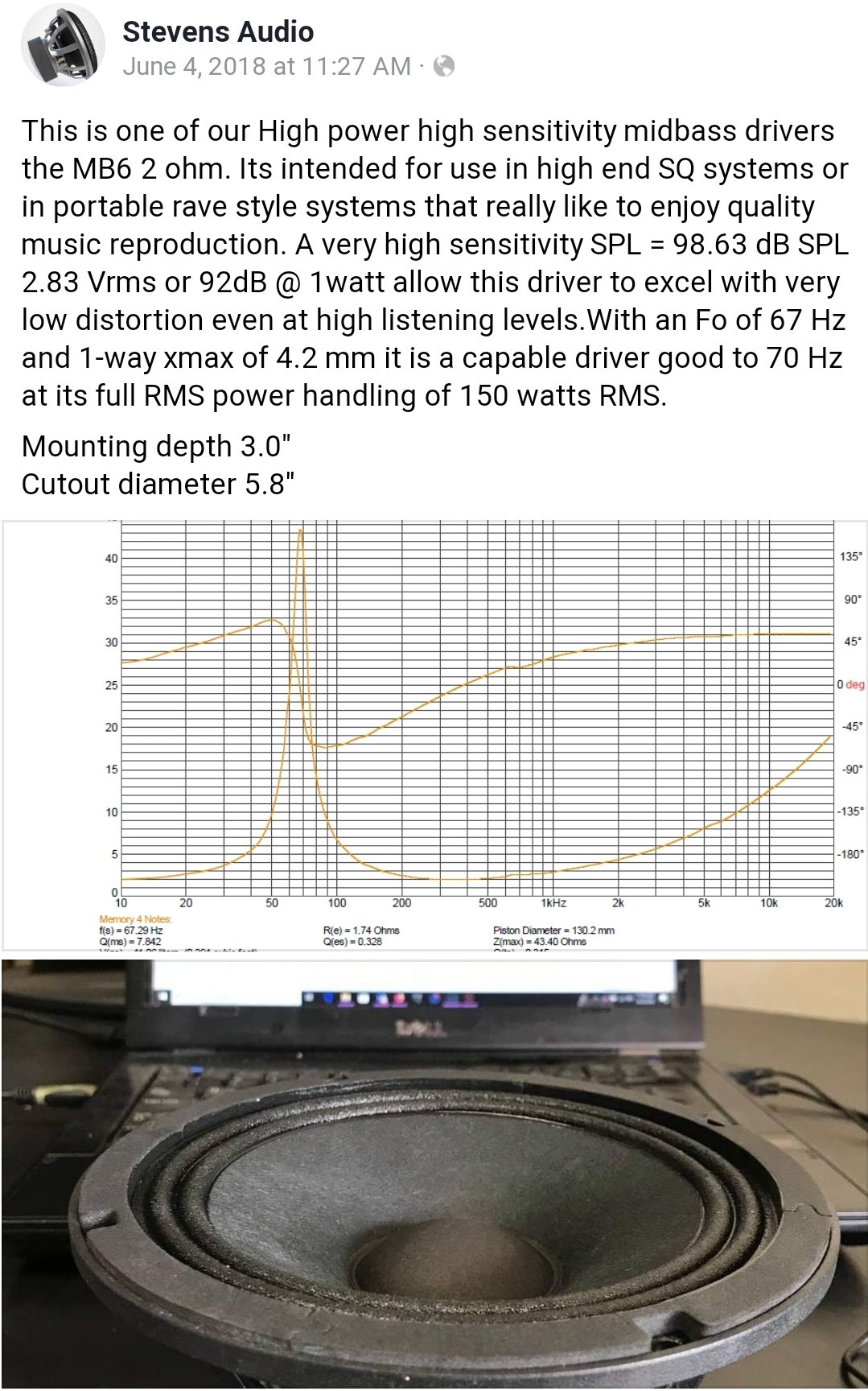

This amp allows you to go active. I'd do this:
Sheesh; I can give it a try. The design is very unassuming, and all the specs are amazing for $32. Two questions though: Is it 80watts rms or max? and is it $32 for one?(completely fine since it's still cheaper than my current speakers).

Take a look at these!
