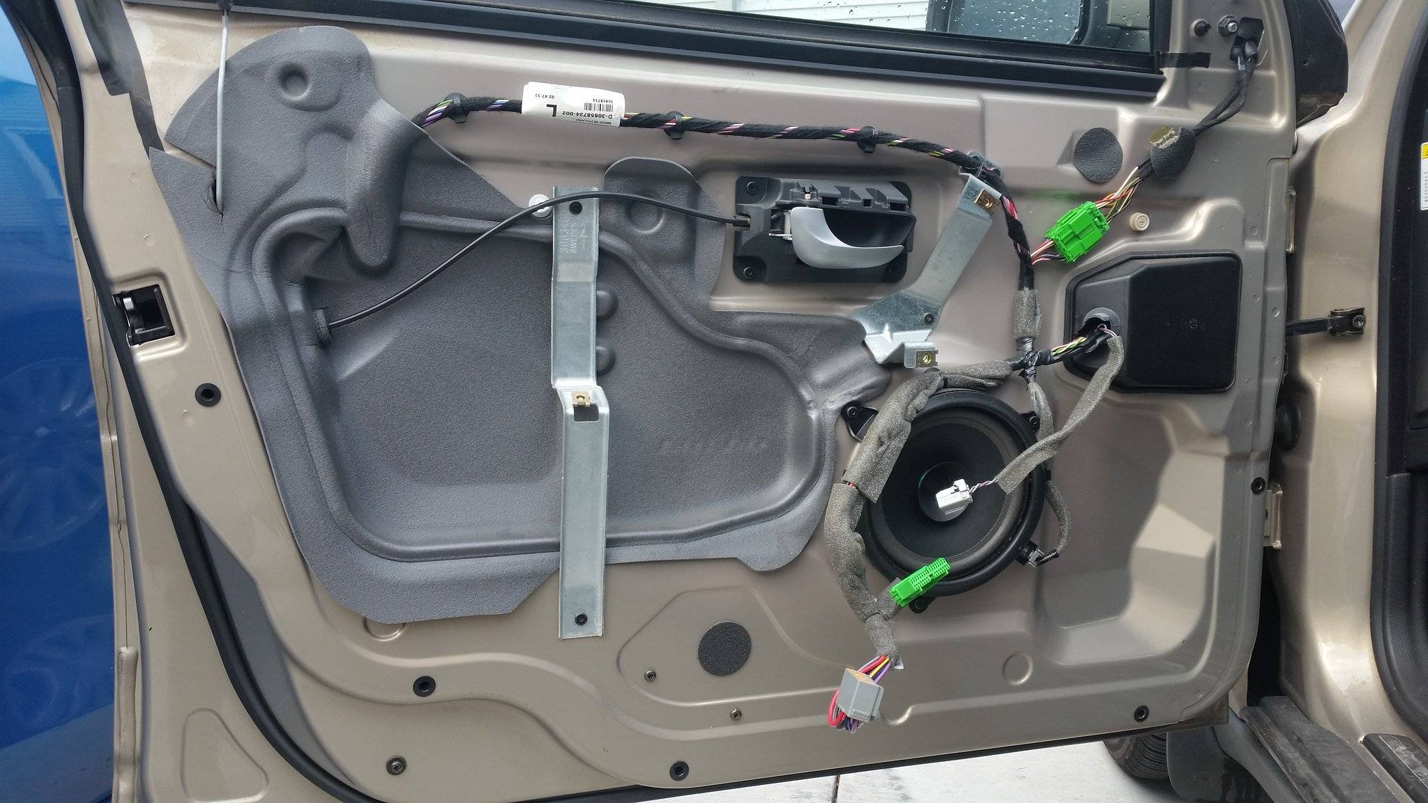

Stock Door & Stock Speaker

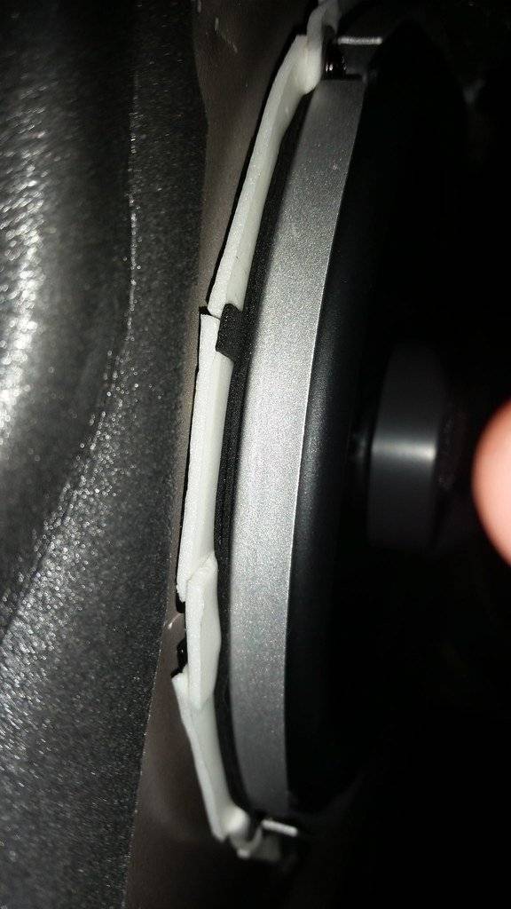

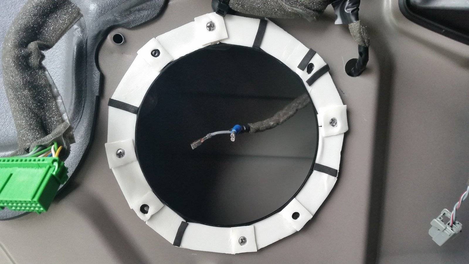

Modified Door & Drilled-In Bracket w/ Foam Tape
Speaker Mounted In With The Foam Backing Tape
Here's my main question. I'm putting a speaker on my door unknowing of how to correctly and professionally mount it. I've read that you should seal it from behind, and from the front to the door panel. I've already made good drill holes, and I've bought self-drilling screws that have worked great in holding the speaker mount in place. The speaker sits great on the mount as well. I just want to know all the itty gritty information regarding how to mount a speaker to a door for best performance. Is what I have done so far a good thing? What should I be doing this for, reducing vibrating, sealing off air leaks, or both? I really appreciate your guys' help, and I'm looking forward to some solid advice! God bless.

Okay, thank you. Since I've already created this thread, I'm having issues with my JBL GTO638's making this weird distortion/flapping sound at around ~80-100Hz. I can replicate the annoying speaker sound in this song -> http://grooveshark.com/s/Valley+Of+The+Shadows/35wlvX?src=5. The bass doesn't sound proper at that range with these new speakers, yet with my old factory ones the specified bass frequency didn't sound so bad. The sound being made is like the speakers are slightly flapping and making this weird physical noise from the cone, outside of the audio that should be produced. The mount is very solid, and I'm 100% positive the sound is coming from the speaker and nowhere else from the door. //content.invisioncic.com/y282845/emoticons/confused.gif.e820e0216602db4765798ac39d28caa9.gif
PS: I should add that frequencies lower than ~80Hz-100Hz sound pretty decent, as I'm running my setup without a sub. I'm just going to mount two 8" TS-M800PRO's in the back where they should fit fine in the stock rear deck housing. It's just that those higher bass notes can't be produced well by the speakers!
