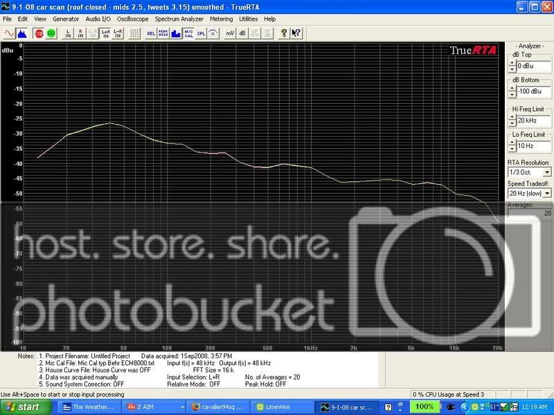

an under lap doesn't mean there is a gap or dip in frequency response in that area.
here is some proof:
the mids are crossed at 2.5k, and the tweets are crossed at 3.15k. also i have an underlap between my sub and mids too and there isn't a dip in frequency response there either.
he could under lap them. keep the tweets at 3.2 and run the mids at 2.5. i have a bigger gap than that and mine sounds right.
Tis true. Gotta remember a xover slope is NOT a brick wall. I run underlapped also; mids LPF 2.5 @ 12dB and tweeters HPF 3.15 @ 18dB and it sounds/blends very well. I've even tried the tweets at 4k and it sounded good...

yup, i have my mids at 2.5k/12db and the tweets at 4k/12db at the moment. i'm sure the rta will show a very minor dip in the middle but thats what sounds best to me.
