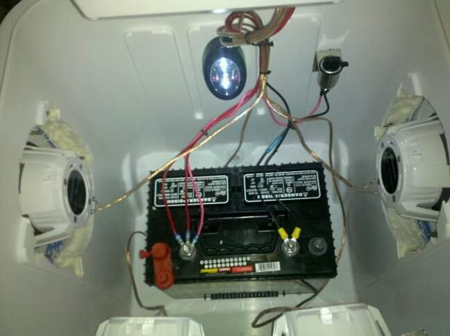

It's not an expensive amp or subwoofer.
The amp is a hifonics 600.5 marine and the sub is 8" fosgate marine. I use a deep cycle 12 volt marine battery to power it. Attached are pictures of my current setup.

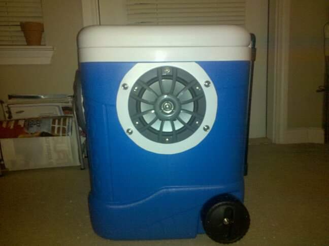

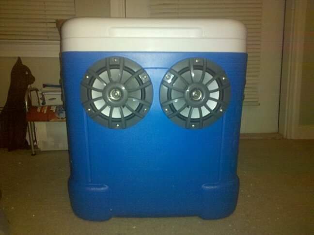

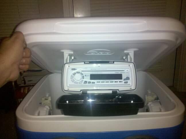

The two way speakers are Kenwood Marine 6 and 1/2. Everything has to be marine grade just in case it gets splashed.

With my current setup it will easily go all day without having to charge it. The campsites we stay at have power so I carry a charger with me and usually charge it in the evenings. The floats are usually around 4 to 5 hours and even with the extra power drain I think it will have no problem lasting that long. I'll just have to charge it more often.
