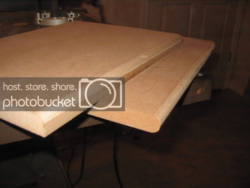

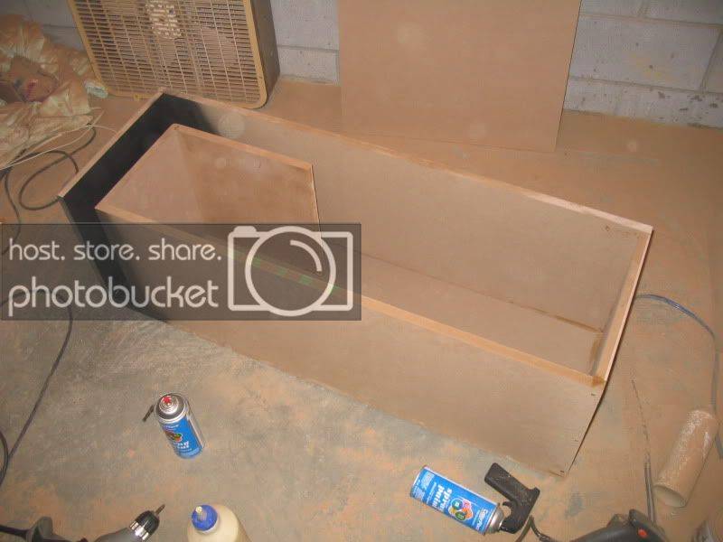

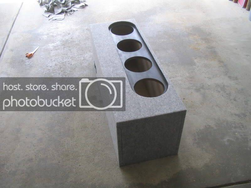

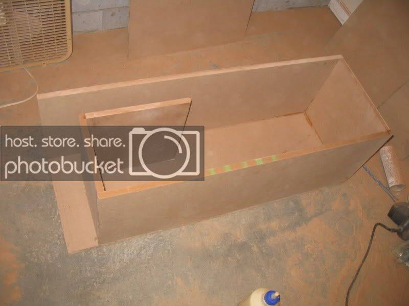

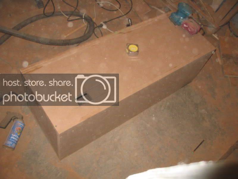

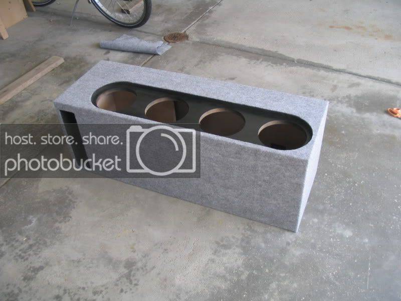

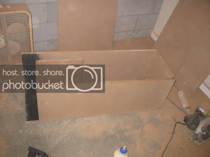

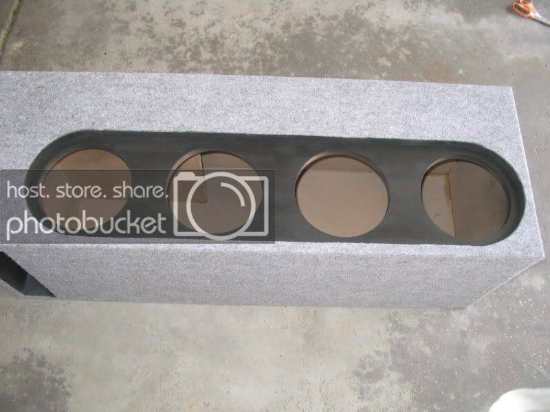

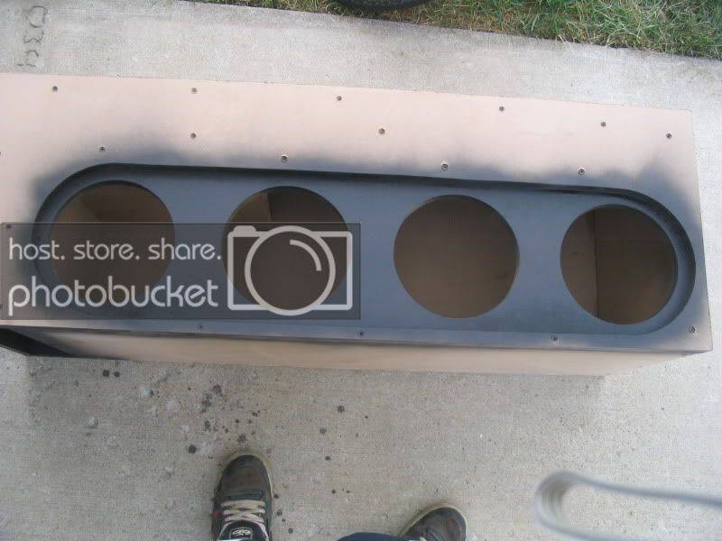

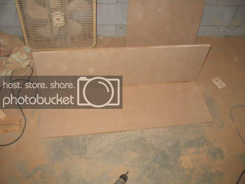

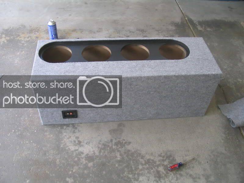

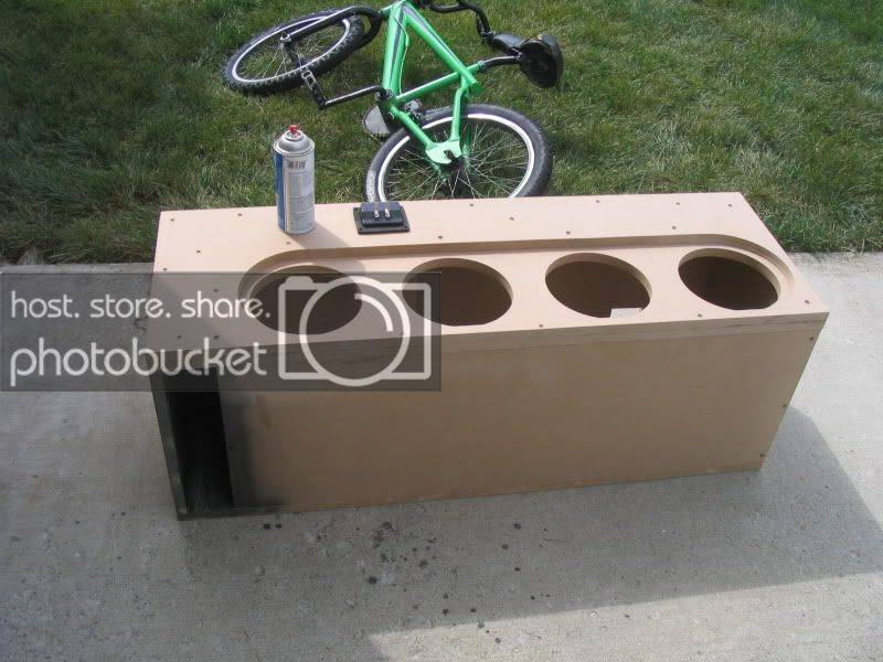

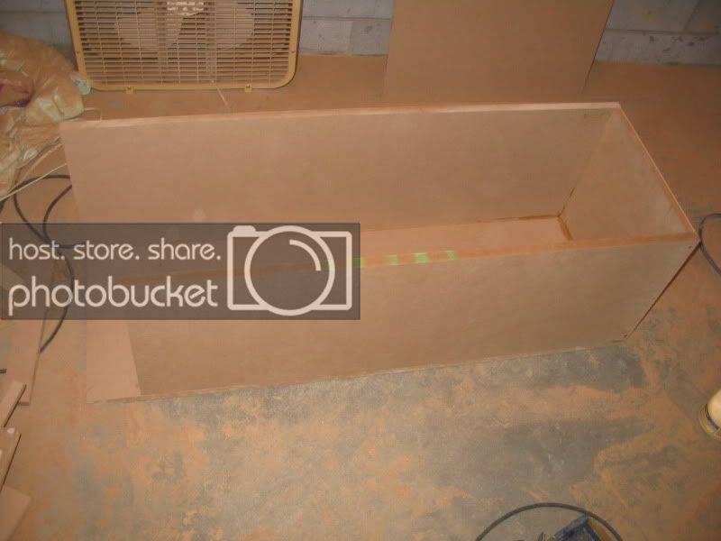

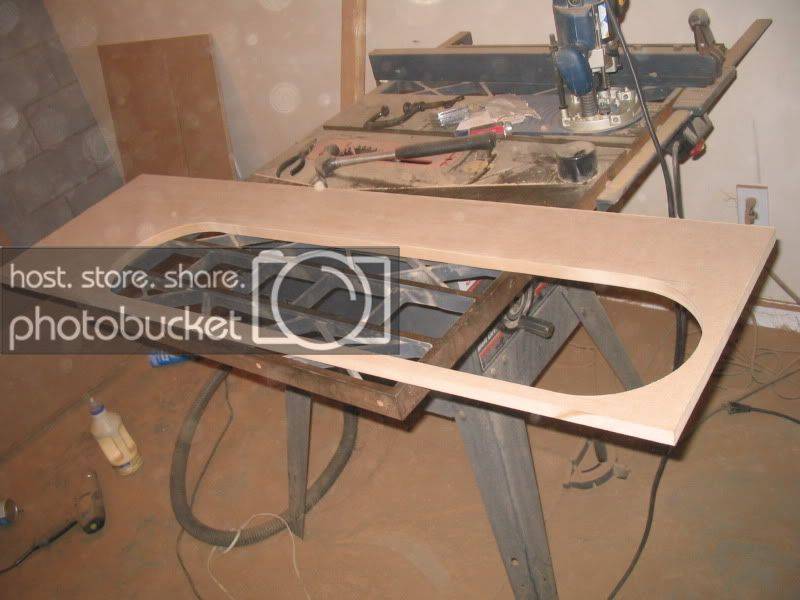

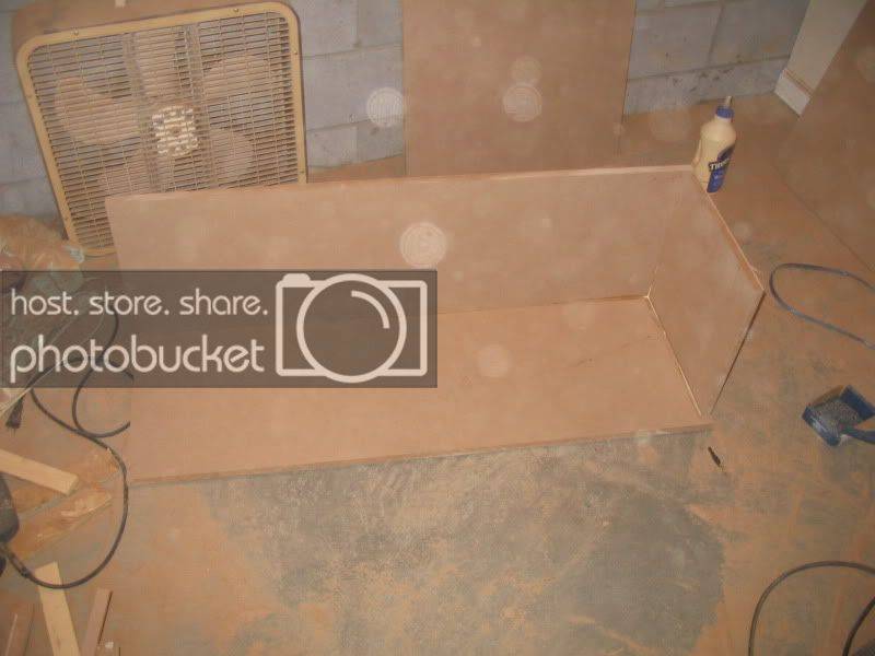

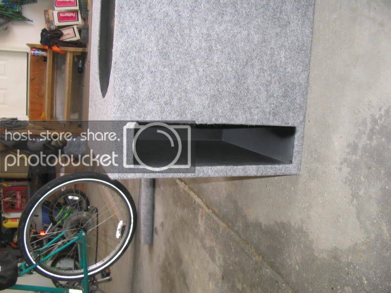

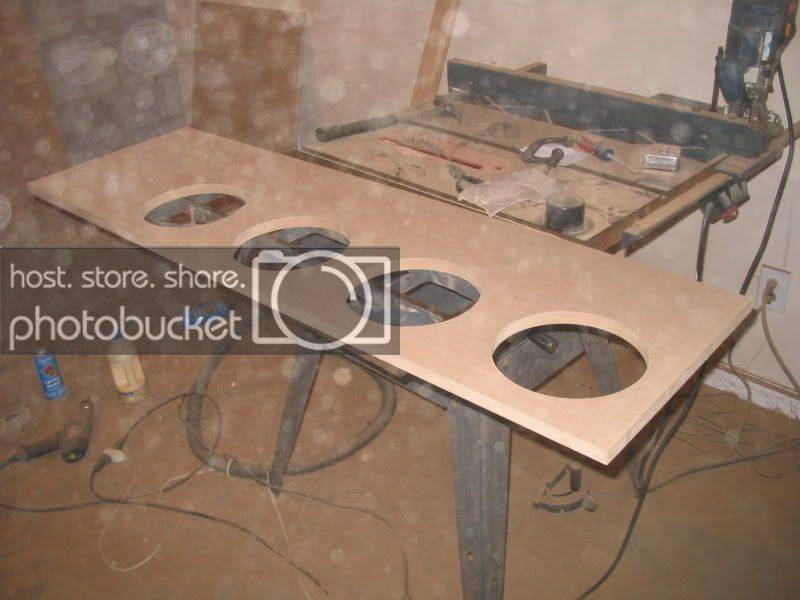

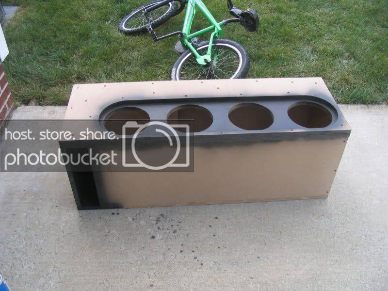

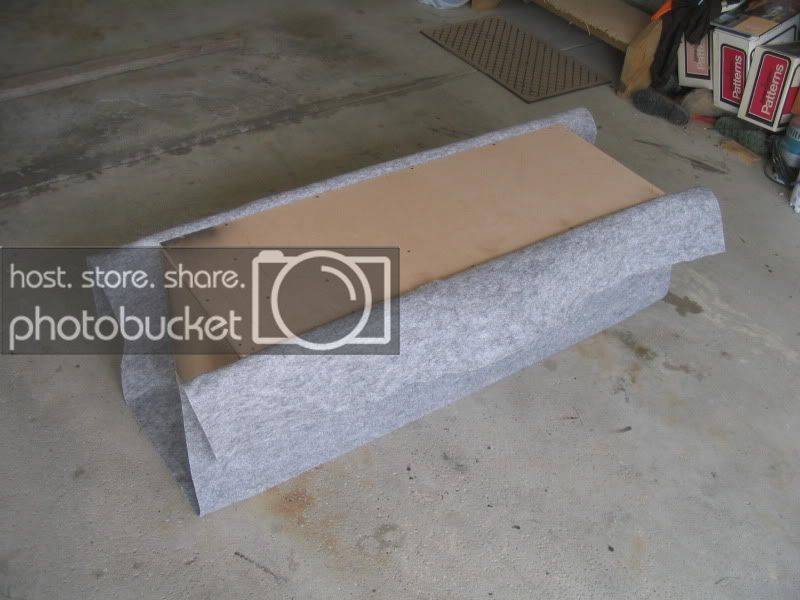

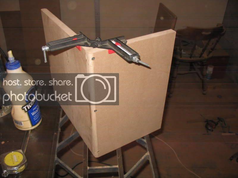

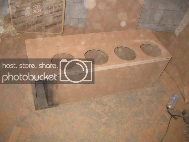

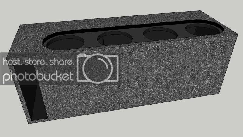

ok this enclosure comes to 3.2 cubic feet after all displacement tuned to 32hz with 44in^2 of port area. its for 4 sundown sa8s. here is the design...
