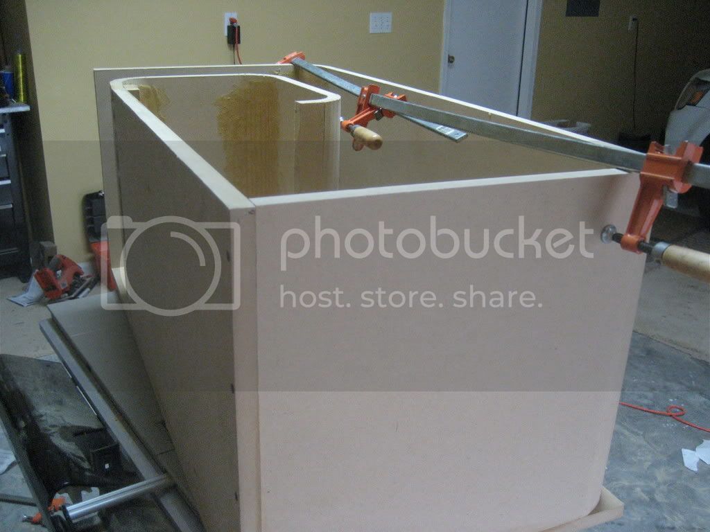

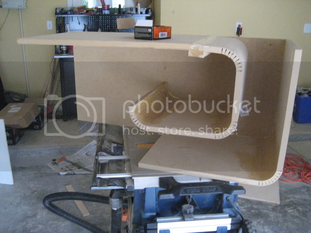

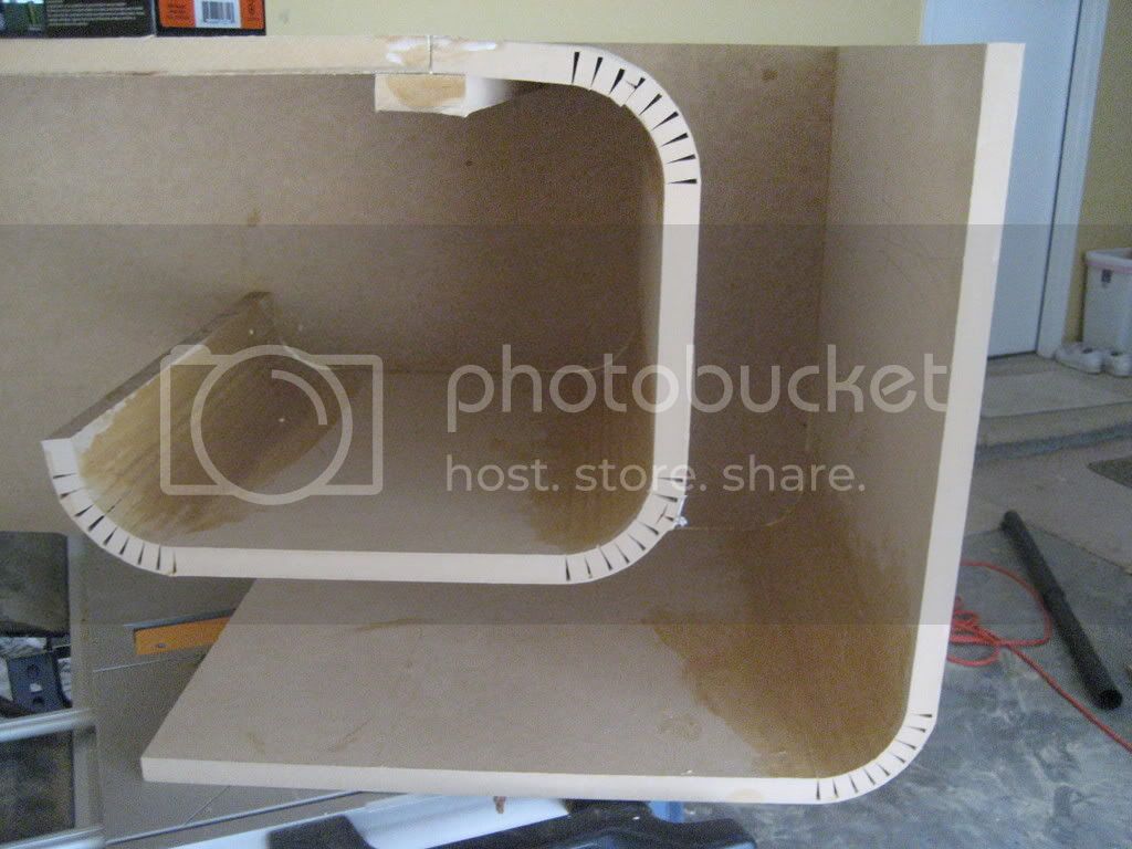

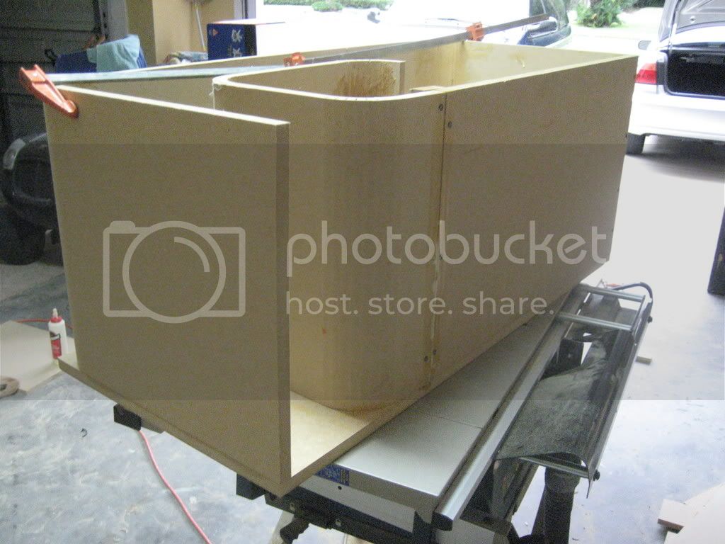

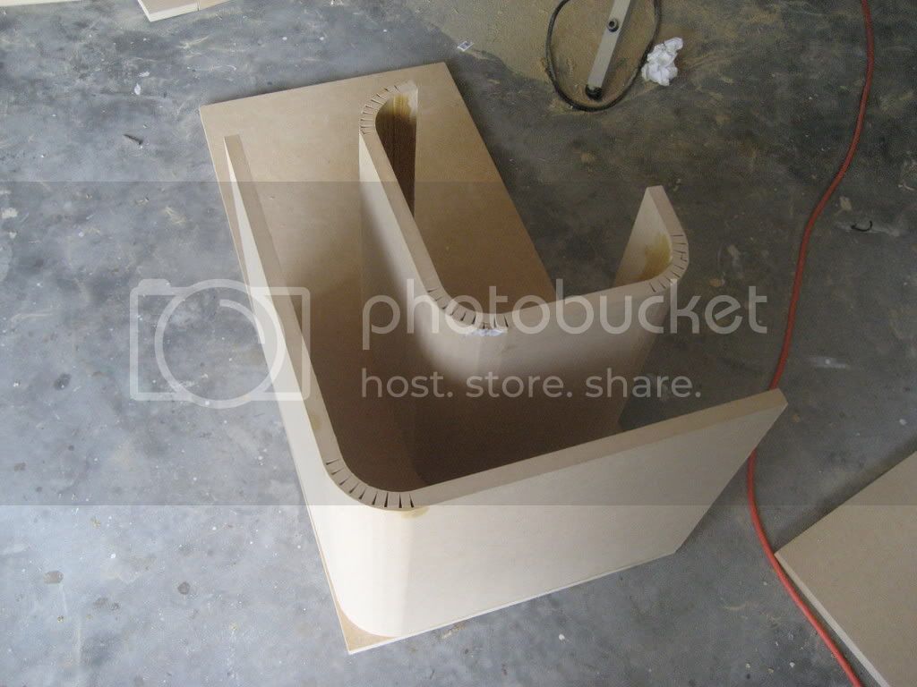

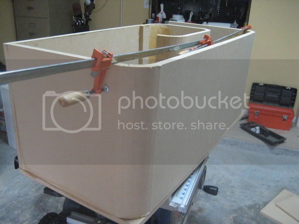

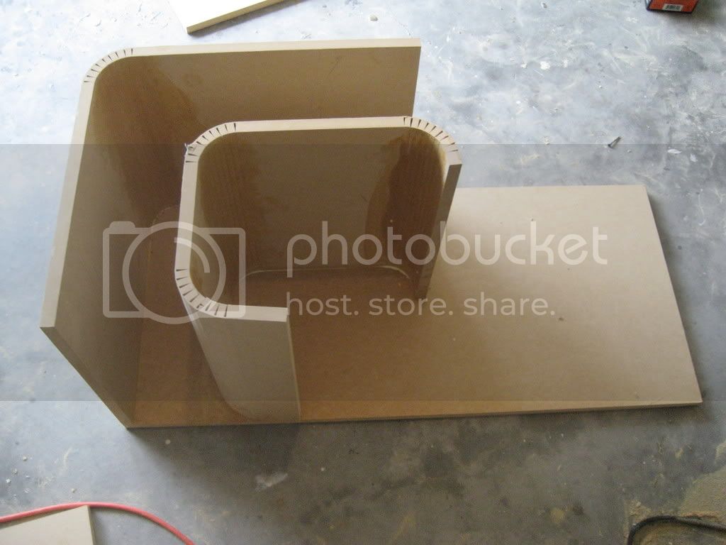

4.5cf @ 40hz, kerfed! Worklog with lots of pics!
lmao... i was just out cutting, and I think I cut the power off to the neighborhood. The piece of wood got sideways right at the end and stalled the blade, and then the power went out.
More pics in a little while.

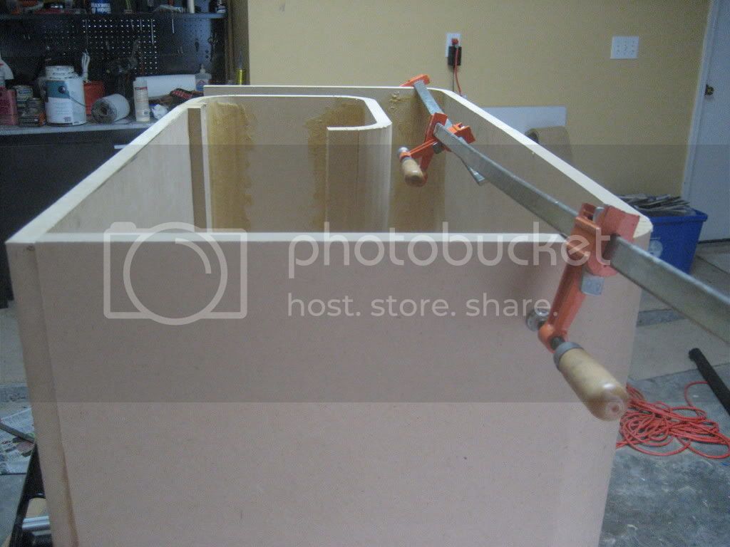

only huge flaw is the joint in the back //content.invisioncic.com/y282845/emoticons/frown.gif.a3531fa0534503350665a1e957861287.gif It ought to be okay... i put lots of glue on it, and the fact that it's between the top and bottom pieces helps, too.
Don't worry bout that joint on the front. double baffle will fix it
its comming along very nice. I can see some things I'd do different but I bet you are thinking the same thing. Definately doing a great job on it and maybe you can teach me how when I help you do your kicks!
