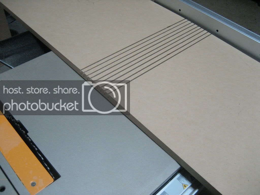

Well, my AQ HD3 needs a home, and I've always wanted to try to make a box that is kerfed. So, this is the perfect opportunity.

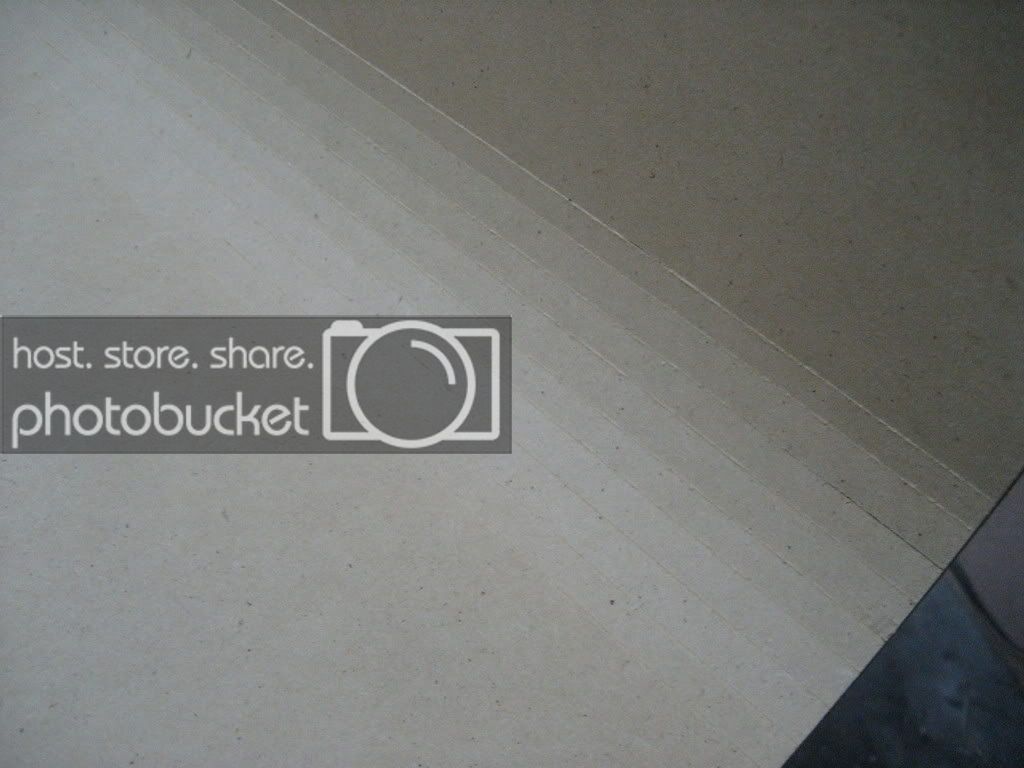

I made the cuts .5" apart

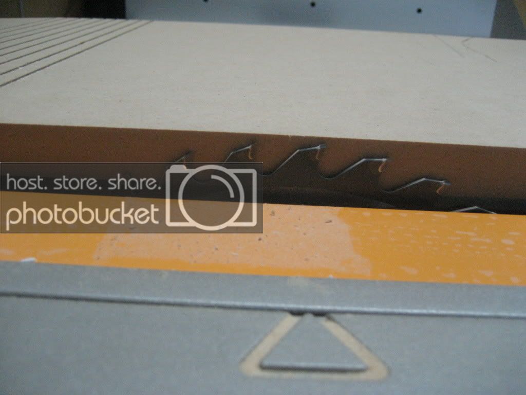

Saw blade set almost as deep as the wood. Not too deep, though!
Test bend
Lookin good, and nothing is broken

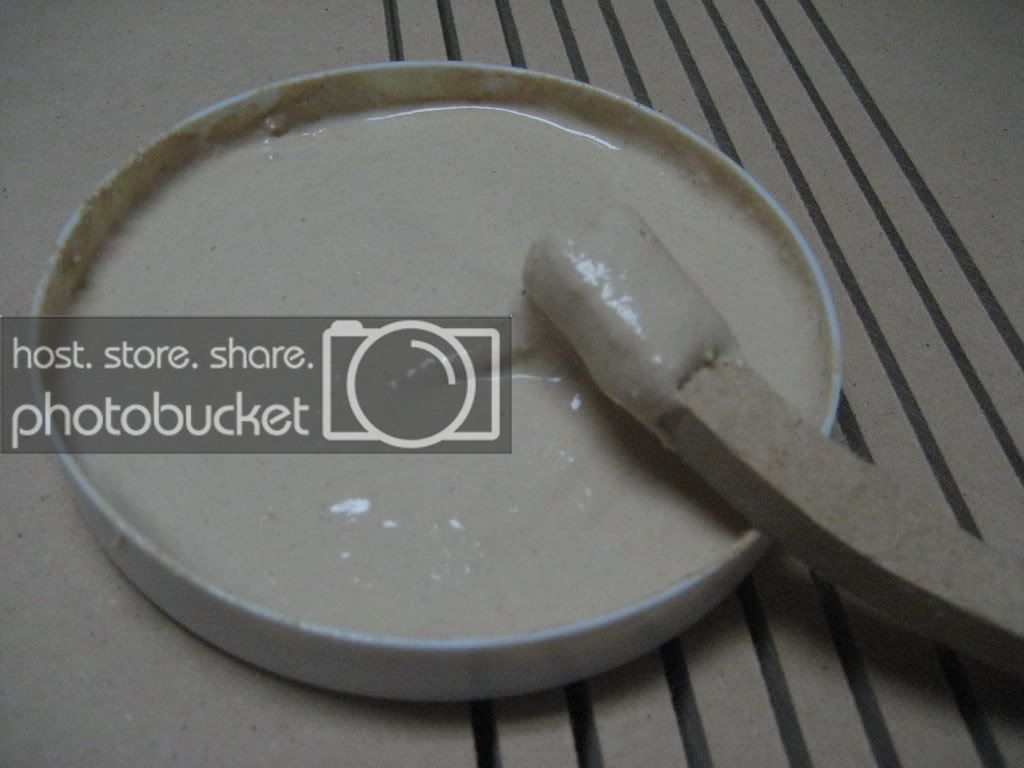

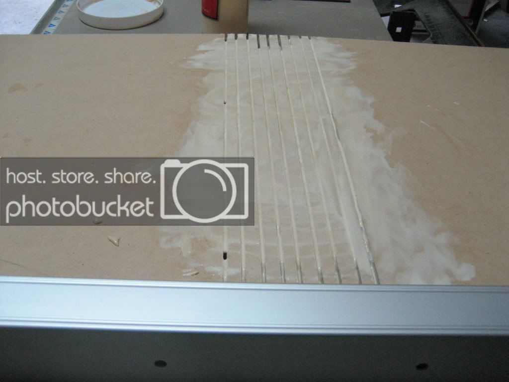

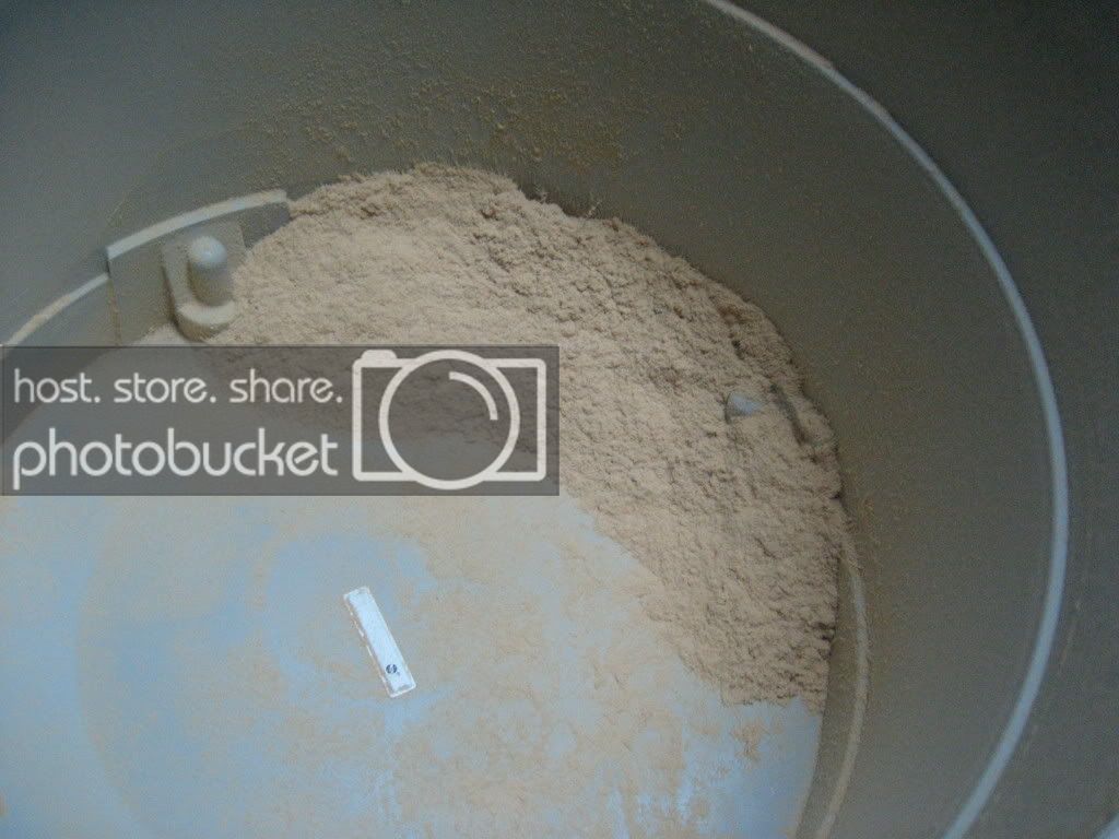

Keep your sawdust!
Yummy!
Sawdust + Titebond = strong. Thank you, mobieous for the suggestion!

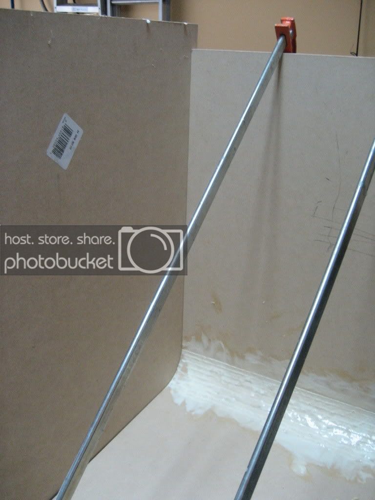

Skeet skeet!

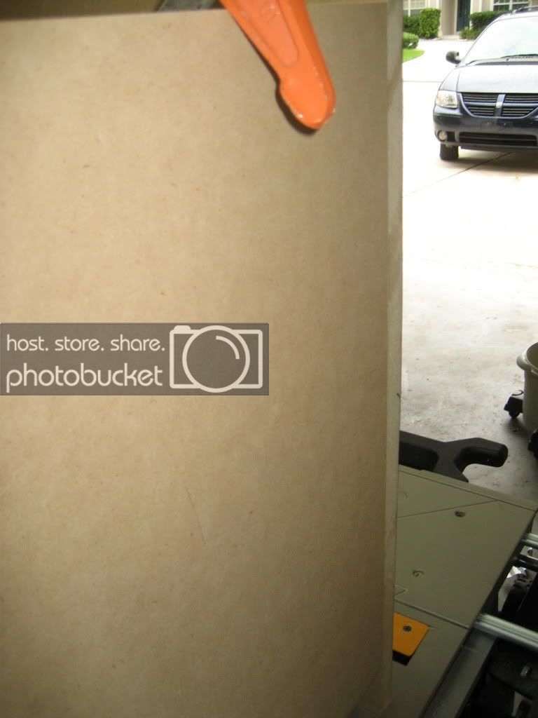

Piece of MDF next to it to ensure a 90 degree bend
It might not be a government-approved method of getting 90 degrees, but it works
the .5" cuts are for kerfing or bending the wood to get a flare on the box, table saws are a lot easier to make cuts but I still find myself using my circular and guide to make larger cuts.
What is the purpose of those 1/2 inch cuts. And how much better is a table saw over a hand held circular saw...
The cuts are relief cuts. They enable the wood to bend.
And the difference between a table saw and a circular saw is like the difference between riding a bike or a ferrari on the autobahn.
As the page was still loading and all I could see was the very first picture I wondered the same thing.
Then I looked at the rest of the thread and saw the bend creating a 90* angle but with a smoothly curved interior/
//content.invisioncic.com/y282845/emoticons/read.gif.ff512c499c00ed3faae9a20f4b088b29.gif and look at the pics and you wouldn't have to ask!

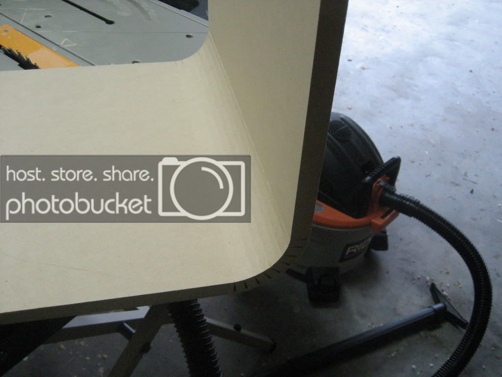

I plan on making a second piece exactly like this one, and I will put them together to form the bottom and the sides of the box. Then, I will cut them to the correct length, and glue/screw them down to one side of the box. Then, I will make a kerfed port piece
This is the shape I'm going for:
