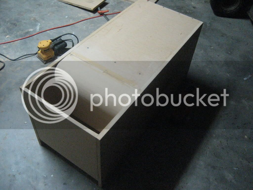

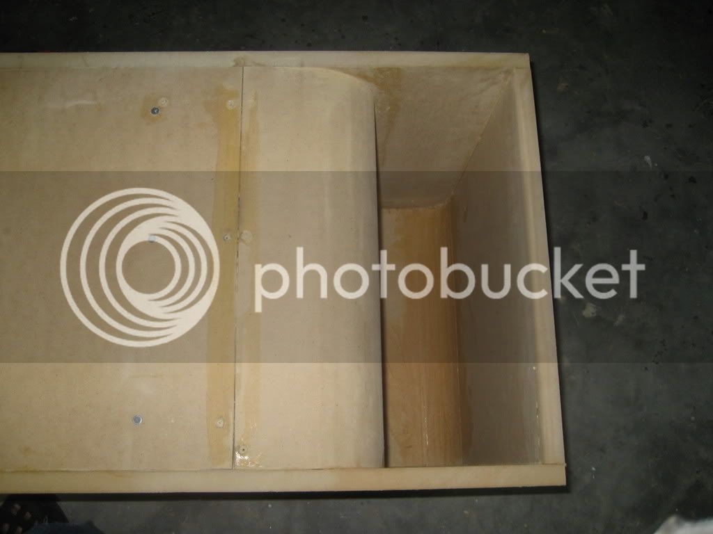

is there anything to adjust or factor in for kerfing when designing a ported box? if i had a specific frequency in mind for a slot port..what(if anything) do i have to change mathmatically to keep the box at that frequency?
with the curves instead of the 90 degree angles..how would you go about designing the box to a certain freq?
Draw it and then measure down the center.
That's what I did with mine and I accounted for the flare giving a little more port area and I was pretty **** close. It looks to be tuned around 30hz and I was shooting for 29hz when It was completed.
