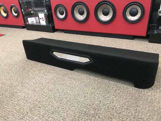

E10s are listed at 0.5ft^3, my box is 2.43ft^3 with 2lbs of polyfill, you’re saying it’s being suffocated? ? 2nd when I built my box for 15s n it was like 3-4”, I was told it should be 6-7” for port to load off of which is why stang re did the sketch for Sa12s I then got my 7” clearance n everything was good. As for his box I didn’t build his box the shop did n it was a 2x2 port no idea the length, the bass was deeper with a towel plugged in the port.

the lack of fullness, lows and accuracy was from a poorly designed box. Yes those sundowns are ported only subs.
thats way too small of a port. Its just a leaky sealed box at that point, not really a proper ported box. I have to agree with hertz mafia on this one

He went with 2 JL W6 12s ported in a console, took out the single side seat in the rear. that’s only 600w rms each, I’d pick the Sa12s like I had before n fed em 1200w each might not sound as good but way more spl than the w6s. JL is way overpriced
wheres the port? w6 good sub idk about that box though...
Port is at the bottom of the box, side port facing the door. I was inside n when he pulled up I felt the floor of the house vibrating. Yes the sq beats the Sa12s but his pioneer head unit on 30 is to my pioneer head unit on 17-20 n I still got 10 more to go. Looks like 3 cubes to me, I wouldn’t spend $2000 on jl door speakers, w6s, box, setup.
