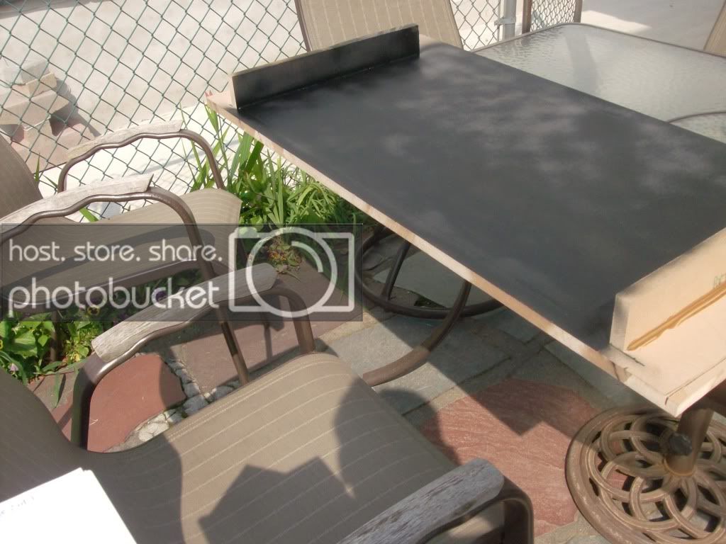

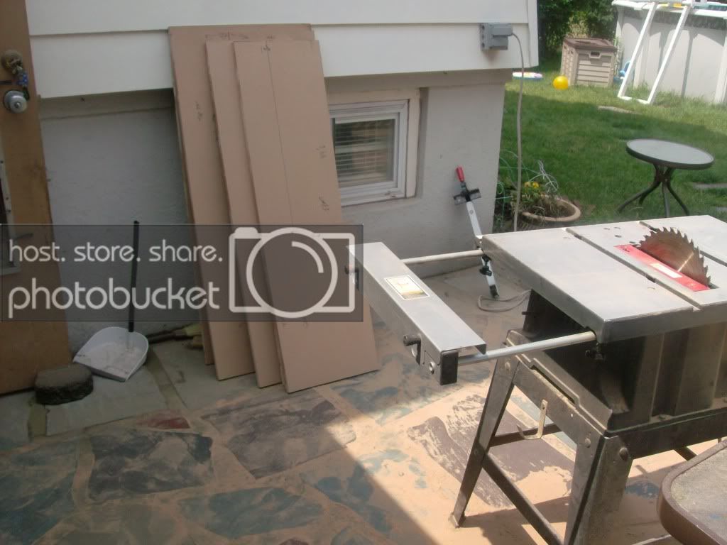

The box was designed by Dappa5(thanx a million- I would never have grown the balls to try this on my own) this was my first ported box. I have made a few sealed boxes but nothing of this magnitude.
The box is 7 Ft^3 @42 Hz. I have 4 kicker cvx's for now they will be running off a Rockford t10001bd... when funds become available I will be feeding them more power.On to the pics:

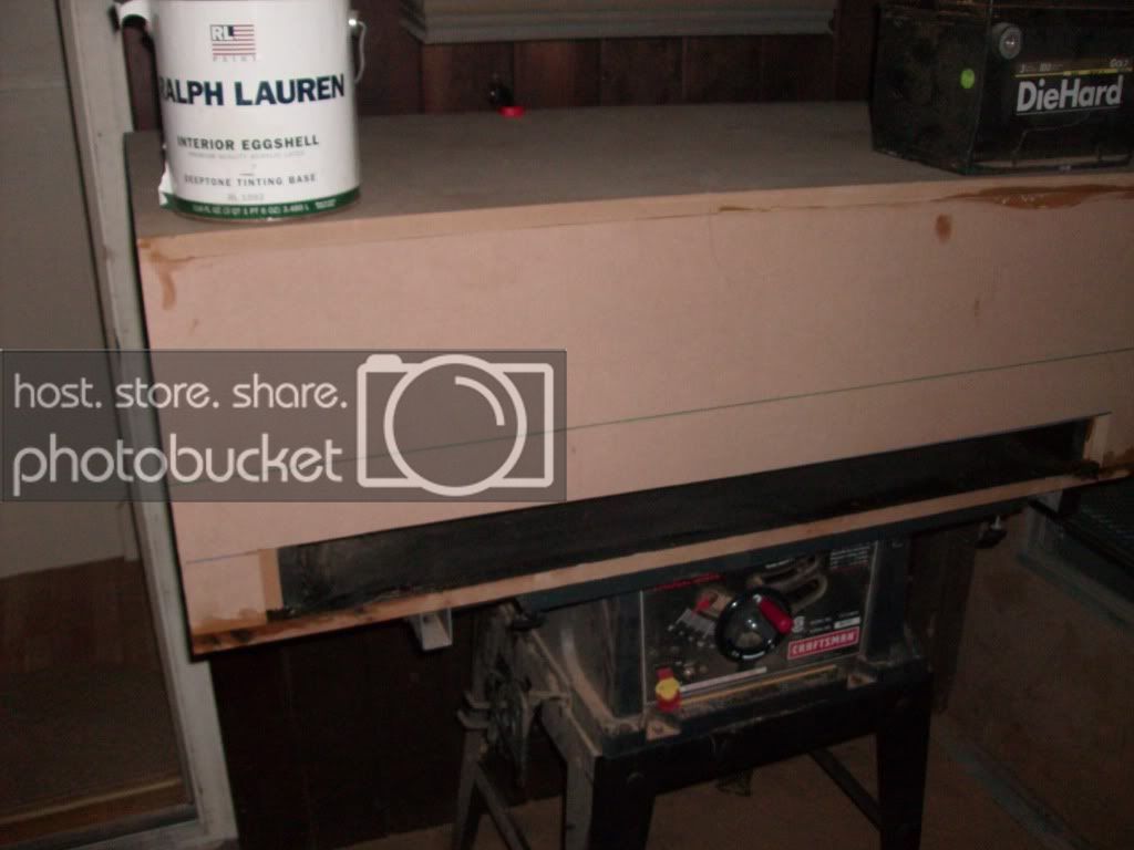

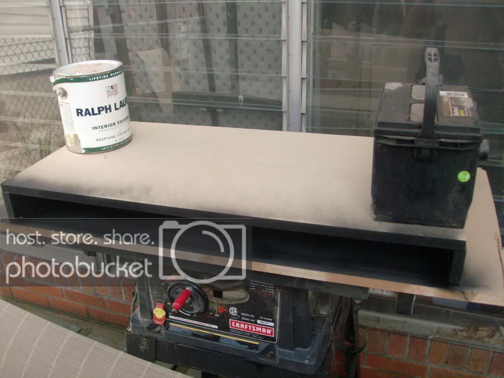

Before you all critisize the paint can( which is full) and the battery (which is good) I do have clamps:D

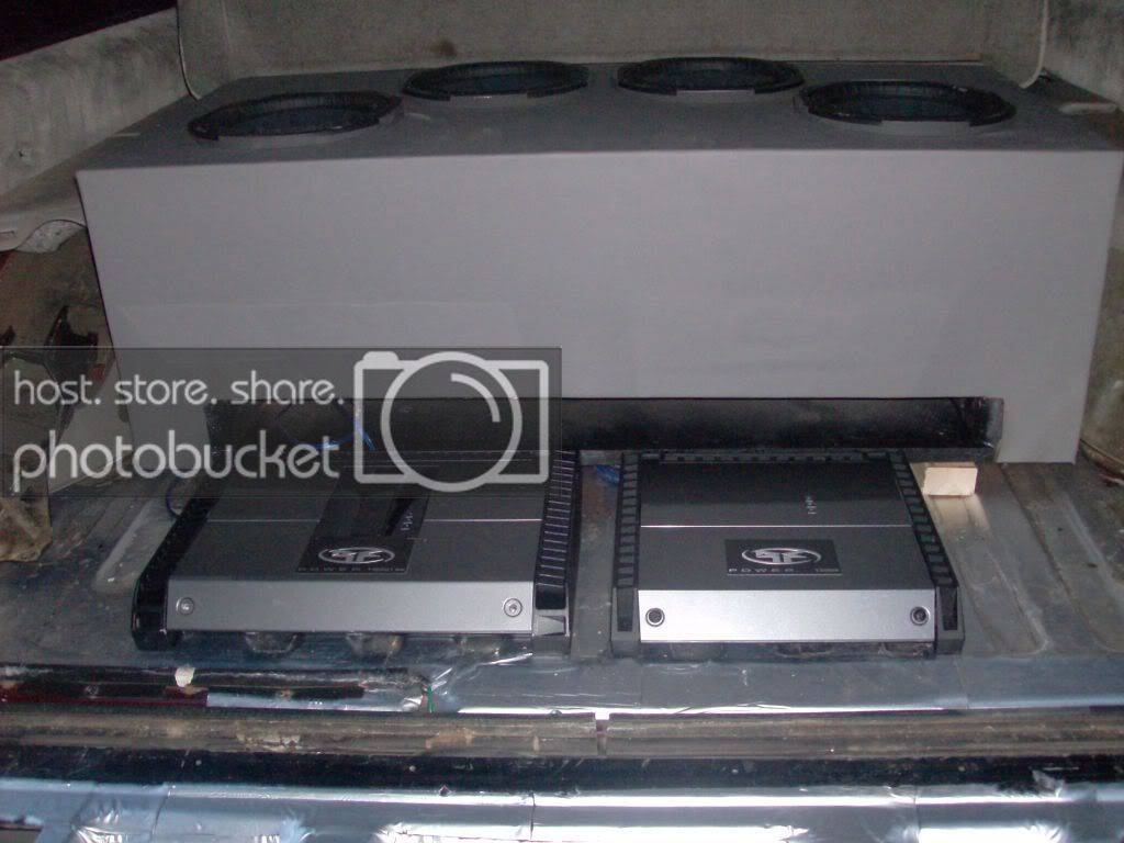

This build is going super slow as I find it hard to make time to work on this. I did manage to run 1/0 guage from front to rear today along with the rca's and a run of 4 gauge. I also wrapped the box in gray vinyl. First time using it, not too bad. I still have to raise the box about 1/2 inch more so I can make a trim piece to cover the ampsand it can be somewhat flush with the bottom of the box.. that is if i decide to keep the amps there.
Hopefully i get to install the Ho alt. I got from powermaster
nice build! i would keep the amps there, looks good there....plus the port will blow air on them to keep em cool:p: kinda iffy on the tunage...might sound muddy on the lows....also is that 42hz tune before or after displacement...cuz if before when subs and bracing in volume goes down a tad and tuning goes up.
