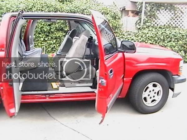

4 10"s under the rear seat, Silverado ext cab
dang man, that's crazy... got measurements of the box? I'm about to do 2 12"s downfire in mine. Right now I've just got a single ported BL 10" with ~1300 watts.

You can downfire the 2 12"s pretty easy, a 2" lift is prob needed but you will need to figure out how deep the subs are. I pulled 2 12" w6v2's and went to this setup.

Looks good. I did a 8" lif in my silverado. Managed to get 2 12" subs to fire forward. How did you keep your seat from tilting forward, and do your seat belts still work?
I'm also 6' 1" and could sit back there comfortable. And the box was pushed forward in that pic. It would go back about 3" but would keep shaking itself into that position.

As for the seat it stays up on its own. I also lifted the seatbelts too so they work just like they would without the lift. My box wont move because the fiberglass holds it in the knotches in the floor.
