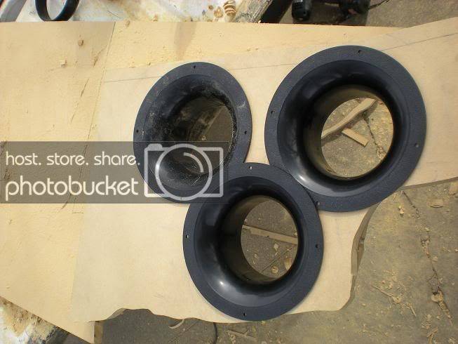

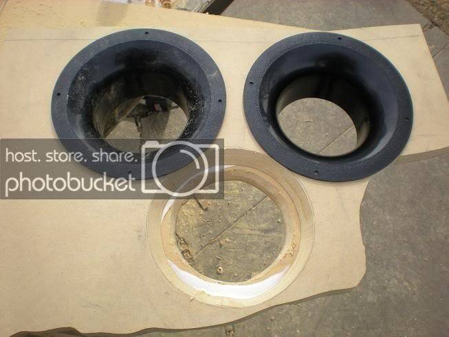

Got my port situation figured out so now I can move forward with the build. The fibergalss bottom is done and its time to cut more wood. Here is where I sit as of today.
I have roughly 5.9cf before port displacement. Ought to be plenty to get me loud. I am a little low on port area but I hope to make that up with power and side firing the port. Subs are front firing.
This is the plan but add another port. Just gives you an idea what I am doing.

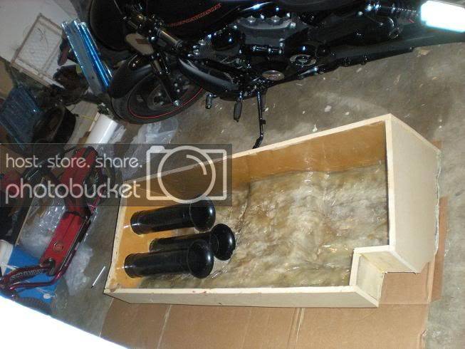

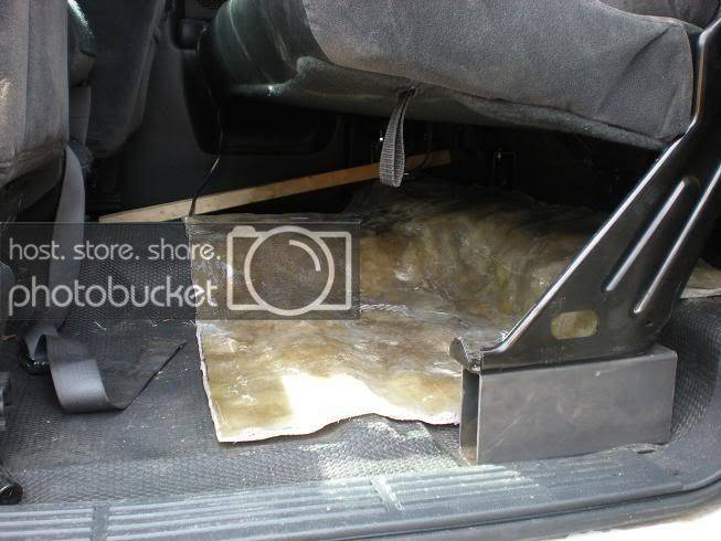

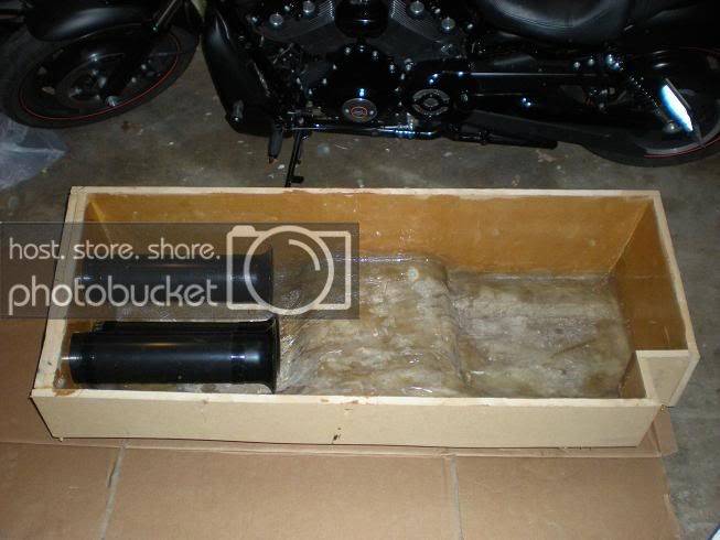

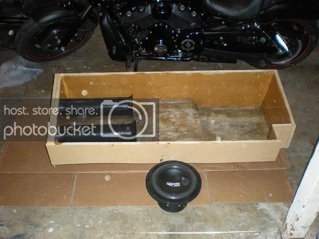

OK here we go, Got /4 of the box built. Once the fiberglass drys I can start filling it up with sand till I get my airspace. Then back to figuring out my port length. I will assume that I will be around 5.9 after DD but We will see how close my guess was. I wouldnt mind being a little less. I would like to come in colse to 5 cubes after port displacement. Here she is, dryin in the garage makin my whole house smell like resin. The ports are just kinda sittin in there. I just wanted to make sure they would clear the floor hump and hell I just wanted to look at them. lol. Not too bad.
These are from the back side of the box. I dont want to move it around too much while its wet. I have a board over the top right now with some subs and a kinetik bat weighing it down.

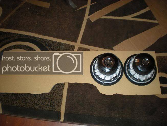

I will add another baf to the front when I am getting ready to mount the subs. I think I will recess the subs too. I have some 3/8" aluminum rod that I am using for the grill guard. I will take the rod over both subs on each side and use 2 rods per side.

This is a 4" lift on an 01 2500HD Silverado. As for the Avalanch I am not so sure he will be able to get anywhere near as much airspace as I got from mine. If I had an Av, I would just use it like a blowthrough. Hell its free. lol. And you wont have to cut a **** thing.

Well I just hit a pretty big snag. I was messing with the subs looking them over and I got 4 ohm instead of 2 ohm. Now I will be **** at a 2 ohm load in series which limits me to only like 1900rms. 4 ohms gets me 2450+. ShIt. Well atleast I didnt plan on keeping these for all that long. I want to go to some DC level 3's when I get more money to put into this truck.

Well just getting the 4 10's to fit is easy, But getting the airspace for ported was a lil tricky. I spent alot of time trying to fihure out how to get these to fit front facing and to get the ports to fit.
