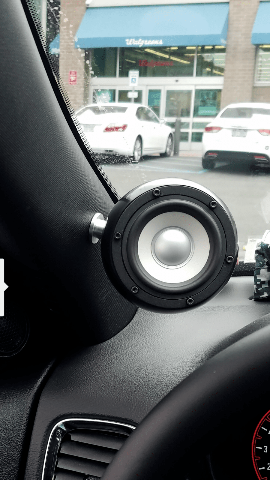

You have tweeters in the sail panels so I would just add some mids in the a-pillars. You can modify your pillars with fiber glass or buy pods.

I know a lot of people here run raw drivers with a dsp, personally though I have no experience with that so I'll let somebody else chime in there. I run the Morel Maximo Ultra 603a 3 way active, but its slightly out of your price range at $370. Sounds incredible though. Keep in mind if you do go 3 way you'll need another amp as you'll want 6 channels for the front stage. I run 2 Kicker CXA360.4. I got them at best buy for $130 each. 65 watts rms to the tweets and mids, bridged the second amp to get 180 watts rms x2 to the 6.5s.
