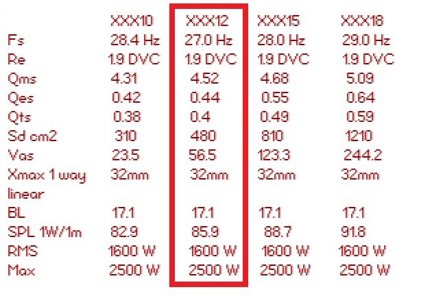

26844
These are the specs of the '04 XXX but not sure they are the same with the new basket.
