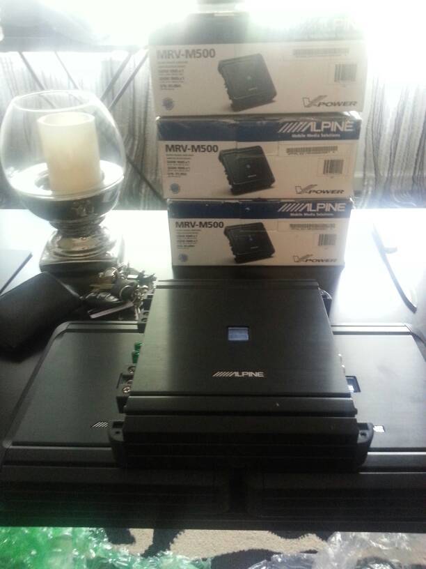

I found an awesome price on 3 Alpine MRV-M500 amps for under $200 shipped. The subs do 500w RMS each.
Should I go this route our should I be looking for a mono sub that can give me at least 1500w RMS at 2ohms?
Any suggestions, recommendations, critiques, are welcome.
You can do a 1500W rms amp for not too much more. I'm against running speakers off the HU - no point in even having after market speakers then. Used, maybe even new, you shouldn't have much trouble finding a solid 1.5kW for $300 or under.
I did end up purchasing the 3 amps and have the subs sitting in my trunk waiting to be installed. I believe I'll end up either picking up a MRV-F300(if I can find one cheap enough) or a KTP-445U.

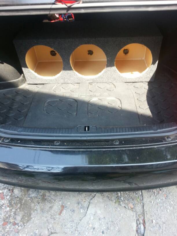

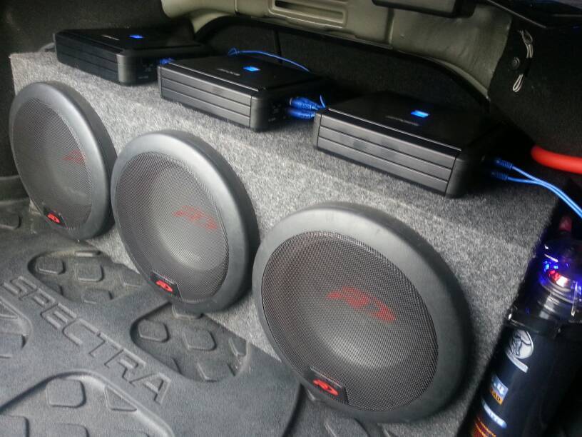

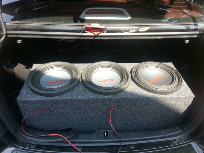

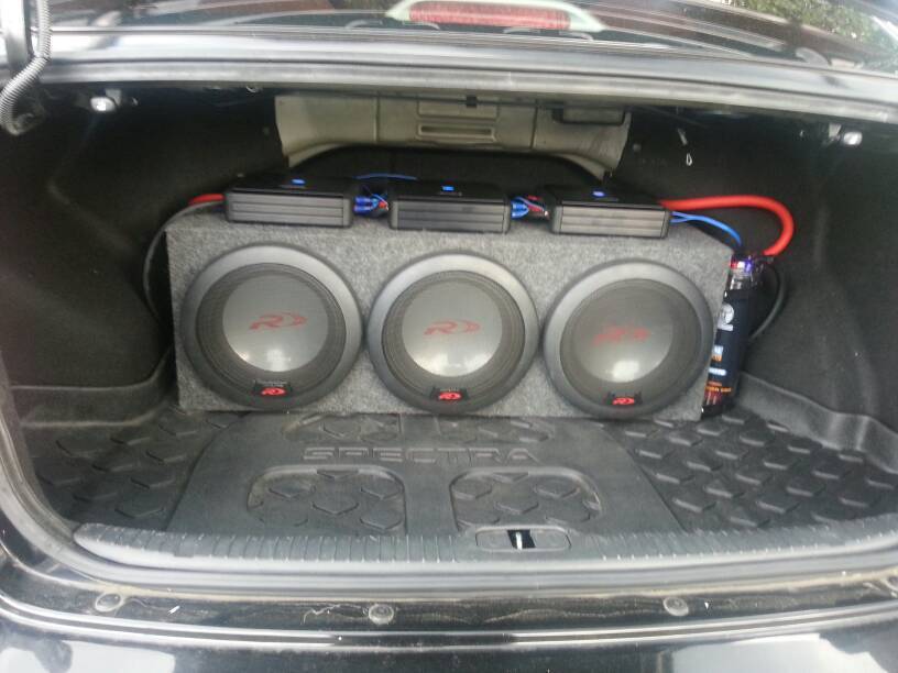

So this is what I have going on right now...
I've got 3 MRV-M500's powering 3 SWR-1042D's @2 ohms. I'm running Knu Konceptz KCA 0GA to a silly Bullz Audio 4.4(yeah ok) Farad Capacitor, and using it as a distribution block to run 4GA Knu Konceptz KCA into the amps.
The KTP-445U I ordered was no good so I returned it and was able to get my hands on another MRV-M500 for dirt cheap to possibly run my mids @ 45w using the speaker level inputs.
According to the Capacitor, I'm at 14.1v at idle. I haven't done the big 3 & I'm still on the stock alt. I have HID's for my headlights/fogs and I have no dimming issues whatsoever.
What do you guys think?
No dimming with music loud?
That's hard to believe.
What's the voltage while it's playing?
If you don't have visible dimming at high volume I would have to guess your alternator's not able to recover to ~13 between moments of high demand so you're sitting at ~12.5 or lower constantly.
