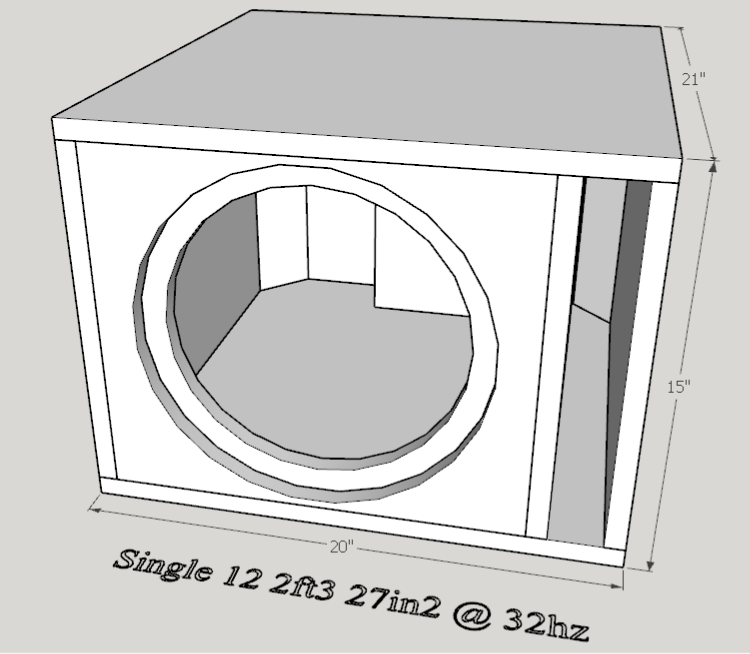

Something like this is what you should look for online or at least close size-wise /w/ a slot if you want a dramatic improvement.
That double baffle is unnecessary with a P3 but it sure looks better.

Theres a couple of ways to downsize it too, like using a proper sized round port that'll save airspace if that one above is too deep or tall.

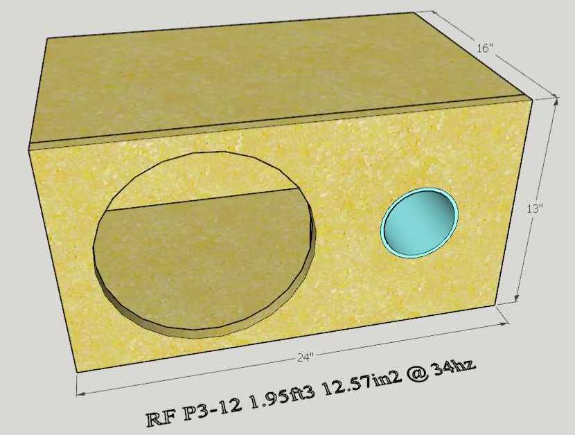

This might be closer to what you need. (I had to dig thru my hard drive for the design)
And thats decently small, There's no way a 1.18ft3 box can be ported and have any decent results for that sub you have unless you add airspace somehow.
