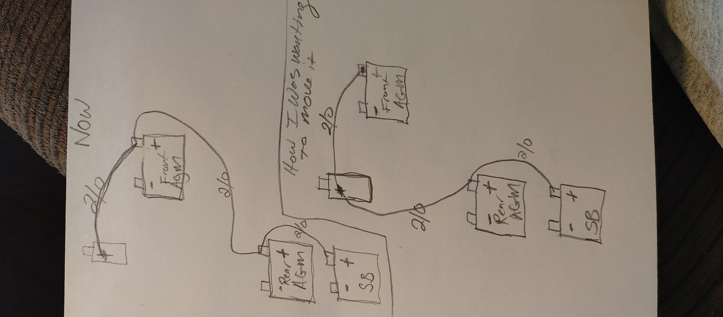

I currently have 2/0 running between my agm under the hood to my rear agm and superbank.. Im moving my batteries in the rear and need to gain some length in the 2/0 to make it happen.. I could run my 2/0 directly to to my 300amp alternator and gain the wire i need for the rear.. Is there any draw back to going straight to the alternator? I have 2/0 big 3 under the hood also. Thanks.

i currently have 2/0 from the alt to under hood battery and and then 2/0 from the front to rear batteries. All i want to change is to move the 2/0 going to the rear battery over to the alternator.

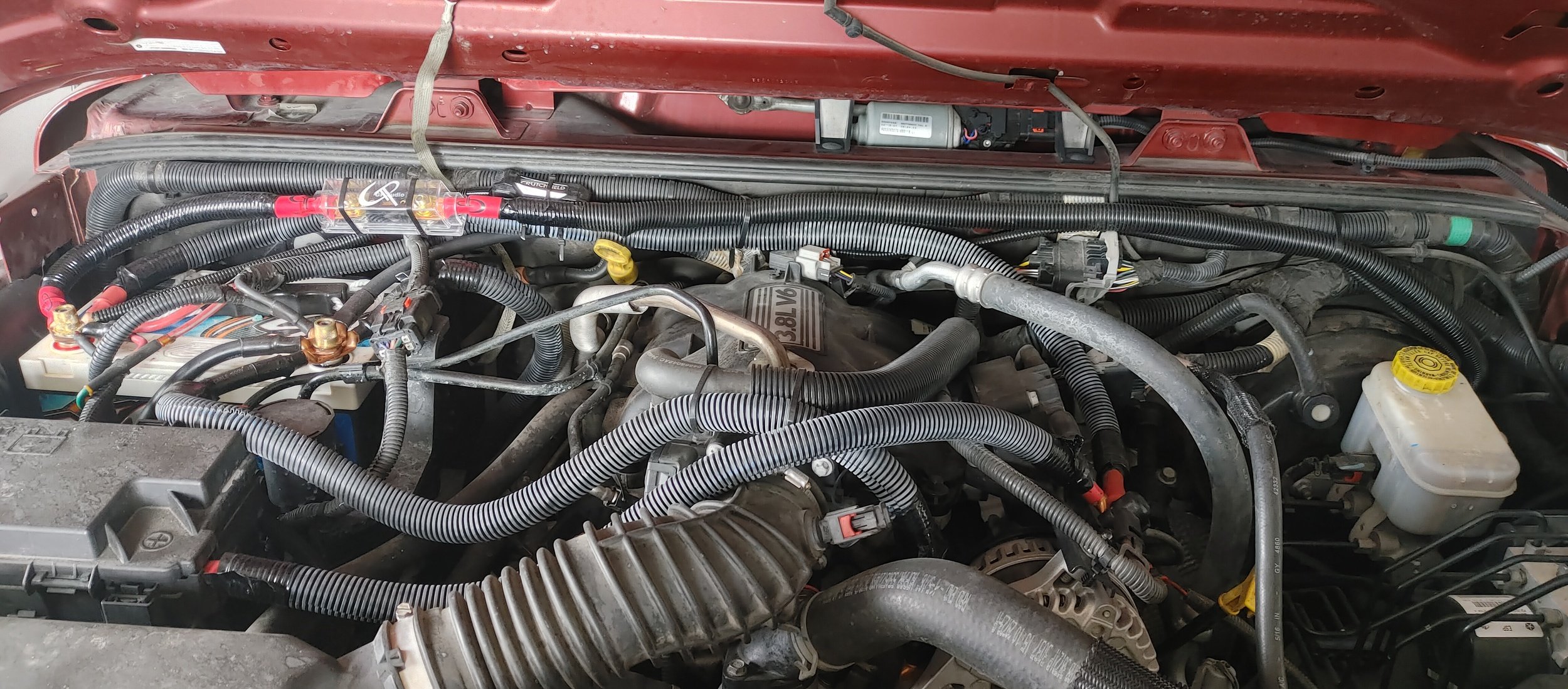

But if i don't use a isolator the batteries would still be connected? But instead of being connected at the front battery positive it would be at the alternator so id still get the full amp hours right? I was worried it might be hard on my alternator or something... Every example i can find online has it wired like i have it now... Even if i leave it on the battery up front i can route it down the passenger side to gain the slack i need.. I was just being lazy 😂

Yeah you can do that. Just make sure you still have a positive going from your alternator to your front battery positive. Have done it like that on two of my personal cars.
I do.. Is it less efficient like that or the same?

But if i don't use a isolator the batteries would still be connected? But instead of being connected at the front battery positive it would be at the alternator so id still get the full amp hours right? I was worried it might be hard on my alternator or something... Every example i can find online has it wired like i have it now... Even if i leave it on the battery up front i can route it down the passenger side to gain the slack i need.. I was just being lazy 😂View attachment 36961
You're right, I didn't think about it that way. I was thinking it would isolate the under the hood battery from the others. Sorry about that.
I don't think others understand what you're trying to do, so here's my interpretation:
OP is relocating the aft batteries. His wire is not long enough to go from the front battery to the new battery location, but it is long enough to go from the alternator to the new battery location.
To OP: the only thing you are changing is the junction point between alternator and batteries. Nothing changes circuit-wise. Battery isolators are overused and have become a catch-phrase for people who don't understand their purpose; you don't need an isolator.
