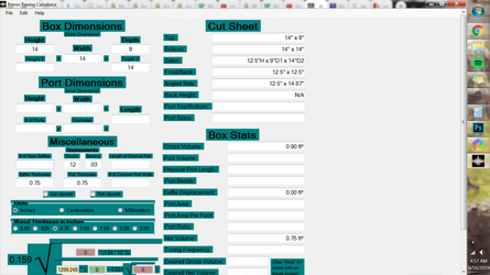

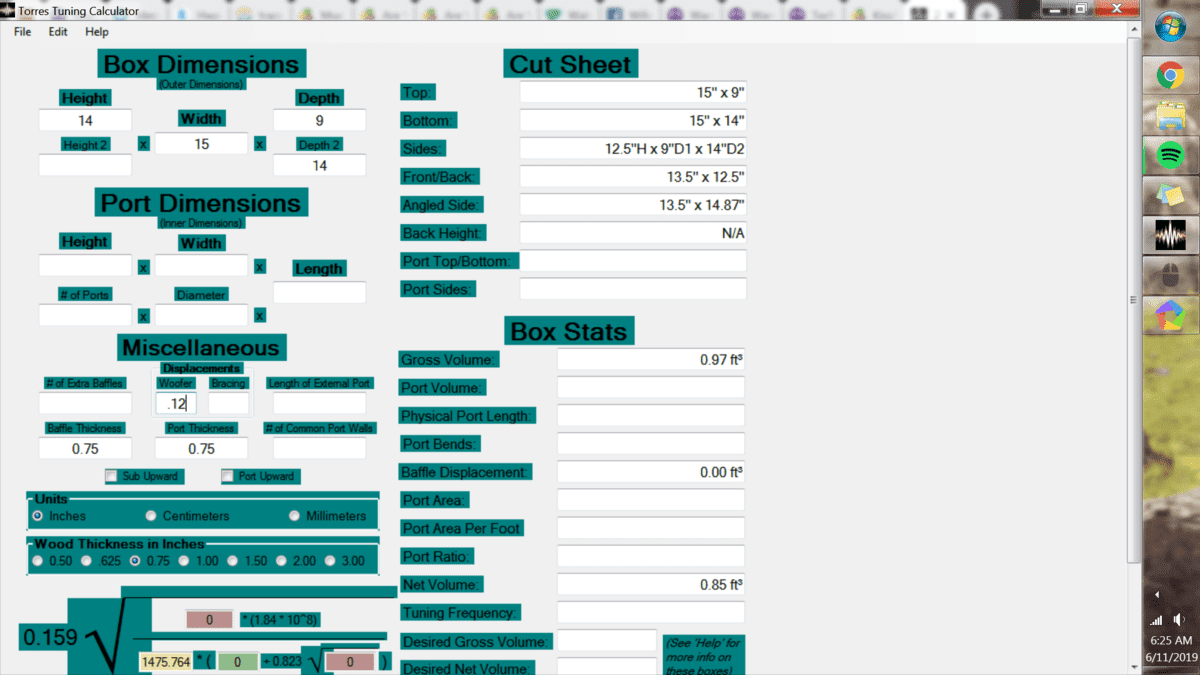

surprisingly the dayton 10 actually needs around .95 cubic feet to sound its best. While the dayton 12 needs .85 cubic feet with the dimensions I showed in that cutsheet. so i would actually just do the 12 if you doing a box like that, just give up the extra 1 inch extras on dimensions and you'll sound a lot better than the 10. The 10 will work in the smaller one but thats the bare minimum, you'll want to stuff it with polyfill. But again, it wont matter too much, whenever you go smaller you trade up low end extension for more punchiness.
make sure you get the dual voice coil ones not the single voice coil daytons.
Thanks...when you say..." give up the extra 1 inch extras on dimensions", are you saying to build the box an inch bigger in height/width?  So 14"×14" and 9 deep up top and 13 deep on bottom?

Per your recommendation, I'm going to build a box 14" wide × 14" tall × 9" top depth & 14" bottom depth.  I added an extra inch at the bottom depth and total internal volume looks to be .90.  Can you send a cut sheet?  I'd like to add some 1"×2" internal bracing and 2"×2" triangular bracing to the edges so the box stays rigid.  I'm not sure how to brace the bigger back wall that will be about 14" ×16".  Thoughts on bracing?

poly fill is needed since after accounting for the space the subwoofer takes up you are .10 cubic feet short at .75 cubes net buuut, this polyfill will basically make it perfect sizing, usually gives a 10% increase to enclosure size so you should be right at what you need. Stuff the whole box till its almost full with decent room for the sub.

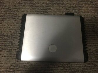

Bummer...after a 7 day ebay auction, my 9 month old jl 8" powered sub didn't get any bids at $275 + $20 for shipping...also have had it for sale on Craiglist for the last week.  I watched those taramps youtube videos...the MD1800 produced 2476 watts at 2ohms...crazy power.  However it was drawing 250+ volts and I doubt my stock battery/alternator can push anywhere near that with my Alpine 4 channel amp(85watt RMS × 4 at 4 ohms or 125watt × 4 at 2 ohms) with (2)30Amp fuses.  Does that mean the Alpine draws up to 30amps or do you double the fuses Amps and it draws 60amps?
The Taramps seems overkill for a daily driver who doesn't compete or care about being really loud.  How would it compare to the hd750 in terms of sound quality and power consumption?

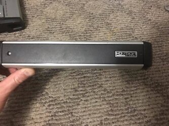

I found out my jl audio rbc-1 bass knob isnt compatible with the hd750/1 and I would have to buy another knob kit for $40.  I'm looking at the Taramps or the jl jx1000(will work with my bass knob)
