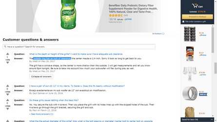

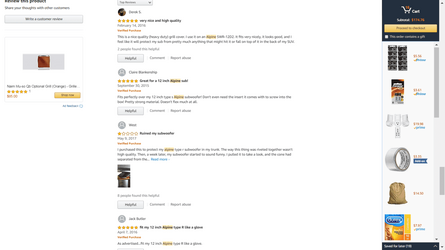

Thanks...have you installed that grill on this Dayton sub?  They dont state the actual diameter or depth and there is a review saying a Alpine type r sub was ruined bc it was hitting the grill upon excursion.  I talked with Parts Express tech guy yesterday morning and he said to make sure the grill can allow for proper excursion and I may need to add a spacer to push the grill out a bit.  Thoughts?
I saw that exact review and alpine was literally trying to get out of warrantying the sub for him and gave him BS excuses. Its not because of the grill, its because the glue failed at the triple joint where the spider and coil connects. Thats not something rubbing the surround against the grill would do at all, the most the rub would do is scratch the foam surround, not launch the whole coil through the spider which is from using way too big of a box while playing way too low of a bass note along with heavy clipping or maxed out gain settings. Literally pure user error.  There's other reviews that said it works fine with their dayton sub. There's also this other reviews of two others with alpine type Rs as well and he had no issues. So that review you read is literally a noob that fked up his sub by abusing it and is pissed off that no one is warrantying his f**k up which is not covered by warranty.

Have you personally installed any of these grills?  With the xmax being 14mm(.55"),  looks like the original universal grill that you linked should work having 1" clearance on the surround and 1/4" in the center.   I bought it...will prob get some longer screws to go into the plywood

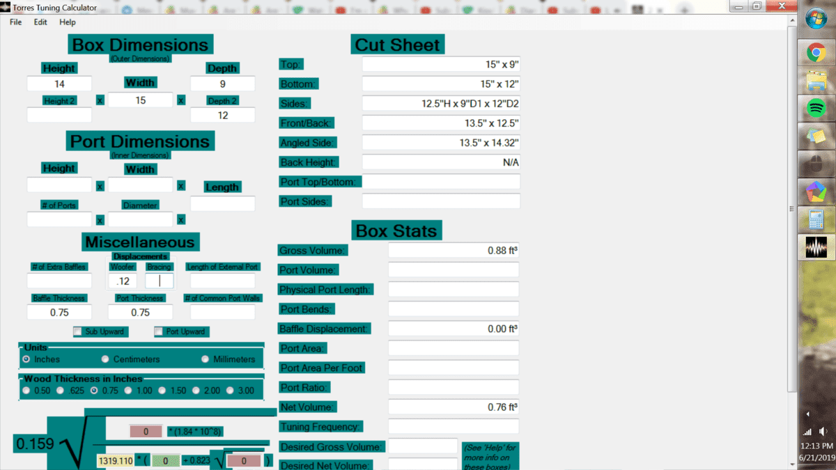

Jeff, I just bought the wood and materials at home depot.  Thanks again for all your help and my apologies for the repeated questions.  I was going to begin making the box tonight...Is there any way you can send over a final cut sheet with these dimensions : 15" wide × 14" tall × 9" top rear depth & 12" bottom rear depth?  Thanks a ton....sorry for the repetitive questions.
