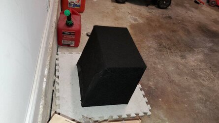

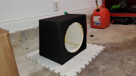

Thanks...I drilled pilot holes and used screws every 4" and let the glue cure overnight upright on flat ground with a 45 lb flat weight on it.  This morning, I touched up a couple tiny voids with titebond and it feels rock solid.  Once that dries, I'll caulk the inner joints.

Thanks...I decided to hold off on spending more $ on the twk88.  I'm going to try and adjust the crossovers and polarity to try and blend everything.  I carpeted my box tonight....definitely messy and doesnt look great up close.  Tough to get perfect seams.
