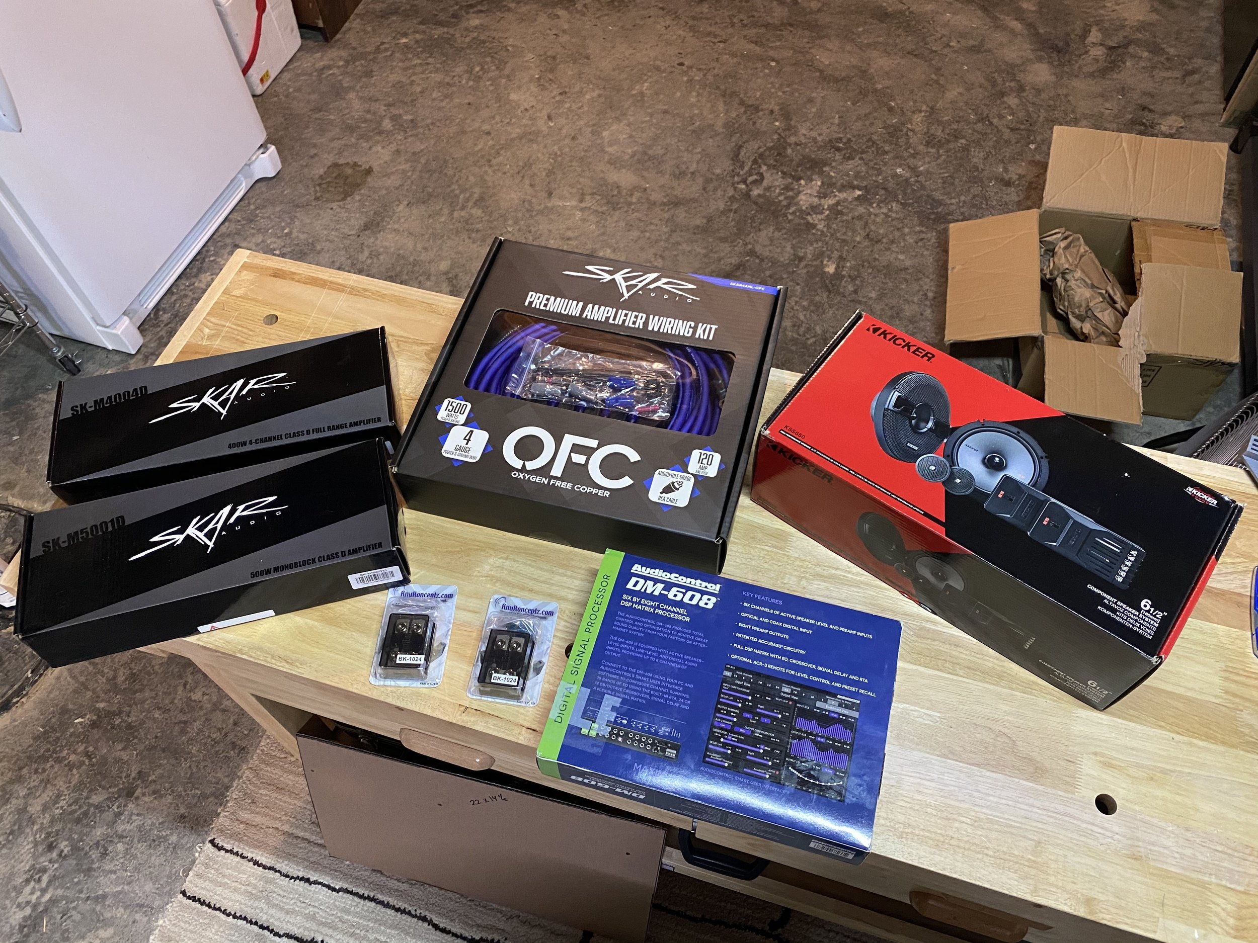

Let the upgrades begin...
Starting work on the amp rack today. Going with 1/2” MDF mounted on the rear wall behind the seat on the drivers side. You can see the cardboard template at the bottom of the picture. I chose a location where I could use existing mounting holes and bolts where the factory plastic used to be. No idea how I’m going to arrange everything yet. Components going in the front. May mount the crossovers on the amp rack but I’m leaning more toward under the drivers seat where the pioneer currently lives. I want to avoid mounting the crossovers in the doors at all costs.

Not sure It just looks like a complicated dash and if all she wants is extra bass I can just delete the two channels in the rear lift gate and use that for the bass channel (if they are full range). That 608 will be able to tell me whats on each channel.
