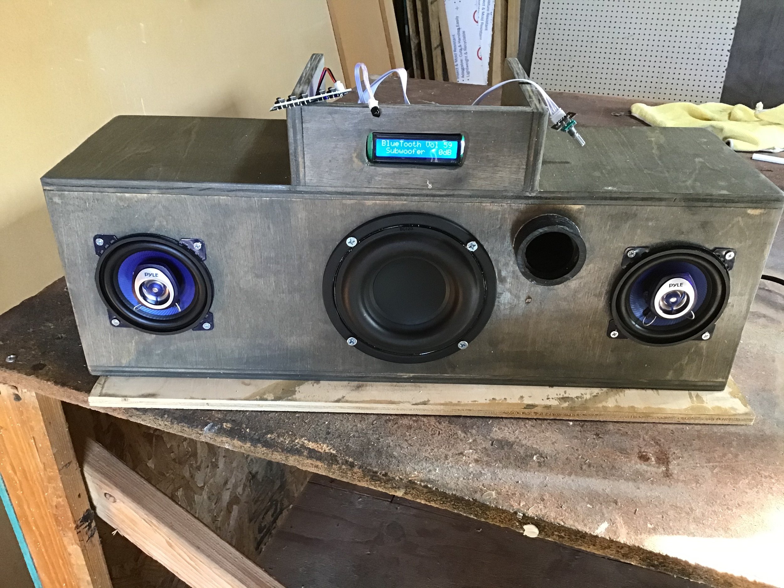

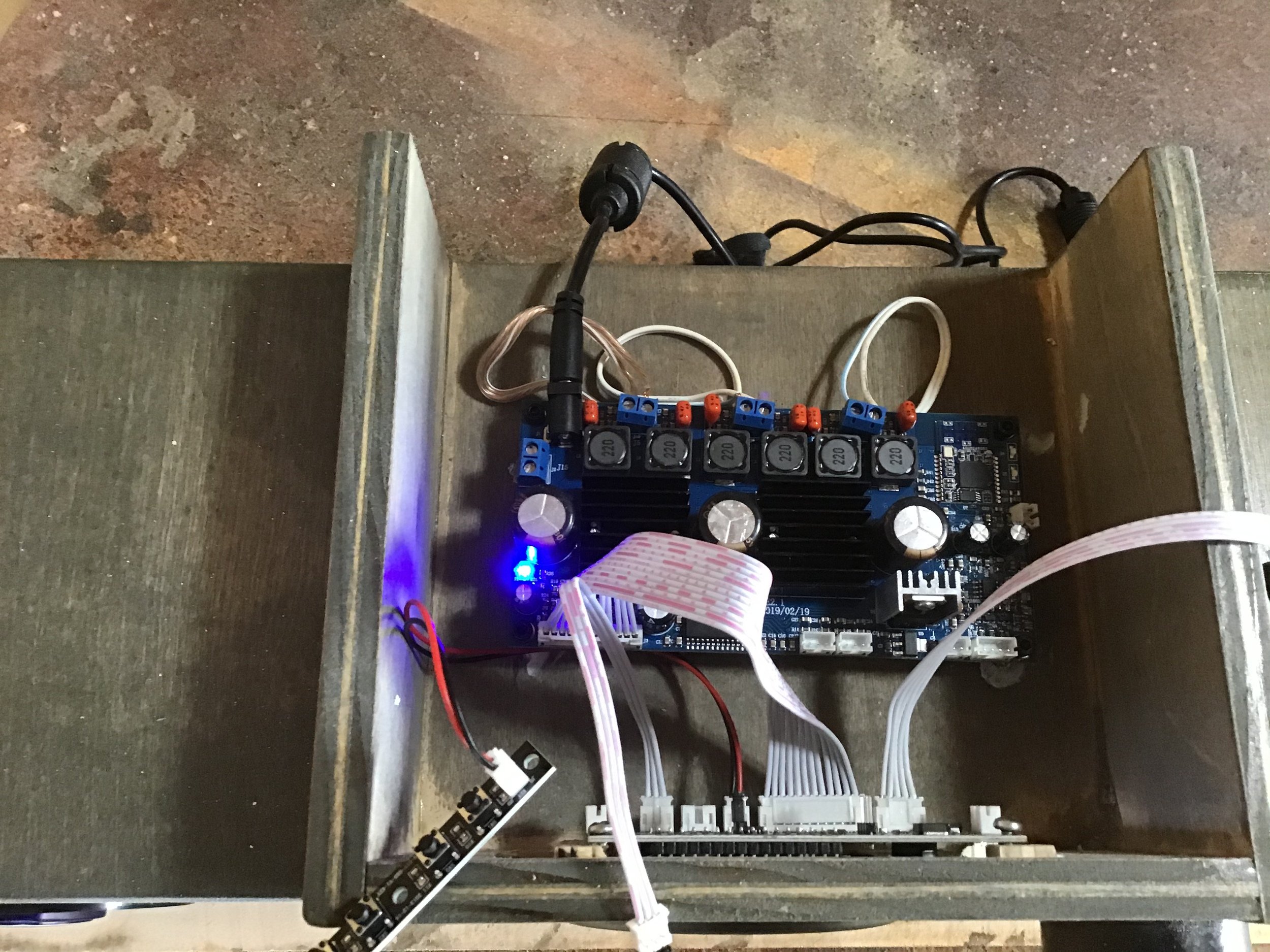

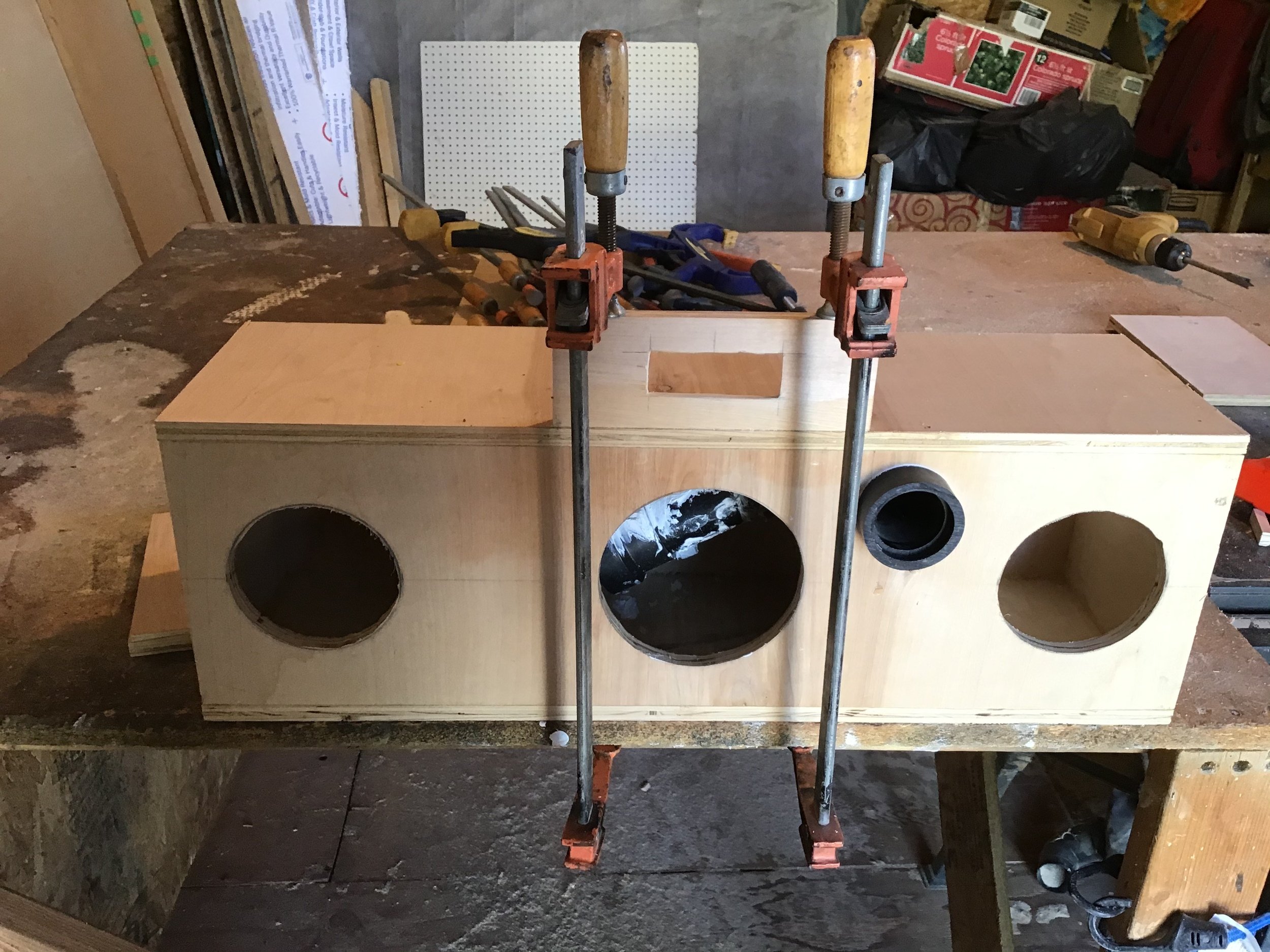

Not really car audio, but I thought I’d post it. Using a tang band 5.25 inch sub and a small 2.1 amplifier. 50 watts to the sub and 25 to the two 4 inch speakers. I used some 12 dollar Pyle speakers I had lying around. Running the amp on 24 volts. The sub has around 9 mm of excursion. Moving some decent air with this little beast.

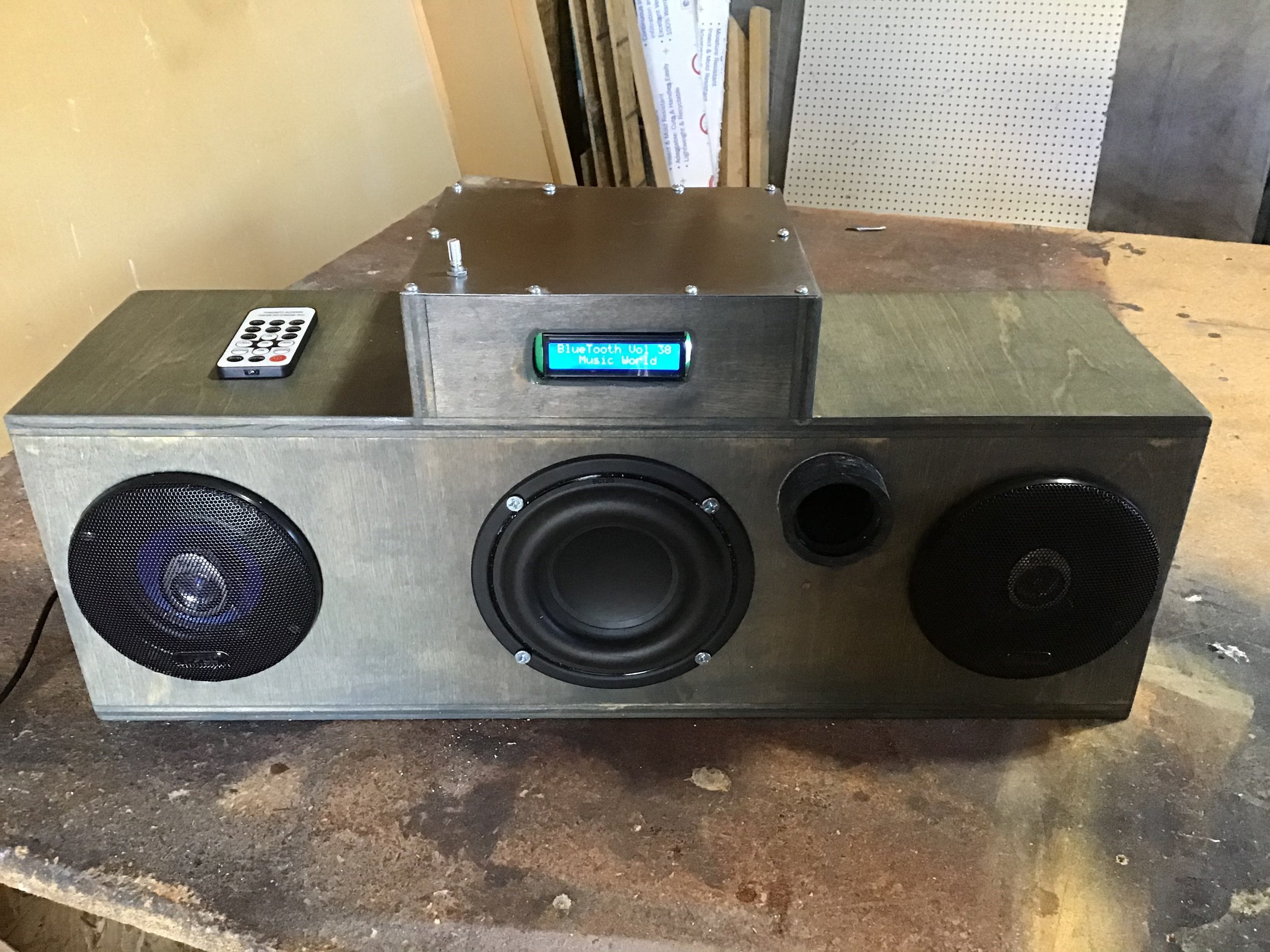

Finished the garage stereo. Cut up a kick plate off an old door to cover the top and back of the amp. I found that I don’t have the tools to cut a square hole in the middle of metal, which is why the digital screen is in the wood Instead of the metal panel. I also found that the remote is a piece of crap with maybe 6 feet reach, so I installed a volume knob on top, which wasn’t in the original plan.
