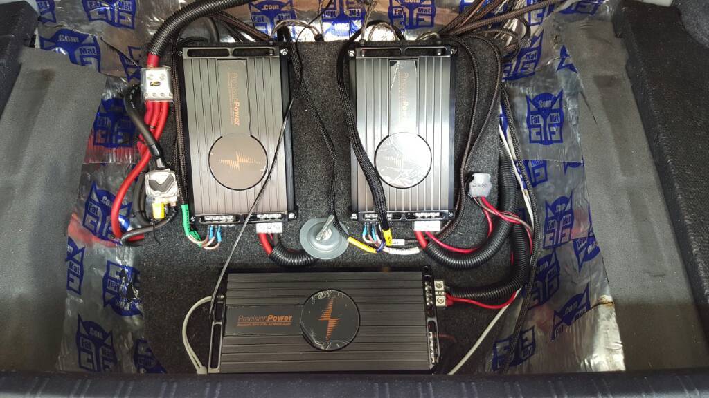

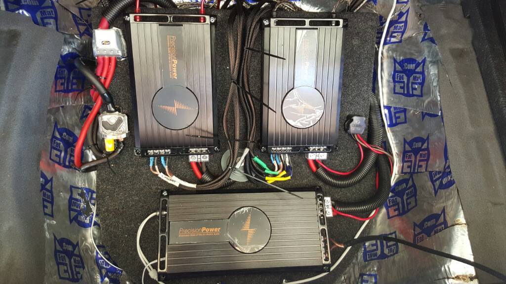

A shot of what the amp rack pretty much looks like.
Still having weird issues with a possible bad rca. I'll have to get into that later.

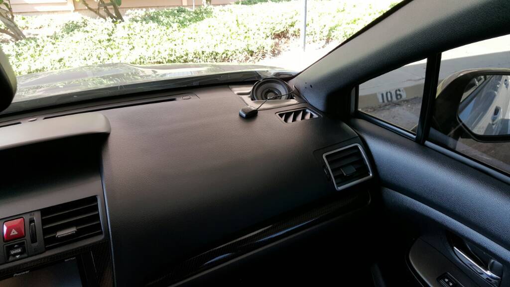

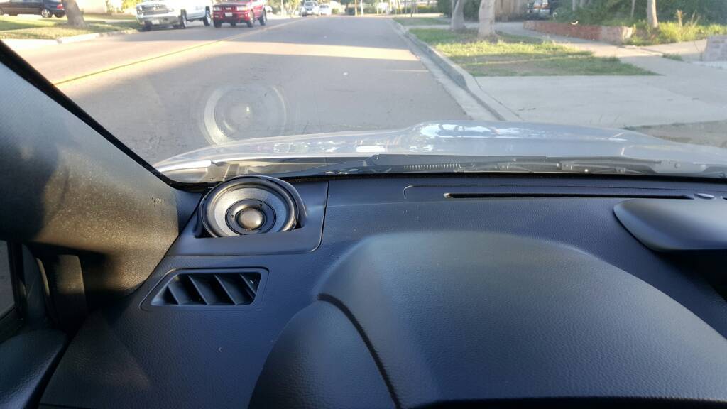

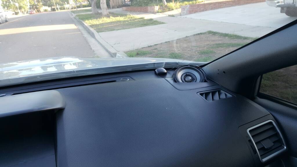

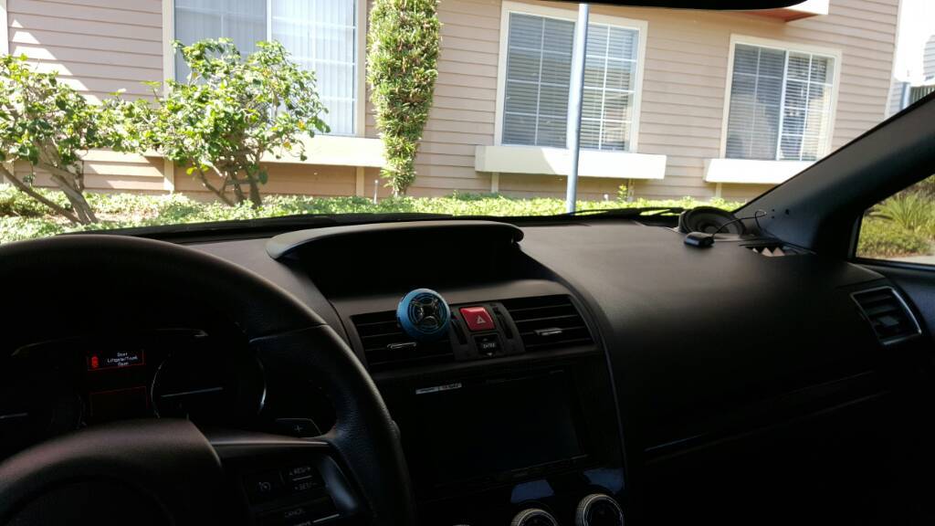

So here's the pods, like I said, the installer wasn't happy with how they came out so they're going to get bondo'd and sanded some more but I think that angle will be staying. They're slightly toe'd in towards the center but not much and they point towards the windshield at about 3 quarters of the way up, I think the headliner helps the reflections out a lot.

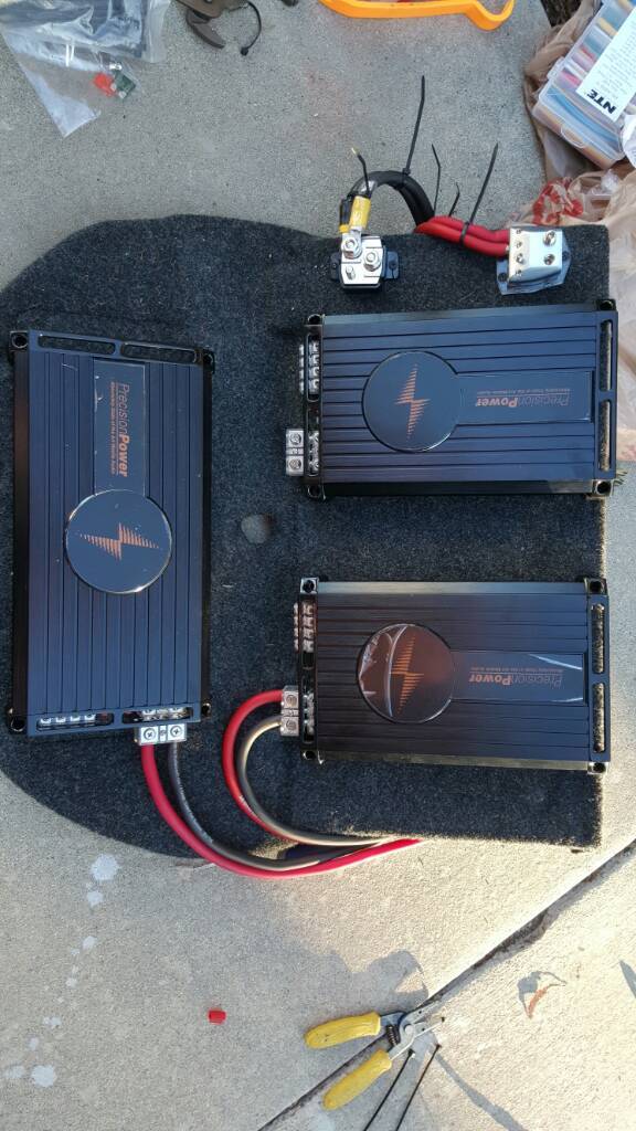

So I did some troubleshooting today and it appears that one of the amps is defective and has a single bad rca input. I contacted the seller from amazon so we'll see how that goes.
In the meantime I decided to just run 2 channels from the defective amp to the tweeters and run the other in 4 channel mode to the midrange and midbass speakers. The midbass definitely needs one of the amps bridged because it's just not enough for them right now and they can't keep up with the substage.
I also cleaned up the wiring a bit more. I'll finish cleaning it up fully once I receive a new amp.
I just used some tech Flex and wire loom since I had a ton of different colored wiring.

nice build, how do you like the ppi's so far
The PPI's are good so far. I'm waiting for another to arrive because one of them had a bad rca input. So far no noise and plenty of power. Installation wise they're just ok and they do run hot but so far no shutting off.

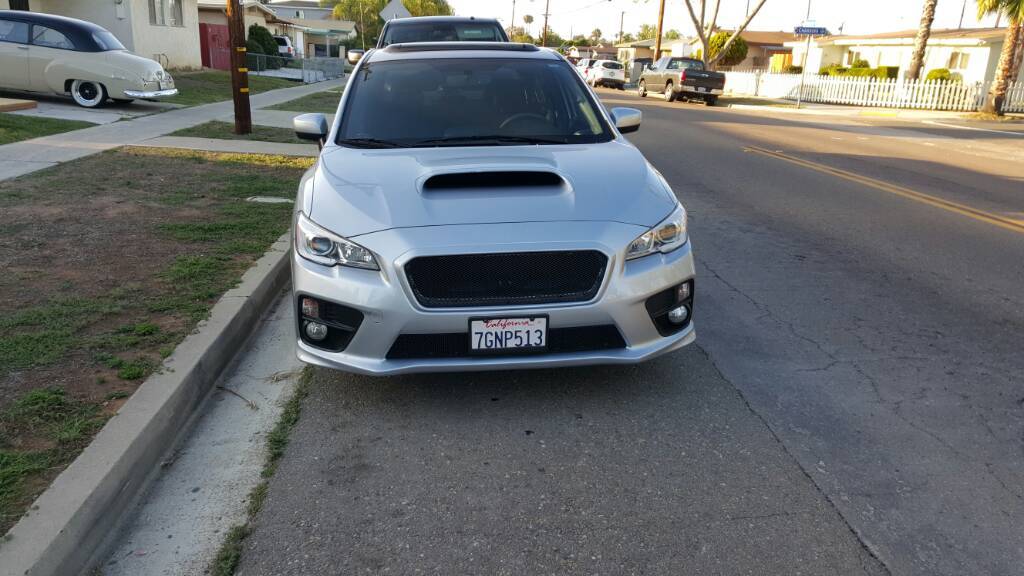

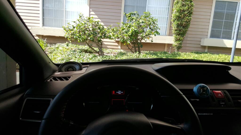

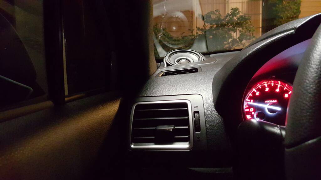

The grille is installed, speaker pods all done, and COBB access port installed.

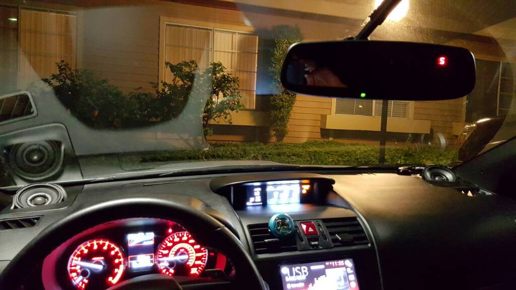

PODS: the pods came out looking a lot cleaner and the paint is almost dead on with the center dash piece. I just need to figure out a way to make a pressure fit speaker grille.
BUMPER GRILLE: The new grille is awesome and makes the car look a lot more aggressive IMO. I just need to get the last piece which goes to the hood scoop.

The new PPI amp came in and I bridged them to my midbass and now they're really pounding. I have a pretty good tune set right now that I'm happy with til the next time I decide to do a little more tweaking but overall I'm really happy with how it sounds.
