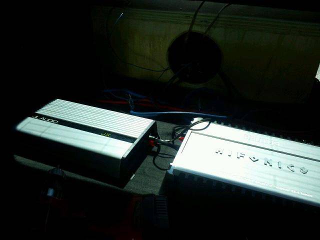

After a lot of planning and headaches of what to do, I got a brand new Jl 360/2 for my Type R door speakers for now. I figured out a trick, instead of running brand new wire from the crossovers from the door all the way to the back of my car I can just stick with the wire already ran in the car. I am removing my rear deck speakers because I no longer use them, cut those wires. I take out my H/U and from the wires I cut my front door speaker wires and my rear deck speaker wires off the harness. Then I splice the two together, Front and Rear deck speaker wires. Now I have a connection to the rear deck speaker holes, so I can just run the 2 channels straight from the amp into my trunk and into the rear deck wires. Vuala I just saved my butt a crap ton of work wiring new runs of speaker wire to the back. I am just going to test the factory wire for now and see how it is, I can upgrade later on.
Another trick is, instead of running a whole new RCA run from h/u back to the amp, I just disconnected the sub right/left from the head unit while I am back there splicing wires and hook them up to my front right left speaker inputs, done. Now with the Mini RCA hook ups, I daisy chain from output of my sub amp to input on my front stage amp. I lose a few options to adjust the sub head unit wise, but no big deal. I learn something new everyday.

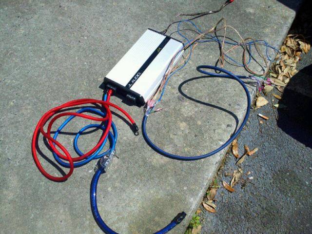

Well after a lot of work just getting it set up, the amp doesn't even turn on... I tried unhooking the sub amp and then just moving those same wires to the Jl because I know everything works and the green power light is not coming on. I tried jumping the remote wire and stuff as well still nothing. I can't get a new one until next week so I asked around local car audio on facebook. They suggested maybe the green led is just bad, so they talked me into buying a dmm. I went to walmart and bought the cheapest one I could find. After a whole day of failure yesterday, hopefully today I will figure something out.
