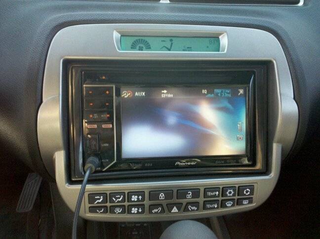

Next after I bought the car, I knew I wanted a touchscreen H/U, never had one before so with the rest of my deployment money, and got what I could. A Pioneer AVH-P3200BT which was about 400$, the sad part was the install kit for the camaro at the time was 300$ !!! Just for something the touchscreen could sit in and integrate A/C controls, etc. It was the only one made at the time, and still might be, but I went with it. I was excited, a 18 year old, with money, and you buy some dumb expensive ****.
After that expensive little piece was put in, It blew my mind. Stock radio speakers were so much louder than before, I guess that little boost in wattage from the H/U made them soar. It was so clean and loud I was hooked. Somehow I made it a few months without blowing more money on subs right away, but I just couldn't wait any longer. About 6-10 months later, I went and bought me a Alpine Type-R 12" Which I have used in another car. I also had the Alpine Type-X before this, but me being stupid and not understanding a prefab box was just not cutting it, I sold the type-x a week later thinking it was a waste of money. Little did I know the same guy that I sold it to had a box built to specs a few weeks later after I sold it to him. He gave me a demo, and I couldn't believe it same sub, same amplifier, but it was so loud it hurt my ears. I didn't think of it anymore really after awhile, but that definitely opened my eyes to what needs to be done to make things loud.

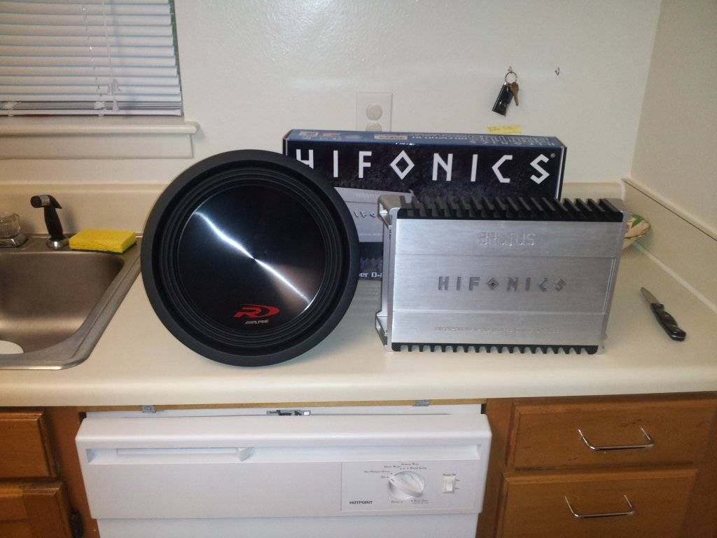

So here it is my Type-R and the Hifonics Brutus 1200 that banged my car for quite sometime, until now.

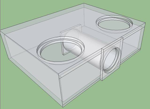

This is the concept that later began in the wood-shop

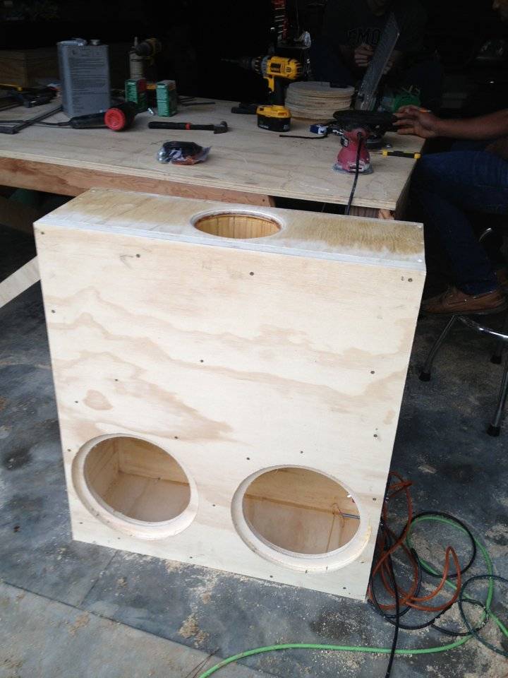

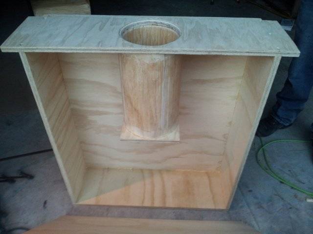

A day later I went to check out how it was going. This is the pictures of what was in-progress and looking good.

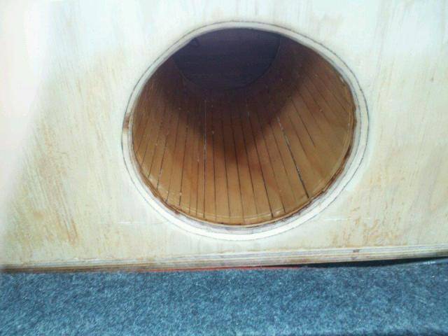

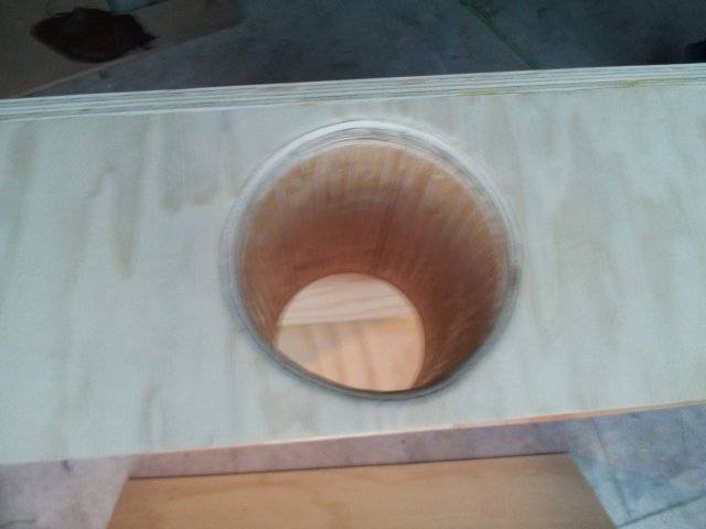

Now as you can tell yes, that is a port made completely out of wood, it was so smooth, and accurate, a ****-near perfect circle. A lot of cutting stop, measuring, moving cutting stop, etc... But he made it happen, he said it was his first cylindrical port made completely out of wood. No plastic, PVC reinforce, nothing. Straight wood. //content.invisioncic.com/y282845/emoticons/wink.gif.608e3ea05f1a9f98611af0861652f8fb.gif

Then the final result was in the next day.
That's it fellas, that was the box as you can see it turned out a little bit different from the orignal concept, I like the holes on that side anyway. It was either have the port facing the back of the trunk which would make the subs hidden and the port hidden, or turn the port towards the cab, and you can actually see the port well from the cab, and see the subs with the trunk open. I decided on the forward facing port, and boy does it slam on only 900 watts. I'm not sure what to do on the box as far as looks, maybe some nice carpet, varnish or something. I didn't care right away I just wanted to test it out.

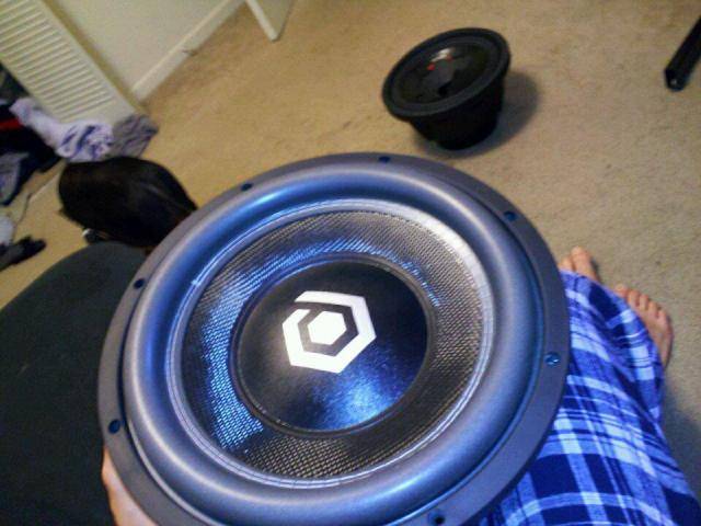

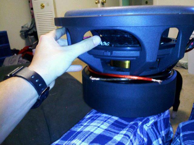

I already had my first AQ HDC 3.0 before I got the box built. Man after never being able to hold a real subwoofer like this with a massive motor/magnet, I was in shock. It weighed so much, I really couldn't believe it, I was going to need help getting it out of the box and into my car lol.
I know theirs bigger, and better, but coming from brand-named stuff life alpine, which at the time I thought was huge, to this beast, all the emotions were going crazy. I'm worse than a woman.
I went with the HDC 3.0 1 Ohm DVC Copper subs, I could either wire one which is all I have at the time to .5 or 2 ohms, I wasn't sure about that impedance on an Hifonics Brutus so I stuck with the 900 watts @ 2 ohms.
Once I get the second Dual 1 Ohm sub, which thanks to jfroghobo, my second one is on its way, and will hopefully be here this friday. 200 Bucks out the door for a brand new DVC 1 OHM HDC 3, can't beat that!!!!!! I can then wire one sub series which I already have and the one I am getting in parallel for a final impedance of 1 ohm into the amplifier. Right now thats only 600 watt per sub off the hifonics brutus but I figured go ahead and get another sub then save up for electrical next. I plan on getting an AQ 2200 for both, then eventually get each sub their own 2200 Watts of power after full break-in.

Also jfroghobo shipped out that HDC 3 for me yesterday, I was going to have to wait until friday to buy it from him, but I was able to get the money early, so I went ahead and paid him and he sent it already. At the latest my second HDC 3 should be here friday and I can cover that ugly hole with another massive 12.
I know some people won't like this but the only bad thing about the subwoofer I am getting from him is the older style that says AQ on the front which I like better, but I also have the sub from where they started doing the new soundqubed subs. So the only thing that might be ugly is the two different dustcaps, but as long as it beats I am stoked.

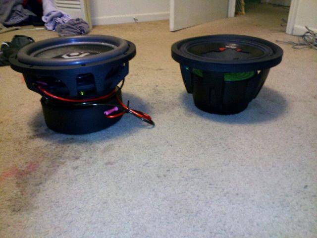

My second HDC 3 will finally be on it's way tomorrow hopefully and if all goes well it will be here Friday or Saturday. I am excited to cover this hole up with another **** 12" AQ sub.

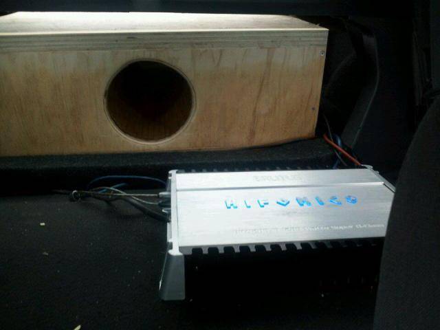

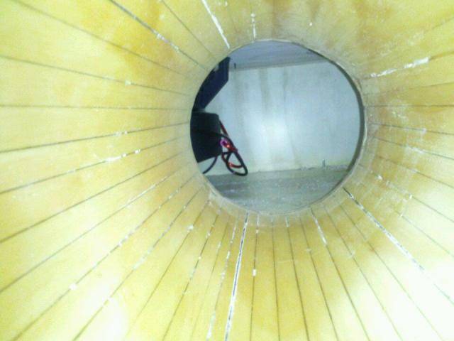

So heres a few pics as promised of what it looks like on the inside, my whole trunk is literally gone for the sake of audio. Oh well, I don't have kids and can use the back seats for groceries. The only thing that ***** is getting the box in and out of car to put new equipment in, like an amp(s) and extra battery(s) I have just enough rough on each side of the box for something. I might have to get creative maybe I can put an amp under my car seat with a few fans and hopefully it wont get too warm... Any suggestions? If anything I can mount an amp on top of the box I got enough room between the top of the box and the rear deck speakers for probably a couple good sized amps.

I'm going to be outside in a bit with the video camera so I can take a video of this baby slappin.

Ok so It's been like a week, I finally got my second HDC 3 a few days ago, running them at 1 ohm to a Hifonics 1200 watt. For now I am satisfied and I am back to upgrading my front stage. I have a friend with a ford explorer with a good amount of power running to his components and turns out he has the same ones as me and those things get extremely loud. I am currently looking for an amp to power my components so I can get them off my H/U and get them the clean, loud power they deserve. I can turn most songs up to about 30 out of 40 on my Head Unit before I hear some hissing froma few songs so I keep it a bit below that. I don't like going to full volume on my Head Unit so, if I get these Type-Rs some watts hopefully they will be enough to hurt my ears at lower levels.
