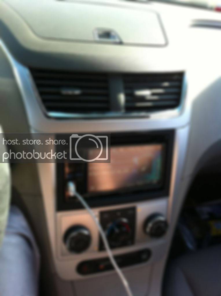

Brains:pioneer 3200DVD In Dash, Clarion EQ.

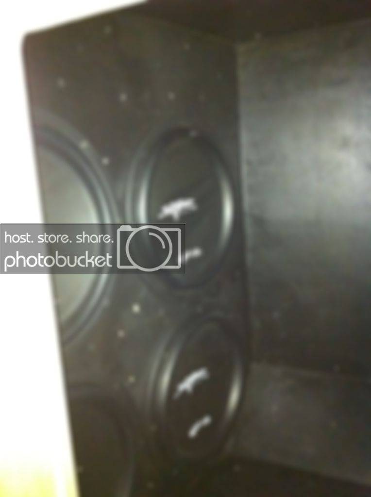

Box/Wall:4th order clamshell......7 Cubes Sealed, 13.5 Cubes Ported, 225 Sq Inches of port, and tuned to 49hz.
Subs:8-Skar Audio VVX-12's. Dual 4s.

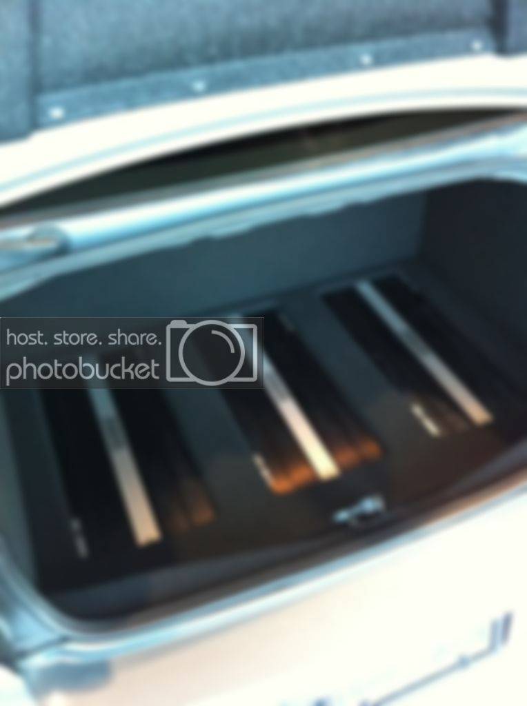

Power:1-Sundown 2ks at .5 each, 1-Sundown 100.4
