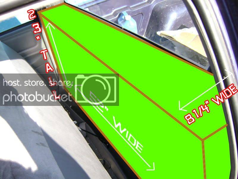

What are the diemensions of that DD 8" box?
I'm kinda thinking I shoulda got two 8s or something and see if I can fit them behind the seat in my reg cab sonoma... those lil 8s seem to get pretty loud..

I'd recommend standard ported boxes for two 1508's....1.75 cu ft plus port.....slot port opening....28 sq inches...by 16" long...should come to about 2 cu ft internal with port displacement and basket...maybe slightly bigger 2.1 or 2.2
Thats how much room I have behind my seats. Would be better if I did a wedge box.
I may sell my Mach 5 SPL-12s, cause I'm not really sure if I want to do a blowthrough to fit. What frequencies were the 8s tuned to in your sig?

when i ran the 4 they were tuned at 40 hz...same specs i gave you for your pair...//content.invisioncic.com/y282845/emoticons/smile.gif.1ebc41e1811405b213edfc4622c41e27.gif they should be very impressive.....with the space you have I calculate 4.2 cu ft...enough for 4 //content.invisioncic.com/y282845/emoticons/smile.gif.1ebc41e1811405b213edfc4622c41e27.gif but if your gonna run a pair...build that style box...and down fire your subs and port.....place the port on passenger side.....leave about 5" between floor and subs and port...actually building it truck style and leave about 5 inches and have it load into a wood bottom. it will look like a long port across the bottom you won't see subs or port...i wish i could draw it.....feed them about 2000rms...it will hammer //content.invisioncic.com/y282845/emoticons/smile.gif.1ebc41e1811405b213edfc4622c41e27.gif
