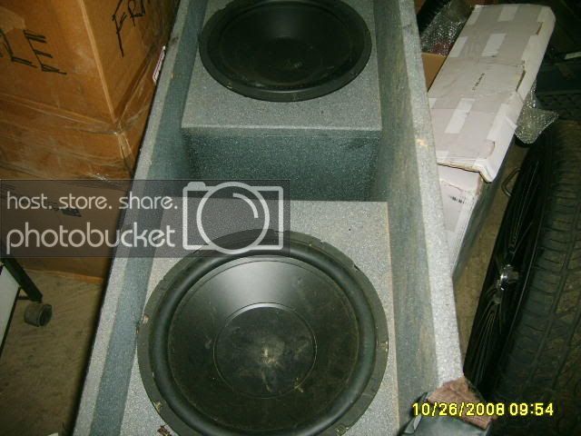

a sneak peak with a couple of ED 12's installed.....//content.invisioncic.com/y282845/emoticons/wink.gif.608e3ea05f1a9f98611af0861652f8fb.gif
