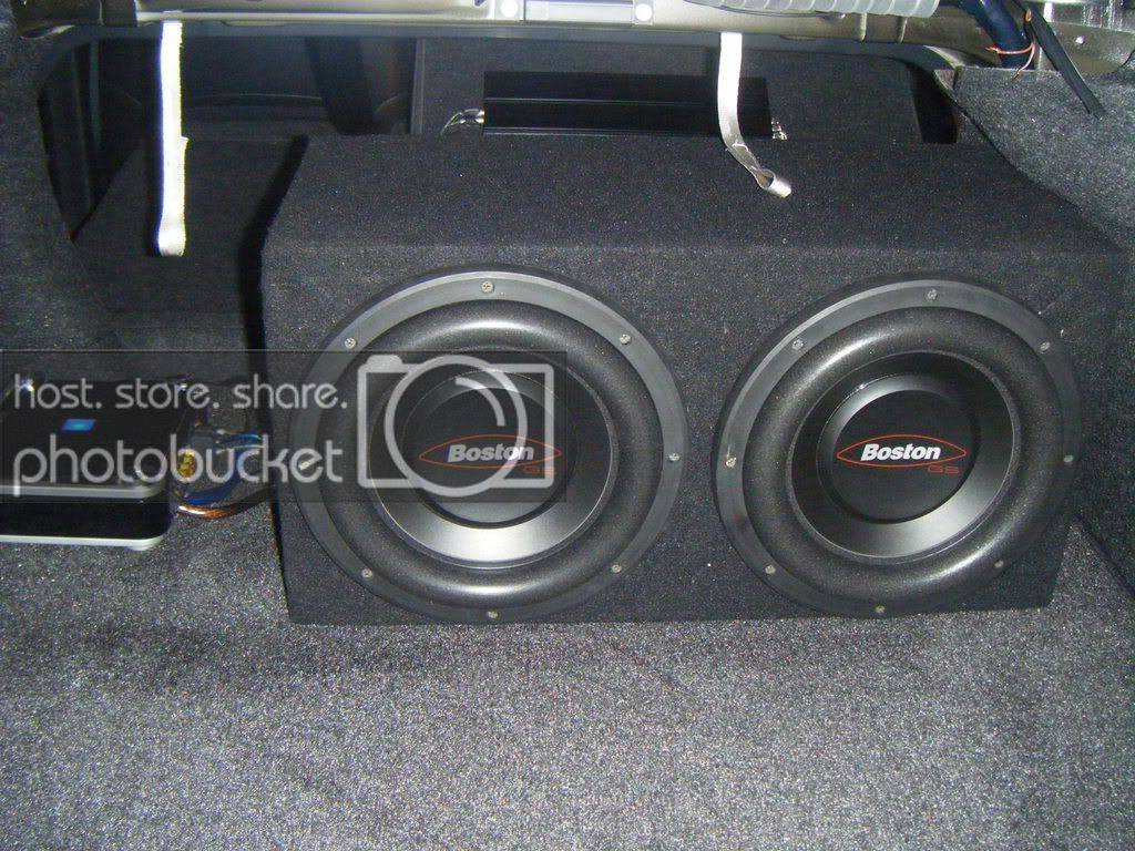

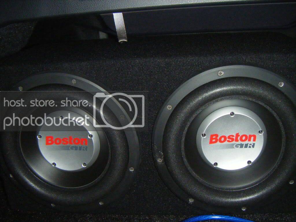

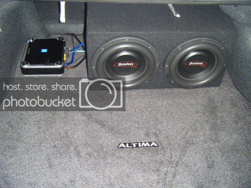

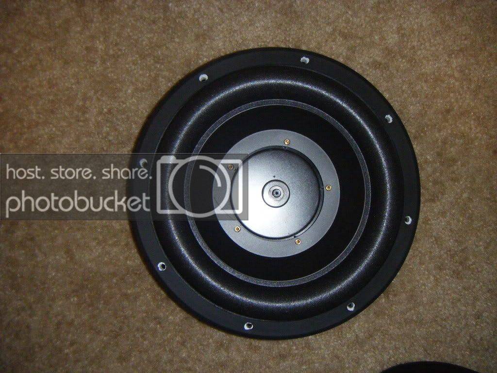

here are some pictures of the radiator being adjusted to 30hz. Got to listen to them and I am amazed how loud they get and sound great doing it. Nothing I listen to has alot of big bass but they played everything fine and got louder than any of the 12's I have installed. So much room left in the trunk I have to figure out how re-mount amps so it looks better.
I love how they sound they get pretty **** loud for being in such a small enclosure. Beside the subs are 2 batcap 800's. Right now I'm running a US amps md2d with the g5's and they love it! They can take more power than my 2 12in RE SE's could and they have never had any problems. Have u tried any of the other tuning freq's? Right now I am tuned to 35hz and I like it. In my titan I had the gtr's next to the g5's and they didn't really do anything so changing it didn't make a difference. Now that they are behind the subs, they make a huge difference.
some of the pics are up but gonna build amp rack and the head unit should make difference too, know where the vss cable is on the alti I have searched everyon forum known and nobody has a clue might have to pay to get it installed.

I am no expert on passive radiators, but i was always under the impression you needed double the cone area on the PR side per active driver. I.E. for every 10" driver there should be atleast 2 10"(if not 12") pr's. Someone correct me if i am wrong.
I have heard this but called the boston tech and asked myself. he said boston designed this to work with the g5 specifically. Its pretty cool because all you need to do is build sealed box and cut extra hole. Just dropping in the radiator is a 3 db gain in output and there is three tuning frequencies available with the radiators 45,35, 30. I am running mine with the extra weight at 30 hz and they sound amazing. Also asked about subsonic filter he said if running it at 30 hz no need for one and 35 to set it at about 28 and so on.
