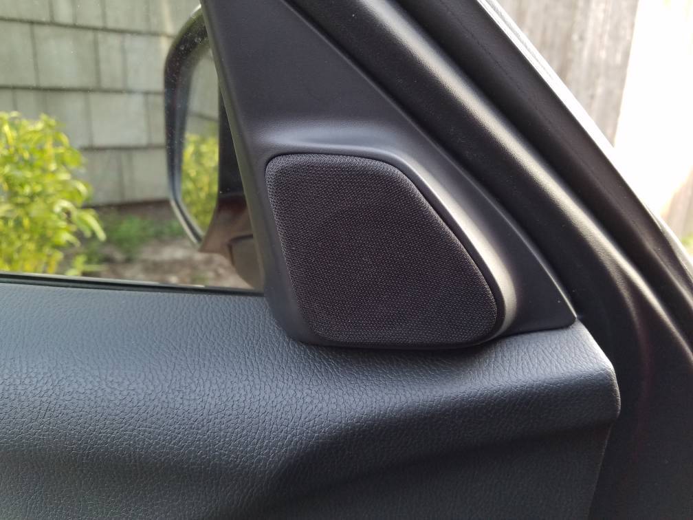

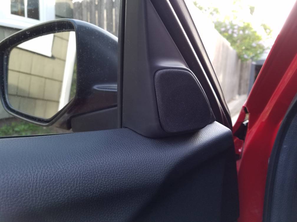

Finished the tweets and got the crossovers in - these Morels are impressive speakers!
Tweeter install could almost pass for factory.

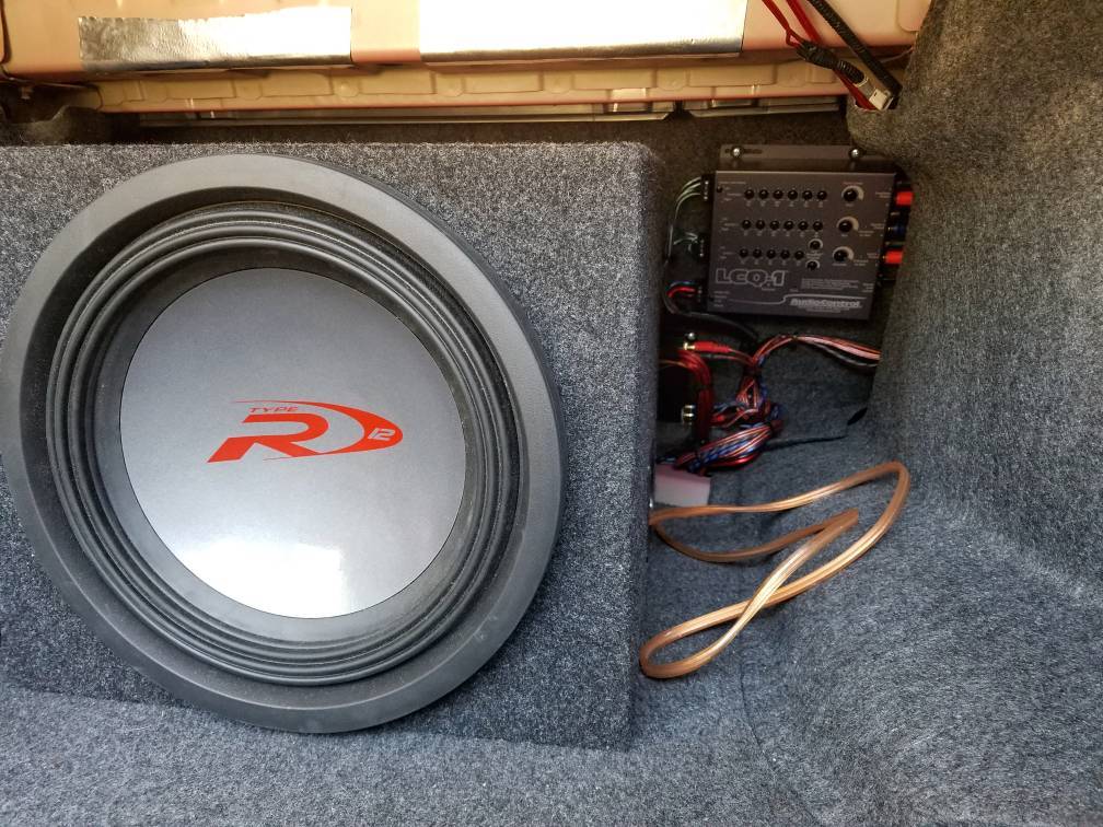

After weeks of vacillating whether I should attempt to tap the factory balanced outputs I decided to go with an AudioControl LCQ-1 which will allow a quality conversion of the speaker level outputs, add AccuBass (although it's questionable when there's a factory sub), add an EQ and remote subwoofer level control. This system, while great at high volumes, can get boomy at lower volumes when my wife is in the car and the sub control on the factory deck doesn't allow enough adjustment. Additionally, there's often times when I want to increase the sub level which the factory HU won't do at high volumes. For instance, listening to Dave Martone's "When the Aliens Come" the recording quality is great - except on the track "Maneemanaw" which is why I have the disc and could use a slight bump on the low end.
The LCQ-1 is in the mail from a member and I'm interested to see what it will do. I'm also going to buy a Dayton Audio iMM-6 microphone so I can have a low-budget RTA and the Dayton gets good reviews for the price.
Working with Zapco I found there where errors in marketing materials when my amp, ST-5X II, was released and while it was initially represented as 350 watts into a 4 ohm sub channel, with 4 being the minimal impedance, this isn't the case. The amp actually does 200 watts into a 4 ohm load and 300 watts into a 2 ohm subwoofer and as I bought a dual 2 ohm Type R I'm not getting full power. Thinking of finding a dual 4 ohm version of this sub but not sure of the benefits. Theoretically I would gain just under 3 db which would be audible however at the expense of additional heat and I don't know if there would be much of a difference as I'm increasing 50% not doubling the power.

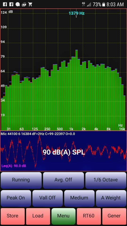

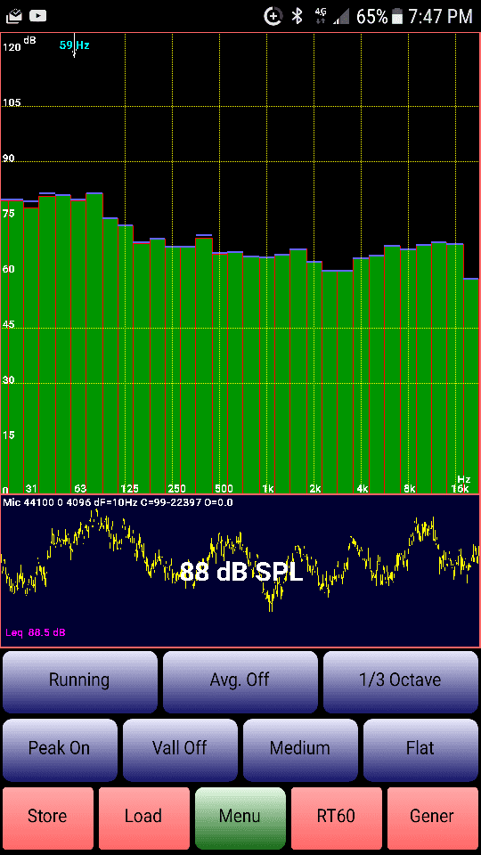

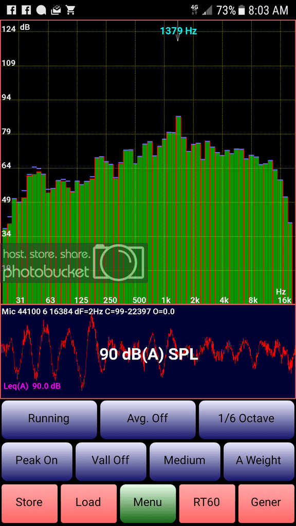

Purchased a Dayton iMM-6 iDevice Calibrated Measurement Microphone
Using AudioTool by jjbun (Android)
RTA from today - before adding LCQ-1
-Eric

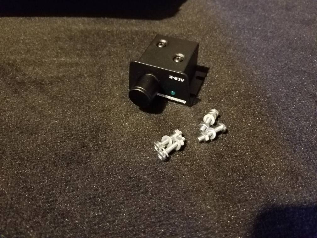

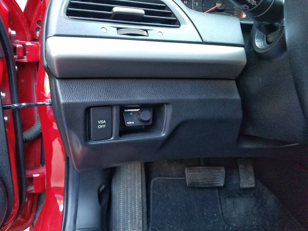

Update: LCQ-1 and remote control

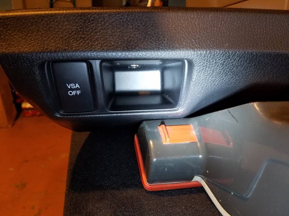

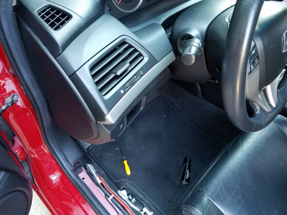

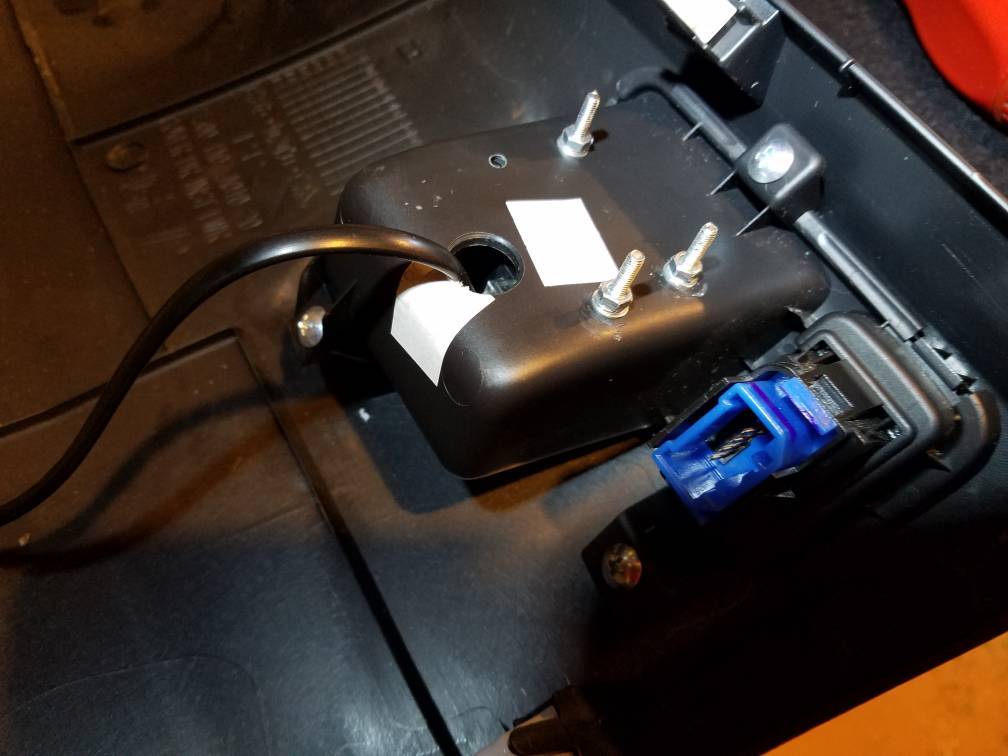

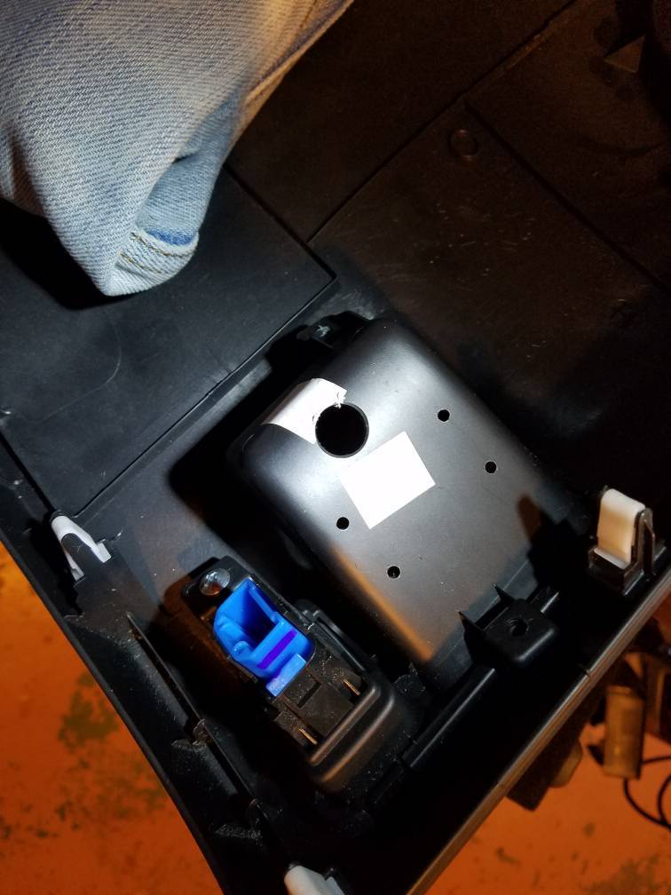

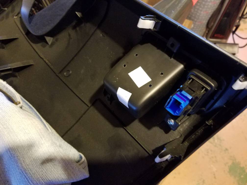

One of the main selling features for purchasing the Audiocontrol LCQ-1 was to have remote sub woofer level control. I decided to mount it in an empty cubby hole to the left of the steering column that I never use. I had two goals: make it difficult to see from outside the car to remain stealth and like the rest of the system be able to remove with minimal damage.
Although I did need to put 5 holes in the compartment, they are at the top and should be easy to cover without being obvious.
-Eric
Couldn't get the fourth bolt installed - still very solid:

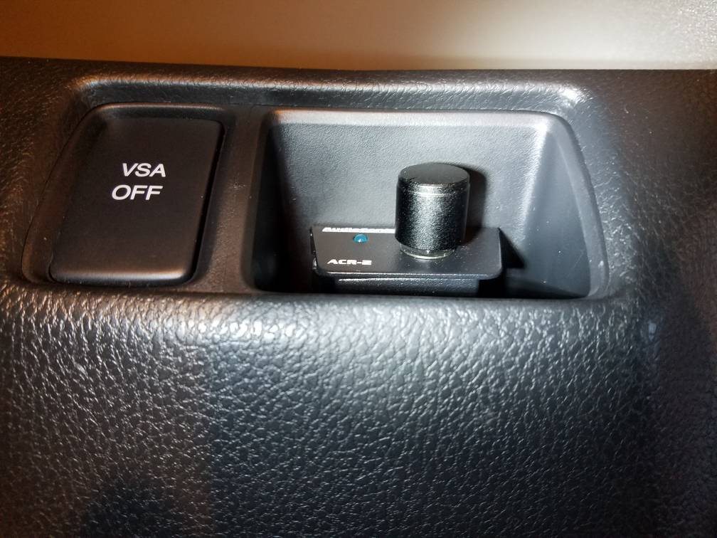

Can't see from outside:
Finished:

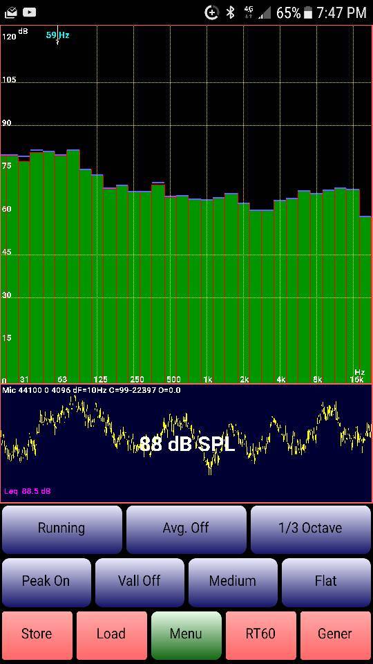

So what’s next? Besides fixing the images in this thread?
In my opinion the system sounds phenomenal as evidenced by the before and after RTA screenshots below. I can’t imagine the Morel components had such a terrible response curve and Honda must have equalized the car to compensate for some issues with the OEM speakers. It’s quite the difference and the LCQ-1 allows me to disable equalization from the dash mounted sub control to compare.
