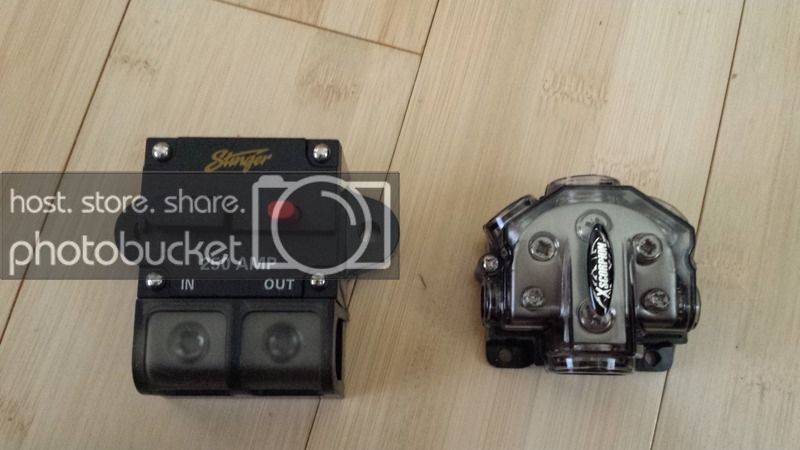

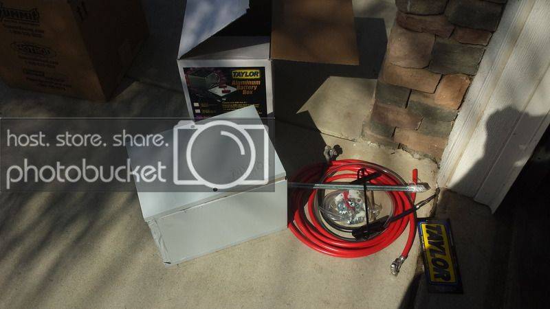

Stringer 250amp Circuit breaker and Distribution block
MB Quart amp for front speaker only
Battery relocate kit with 1 gauge wiring

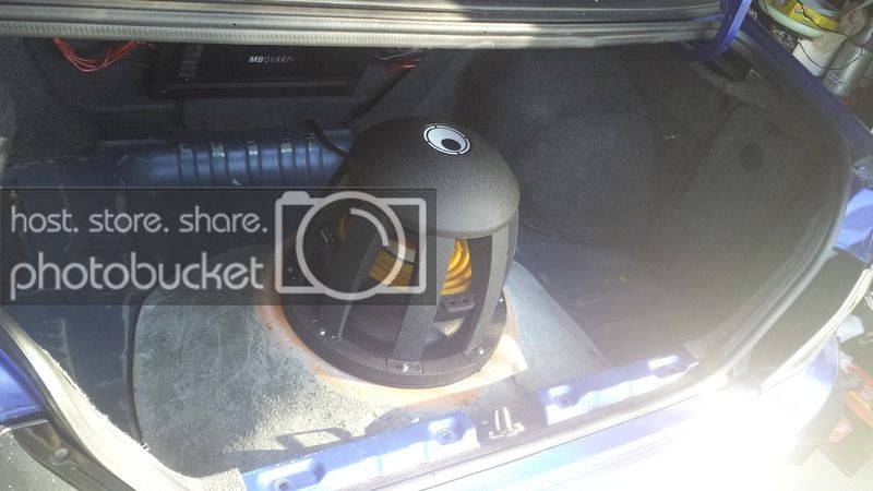

Now the build:

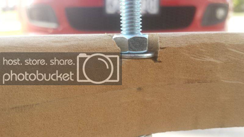

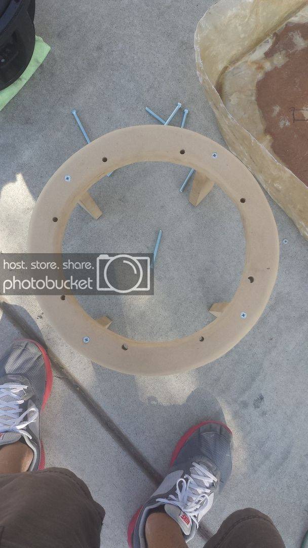

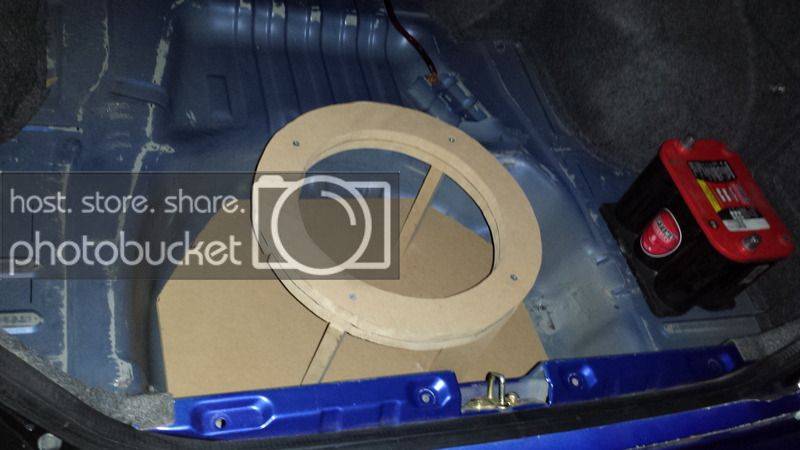

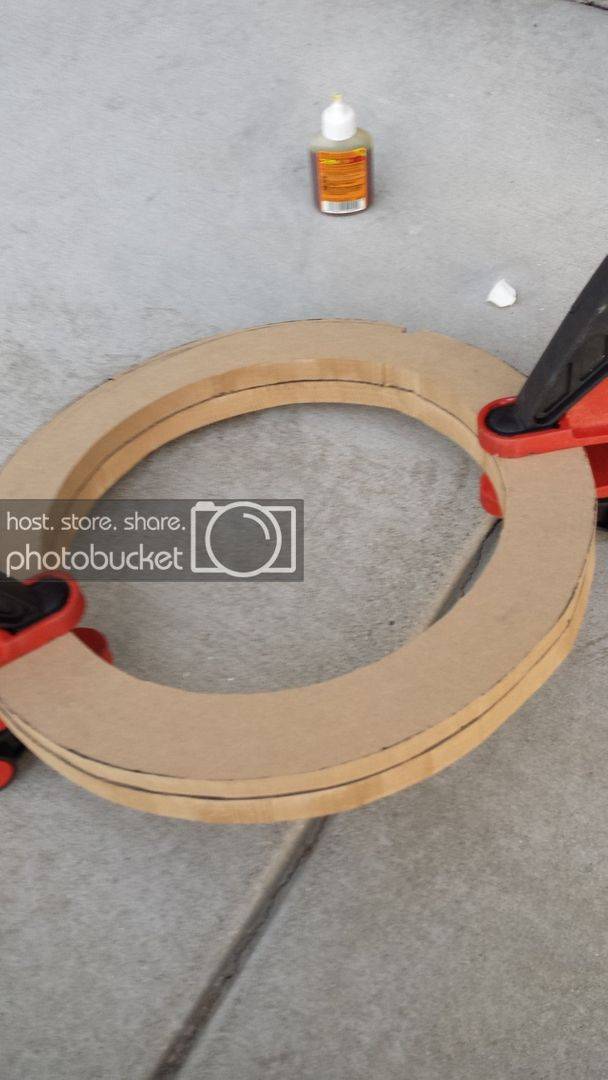

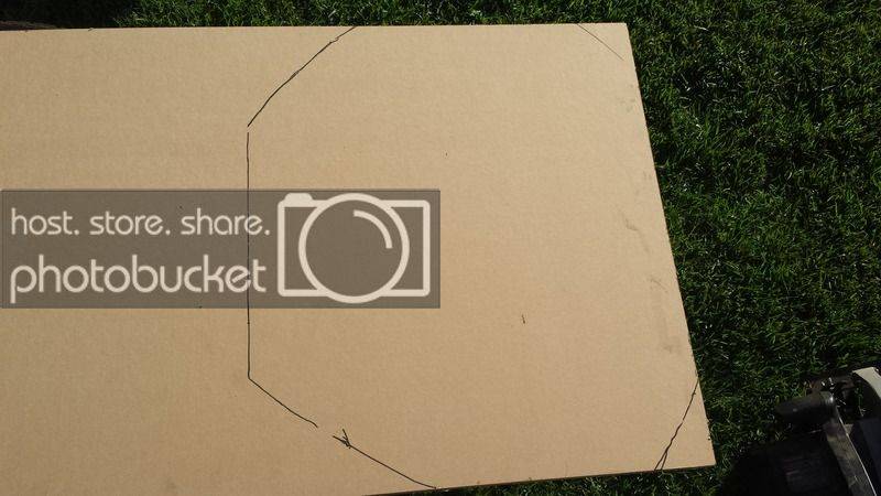

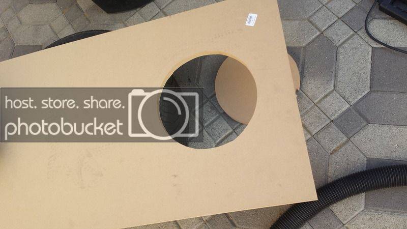

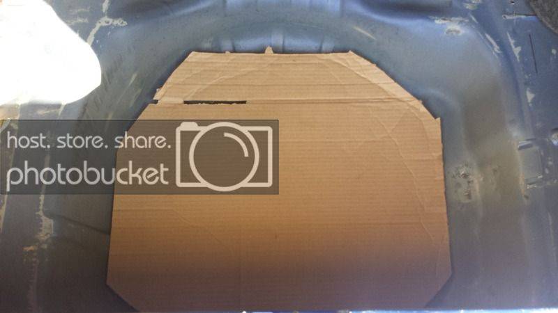

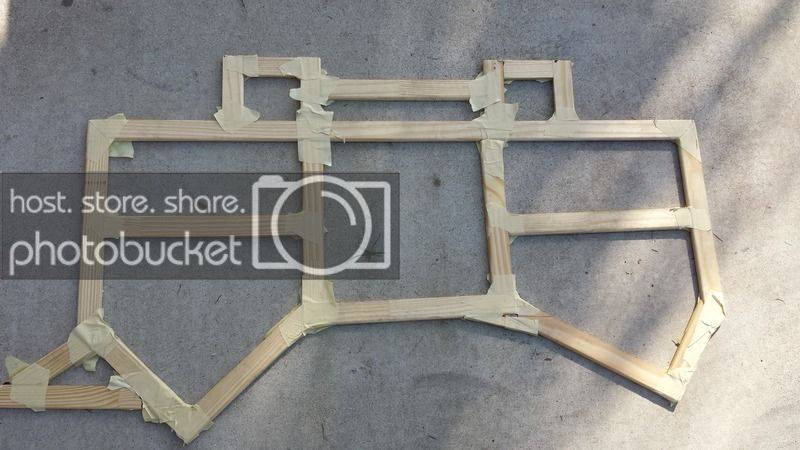

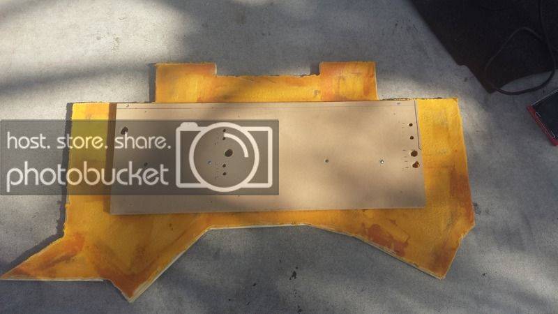

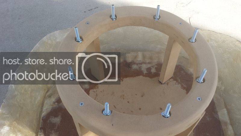

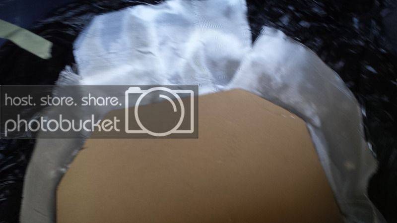

Using cardboard as a draft

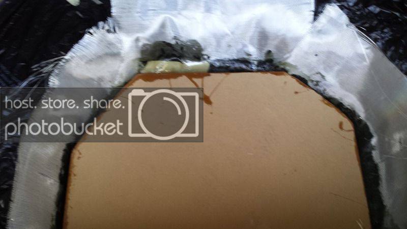

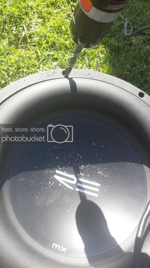

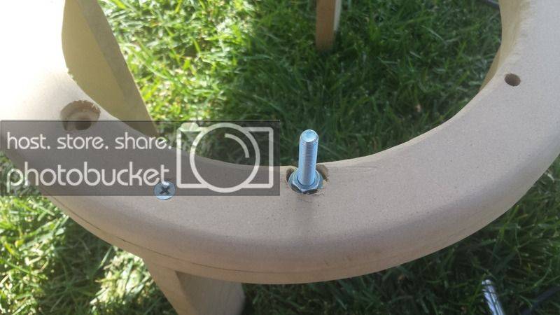

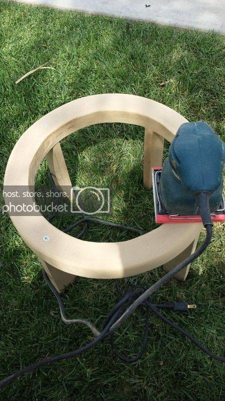

Ready to cut

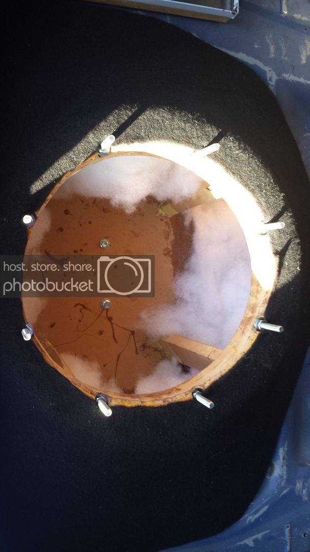

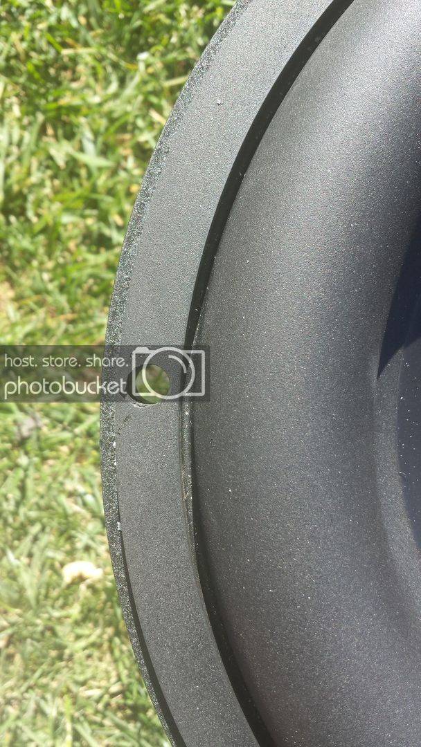

Ring cutout

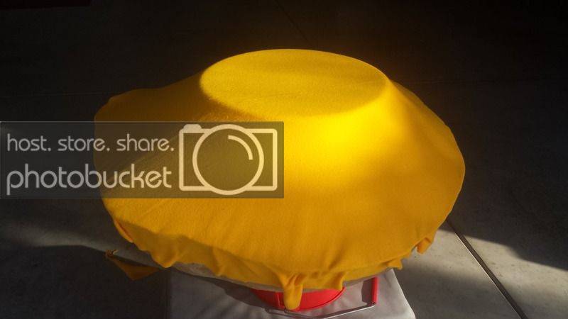

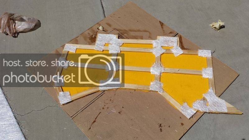

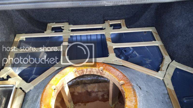

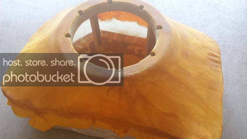

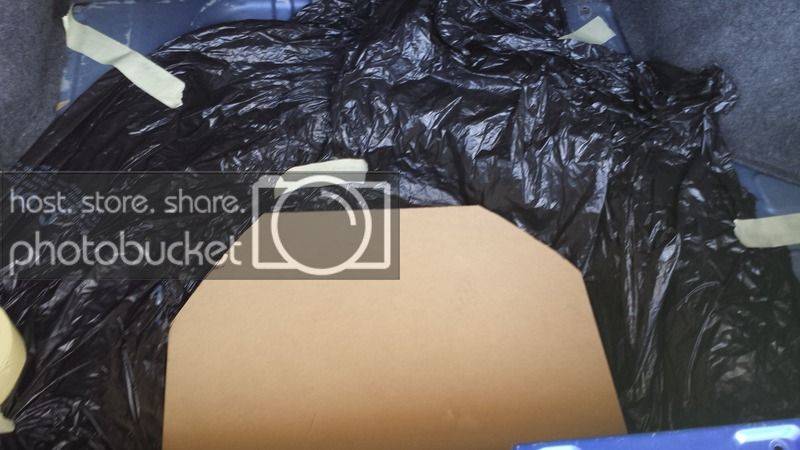

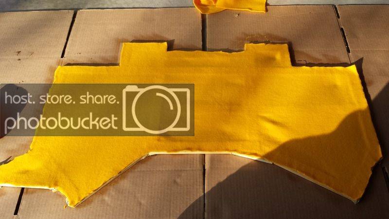

Masking for resin
ready to put resin on.

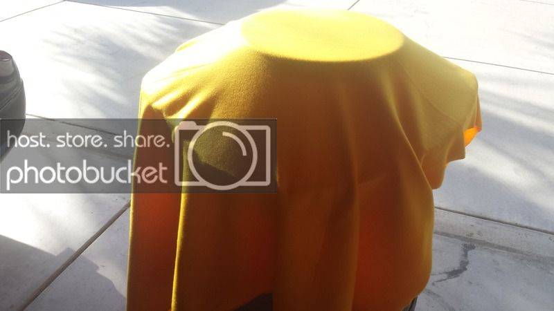

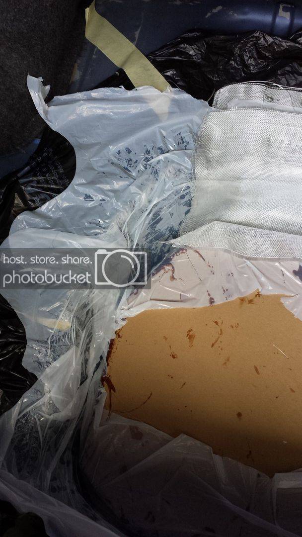

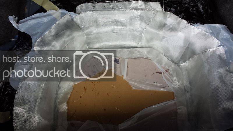

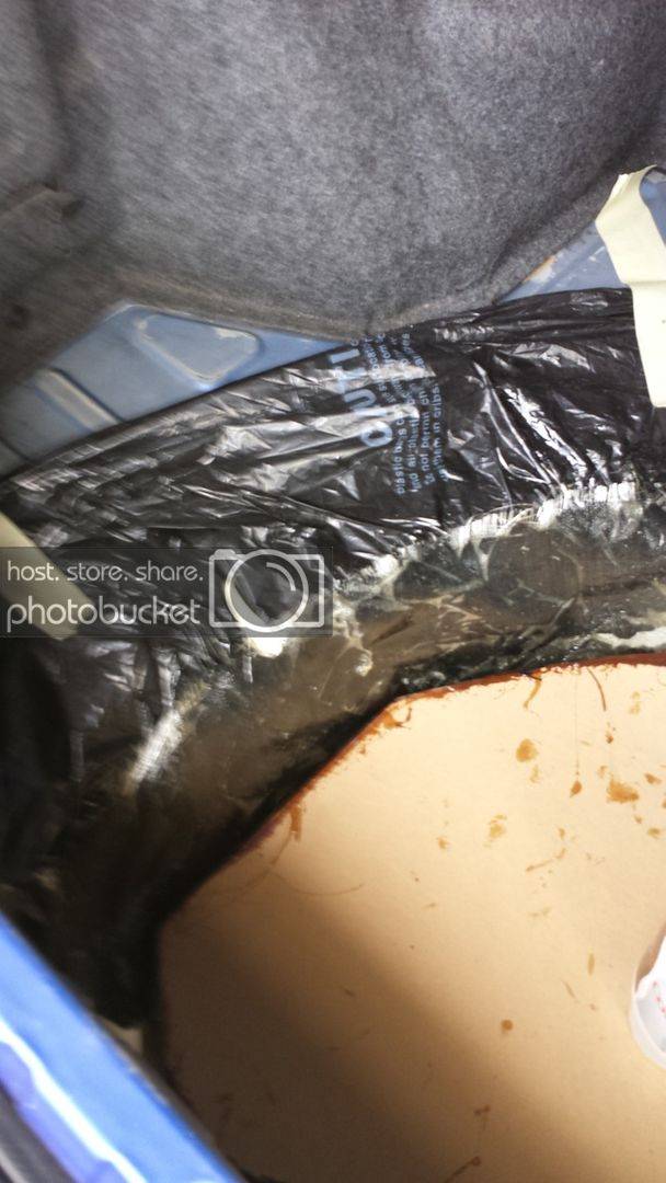

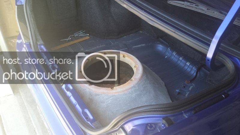

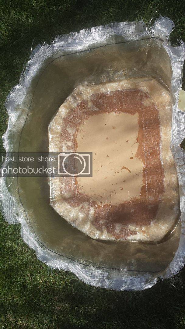

After 3 days of waiting, It was still sticky and it never dried. Found out it was a bad resin that was sitting in the garage for little over year and half. FU*K.
So solution, Put another trash bag over the bad resin and start over.
Once the new resin dry. You can see the old resin is sticky as ***. (Click image to see video)

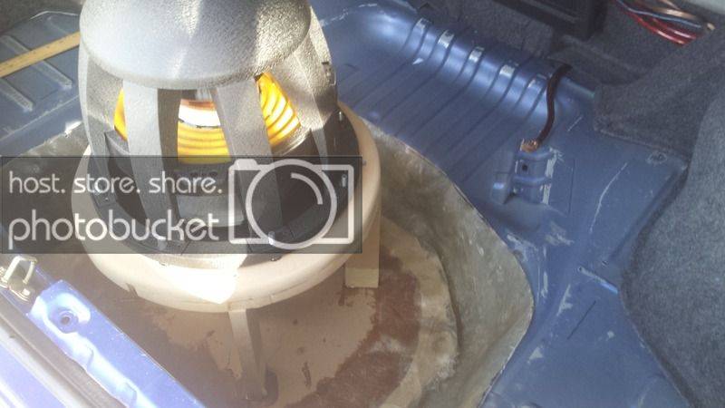

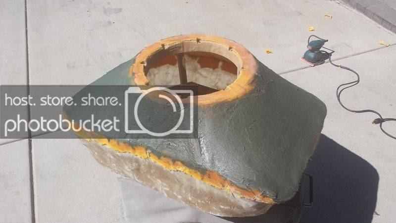

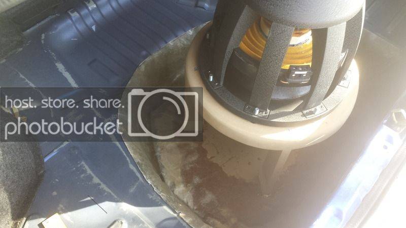

Drew black line to cut off the surrounding.

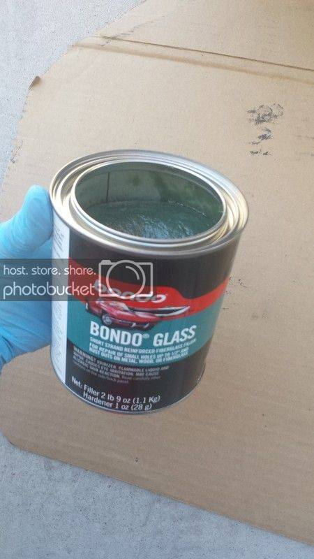

How much do you think it cost you to do the fiberglass (supplies not tools)? I've never tried it myself but want too.
Depends How much cloths, resin, etc you buy. It was under $100 when I did this.

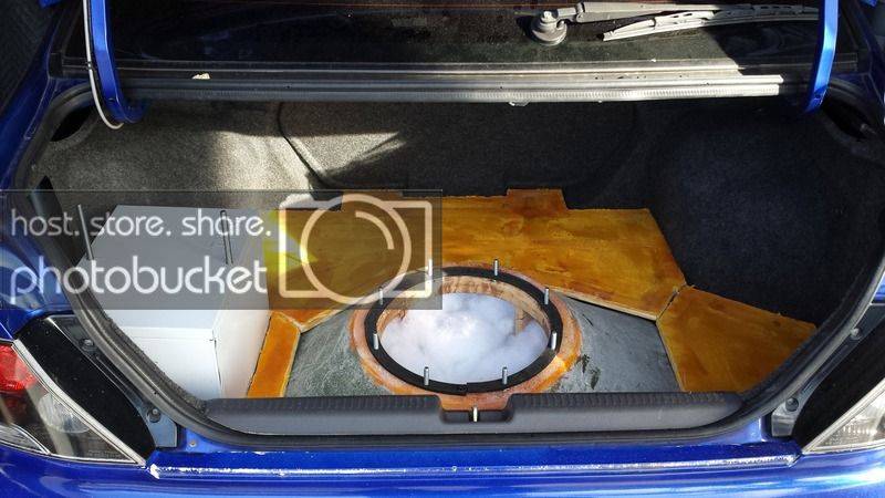

Ever thought about ported it with an aero?
Nah, It's a SQ set up, car show looks.

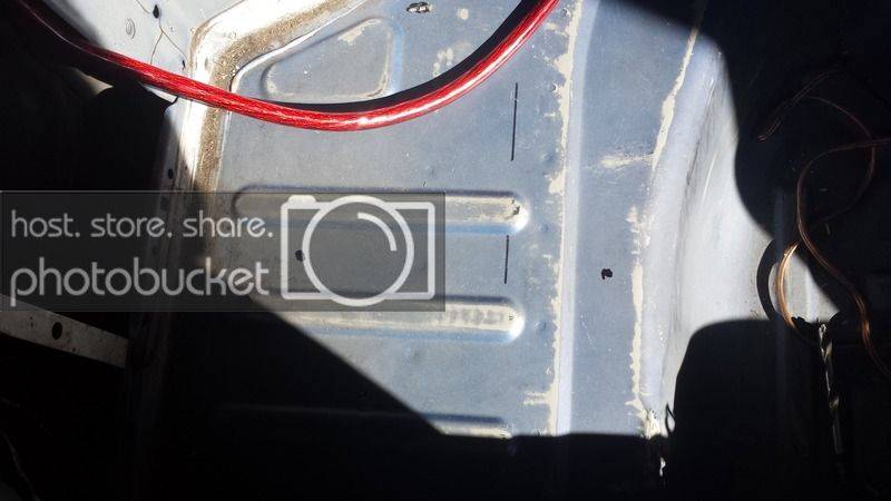

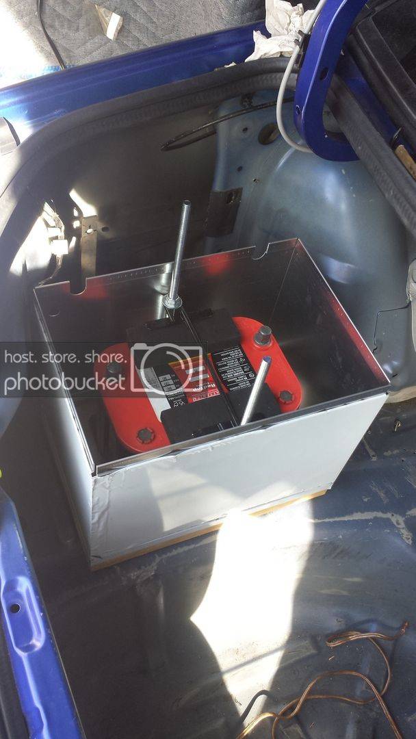

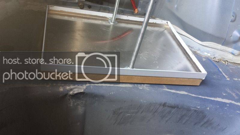

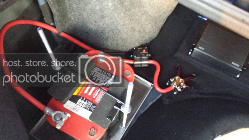

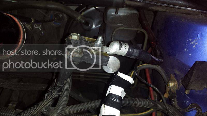

Time to install Battery relocated kit.
Going to put it on left side due right side has Windshield Washer Fluid Tank.
Finish look

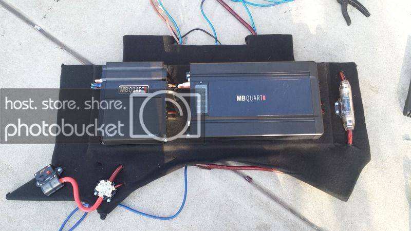

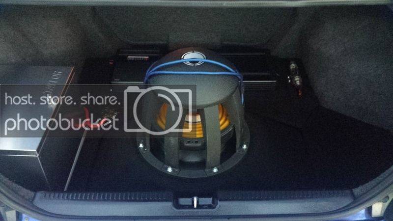

What amp rack looks like.
Screw the box down
Battery hookup

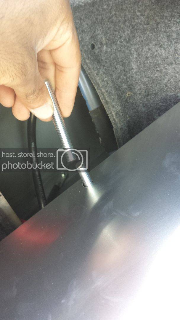

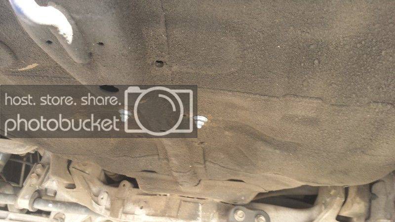

2 gauge wire connect to post where battery use to be
Cut off extra screw
Finish

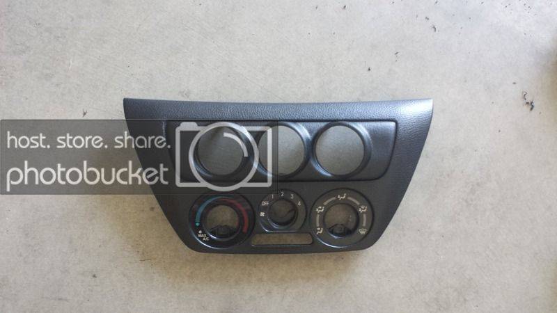

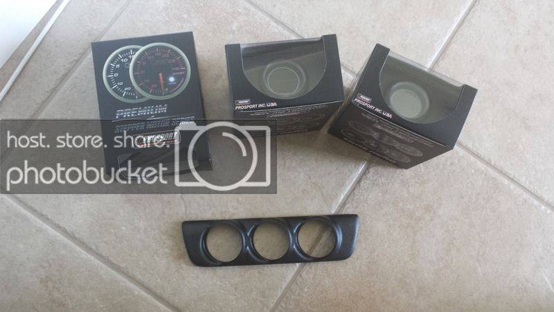

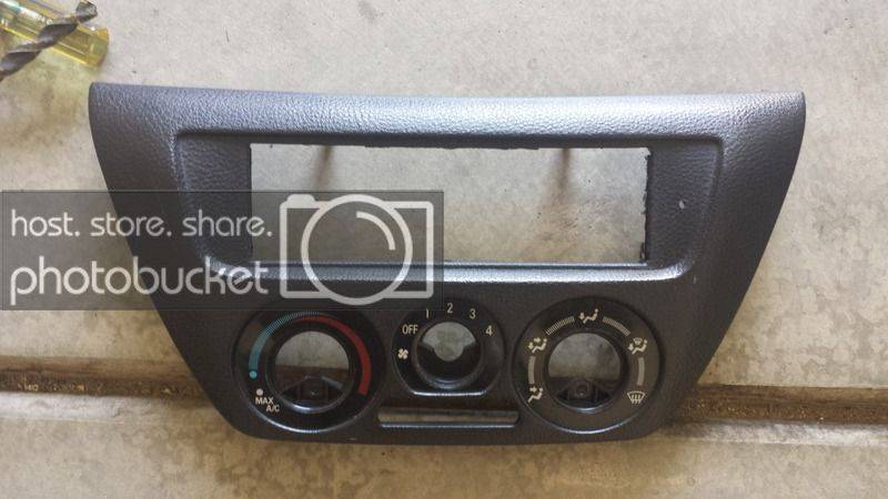

Time to install these.
Volt, Water and Oil Temp by Prosport

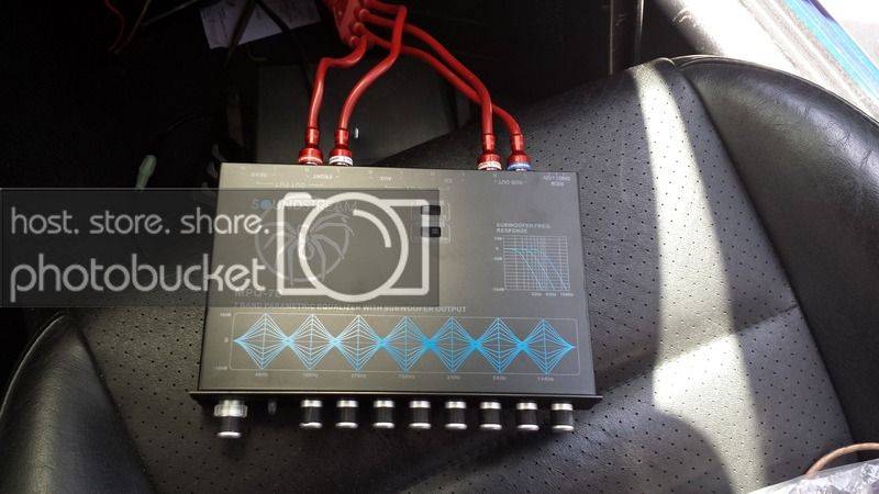

SoundStream Equalizer
Goodbye Headunit
$21 for this sh*t

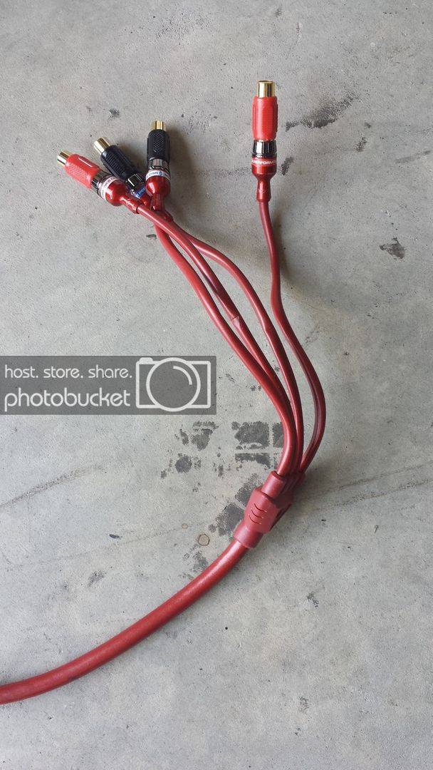

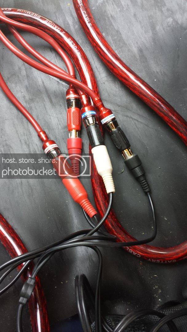

Connected to amps
Other end connected to Equalizer

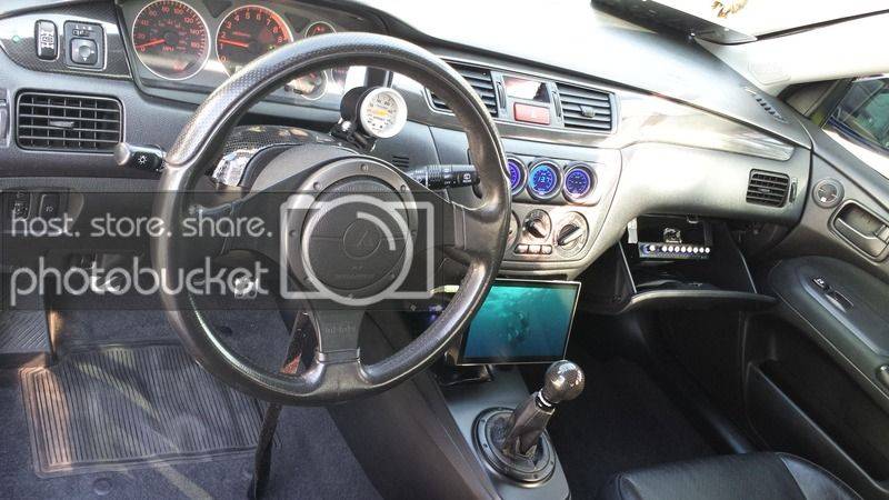

Finish, Equalizer is in glove box & I'm using tablet Venue 8 7840 as my Headunit
