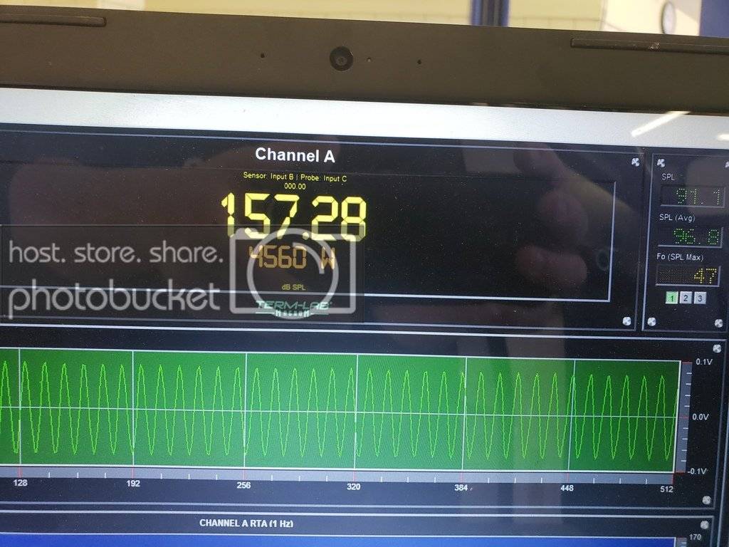

Been a while since I've updated this, so here's a small one. I added a second JY lithium to the setup.
NSPL finals is less than two weeks away, so I've been doing everything I can to get every last tenth out of it.
As of now, it does a 154.6 sealed on the glass, 157.8 in the kick window down, and 156.7 on a 30 second music average (meter in the kick, window down).
I'm pleased with what I've done this season as far as numbers and the build has went.
For those that didn't realize it, all 6 subs, both 9k amps, the 175.4 amp, and both lithiums are all in the cargo area, and I still have a functional back seat.
I'd originally planned to wall it next season, but I'm having so much fun with no wall, I'm going to run it at least one more season before walling.
Next season I'll be starting the season by adding two more 12's, and will be shooting for 160 in the kick and 56's on the glass. I'll start a new build log for that after finals.
Below is a video from the Sundown Audio Show a couple weeks ago.
Here's my finals scores:
157.1 Sealed on the glass
159.7 In the kick, window open
156.9 30 second music average
For finals, I knew I was beat if I didn't do something. So I wired in the dirt. Strapped the amps at .33, so each amp saw .16. Got a lot more power, and a lot higher score.
So pleased with my setup, I'm going to run it another season without adding subs. Will add another 9k amp most likely this year, and run them at 1 ohm daily, and .25 for burps.  Going to try to get a 160 sealed out of it before I change up the setup a lot.
