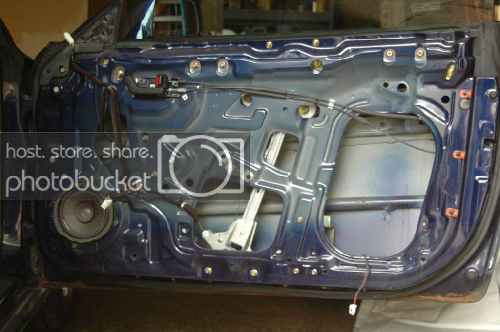

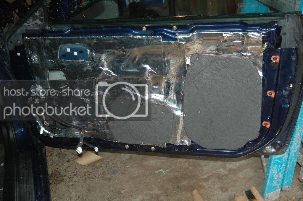

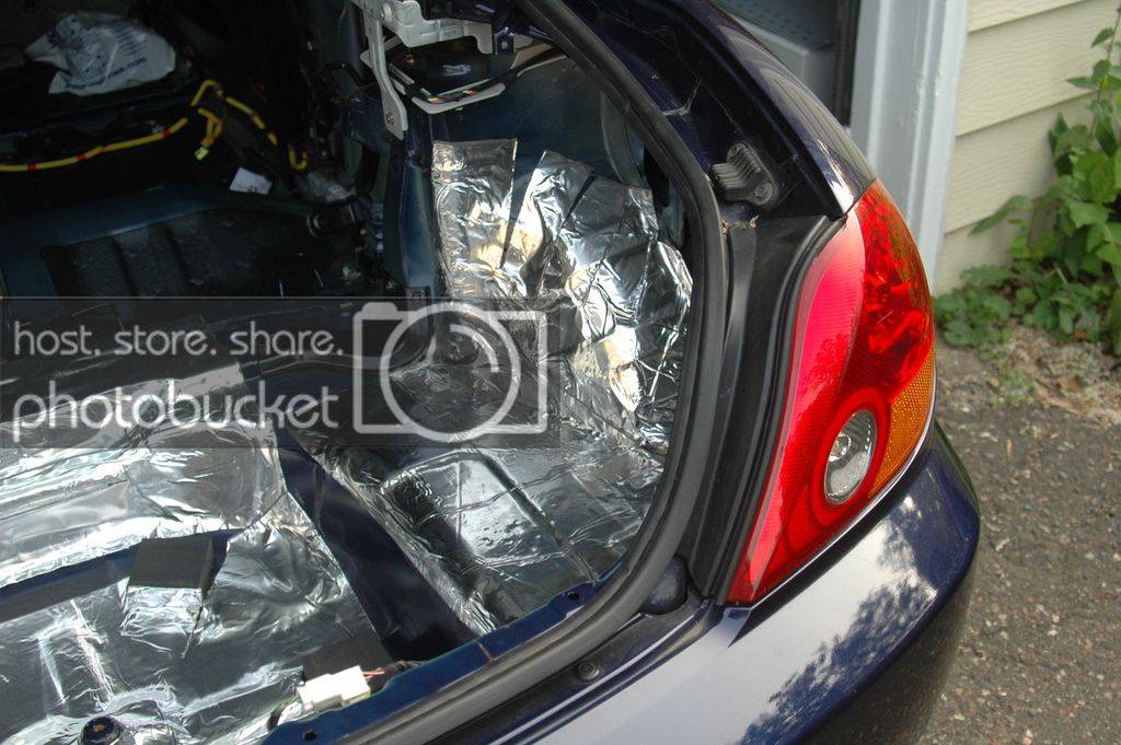

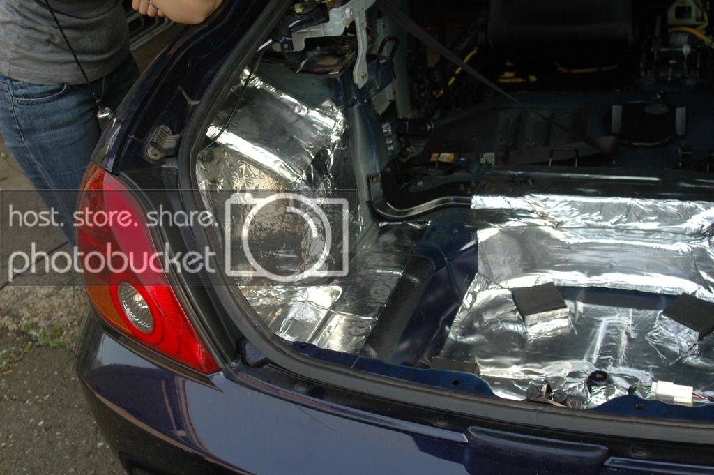

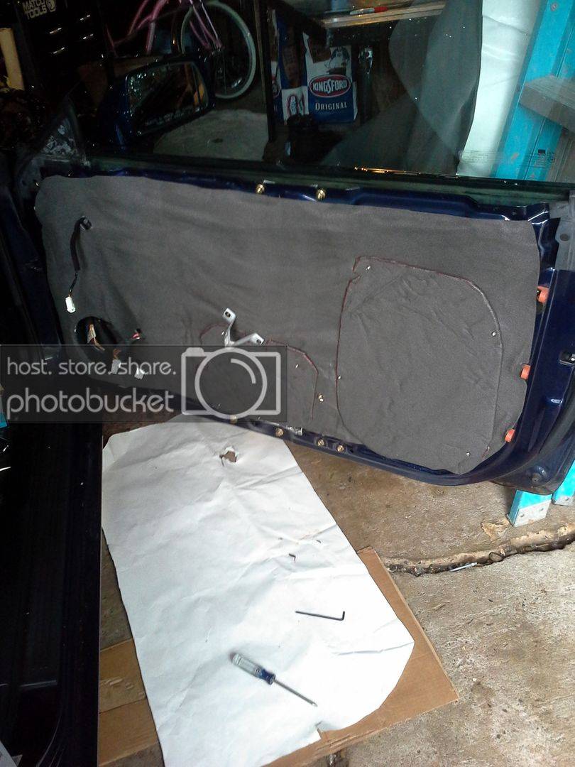

Hey guys this is my first car audio build. Starting with sound deadening the doors and then will move on to the floor and trunk are when my cables come in. This car will take me some time to do since it's my DD and I work a lot. Should keep me busy though.
door with nothing on it

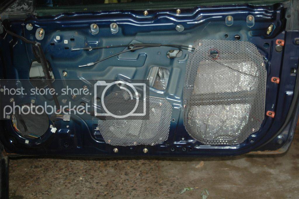

I decided to try to cover up the holes in the door but still be able to have access to them if I ever need to work on the inner door. On the other door the hole I cut out worked well for the door cables but didn't work out like I wanted on this side unfortunately.

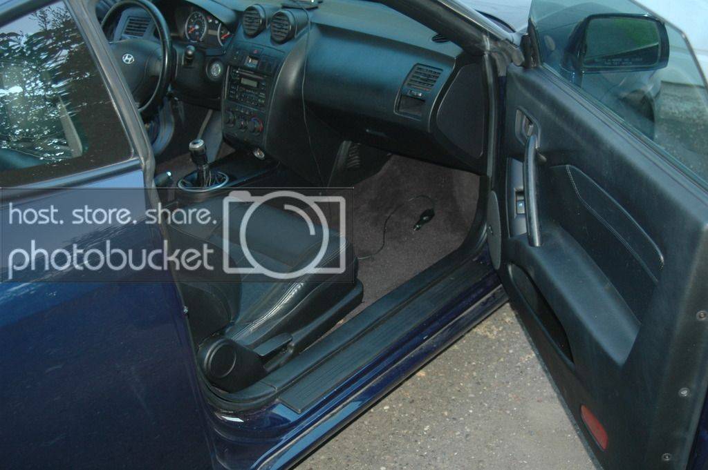

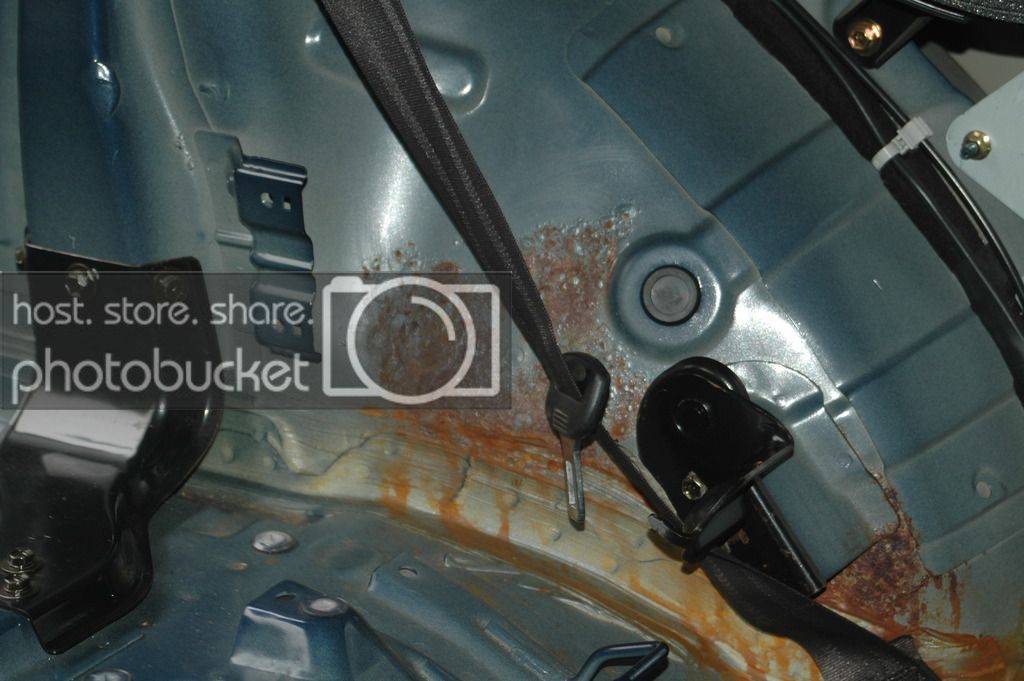

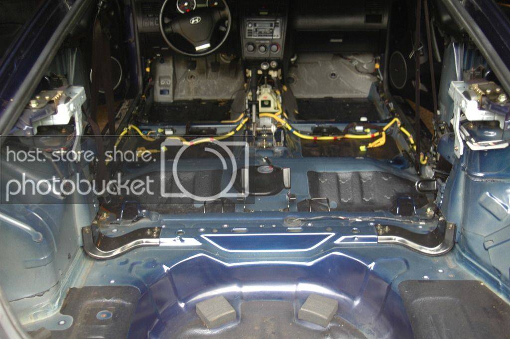

then took out the carpet and all the panels. I found some rust does anyone have a good idea of what to do about it. I also found out that there is a good amount of factory sound deadening in the car already. Should I put more sound deadening over it or should I leave the floor alone for the most part?

is the rusted panel painted and an exterior panel? if not, id ensure its not a structurally important piece and id sand the absolute **** out of it and get every last bit of rust off then paint over it with black paint and then put some of that shiny AC tape on it.
rust *****, get rid of ALL of it from that metal or it will continue lol
It is on the interior but not on something that is supporting a lot of weight. I was thinking of wire wheeling it down and paining over it with some auto frame paint. I'll put some of that AC tape on it. Thanks for the tip!
what kind of shitt is that.
grind the rust off and buy some por-15 its not cheap but the best out there.
it will convert the rust to a paint able surface .
but you can just leave it with the por-15 .
stuff is great.

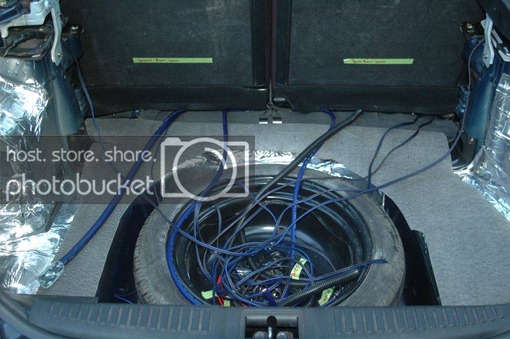

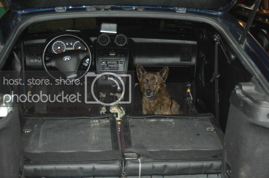

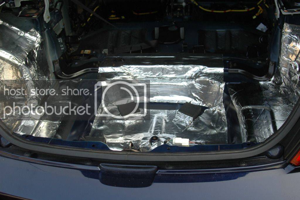

Sorry no photos today but I did get my front door speaker wire through. There was this big square harness that wouldn't let me just pull the wire through and it was in a really tight spot so I ended up having to remove the door to get at it and open up a space right under it so I could route the wire through the factory boot still. Took a while but I eventually got it and I cant see the wires so I'm happy with it. I also installed my inline fuse on my zero gauge wire today. Something I though would maybe take ten minutes at the most was a lot more of a pita then I thought it would be. I also got my 6.5 into the factory 6x9 speaker area for my rears so I was pretty happy about that.

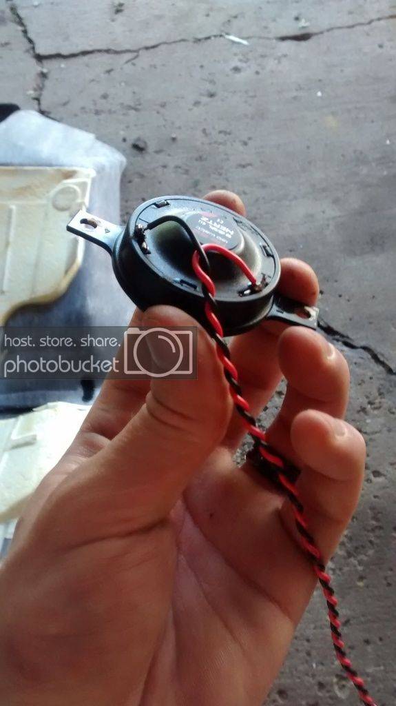

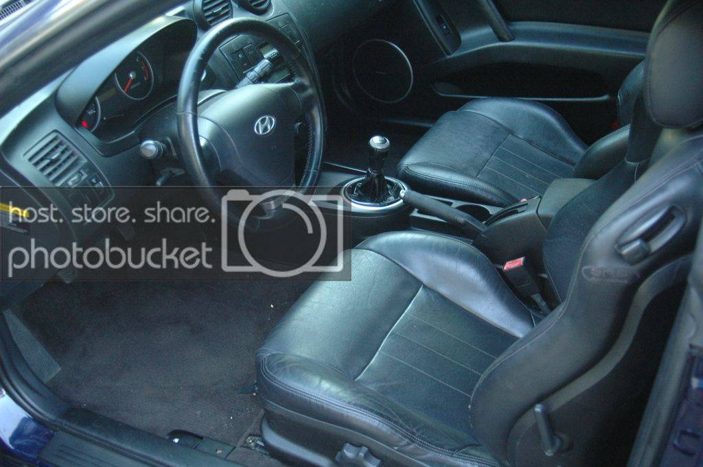

I got all the wires ran today and got the interior back together accept for the trunk. I'm still trying to decide if I want to put the amps on the floor or the rear seats since the seats have this weird plastic type backing to them. I can't tell you how happy I am to have the interior back together though the car should be much quieter now with all the deadening and the floor back in. We will see. I was able to repair all my tweeters as well so that was cool and I mounted the rear cross overs in the rear fenders so hopefully I wont need to get at them to much.
