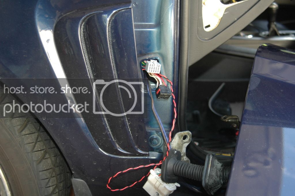

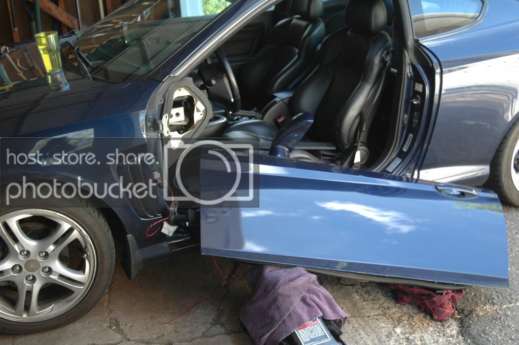

Today I took my door off to run one small wire for the tweeter haha. In order to get in the small space to run the wire to door had to go. Yeah I know sounds stupid and it is but that is what had to happen. I got it though and decided to put my crossover inside the door since the panel doesn't leave me much space to mount it there sadly. I didn't have another person with me so I ended up using a floor jack to hold the door up and let it rest on the floor while I ran the wires.
