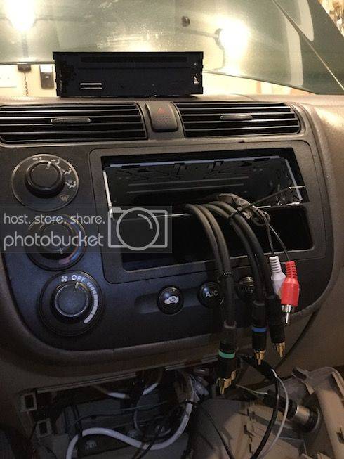

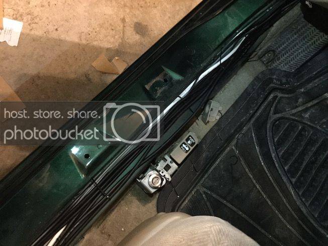

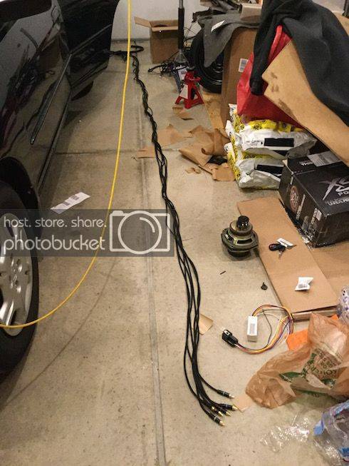

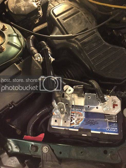

Little bit more work done last night. Power and ground with lugs on in the front.

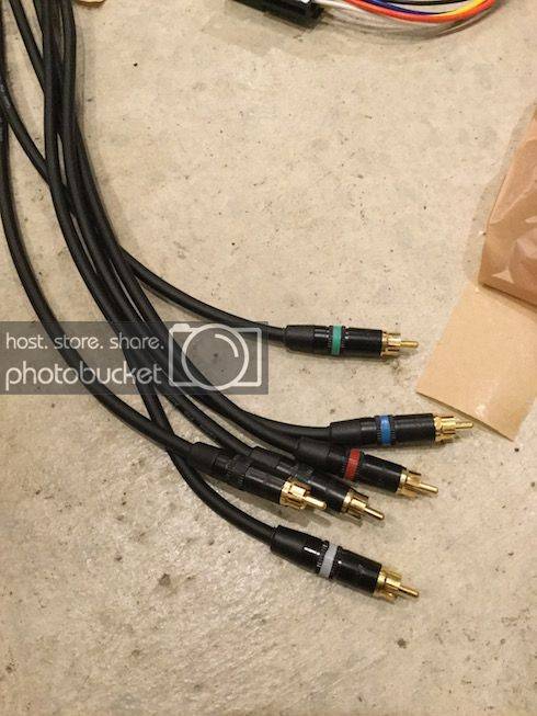

SounDrive rca's
Speaker wire, amp turn on relay and voltmeter relay maybe tomorrow.

Little Update: PPI 900.4 had a problem but seems to be doing fine but still am going to move it to the interior. Alt belt continues to slip even at 2k rpm with anything past halfway on the lc1, Ill be ordering a continental elite (goodyear gatorback) 39.5" soon hopefully to get it a little tighter. From about 35hz and up I am getting concerned for the subs, might be bottoming out but Its hard to tell when I have to keep my foot on the throttle for the belt not to slip at that level. I can smell them slightly after a few minutes but the cones/ dustcaps don't get that warm, Ive had others much much warmer.

Update: Swapped alt belts again, 39.5" this time gatorback. Absolutely no noise so far. Subs are getting warm fast, slight smell to them after a little while but Oscope confirms a clean signal. I can not figure out why these things are reaching mechanical limits as fast as they are. Winisd plots them at just under 23 mm of excursion with 4k as the input signal. Going to double check the interior of the boxes and probably put some wood in to get them closer to 2 cubes.
The stock belt is 38.8 inches. I'm assuming the singer 320amp alt has a smaller pulley than stock, like the singer 260amp I have does? On my Civic, I went with a 38 inch belt and it fits perfect. Still, I get a little belt squeal at startup, but that's it.
Also for what it's worth, a group 34 will fit in the stock location. I know it may be a little late for that, but if you want something bigger under the hood in the future.
