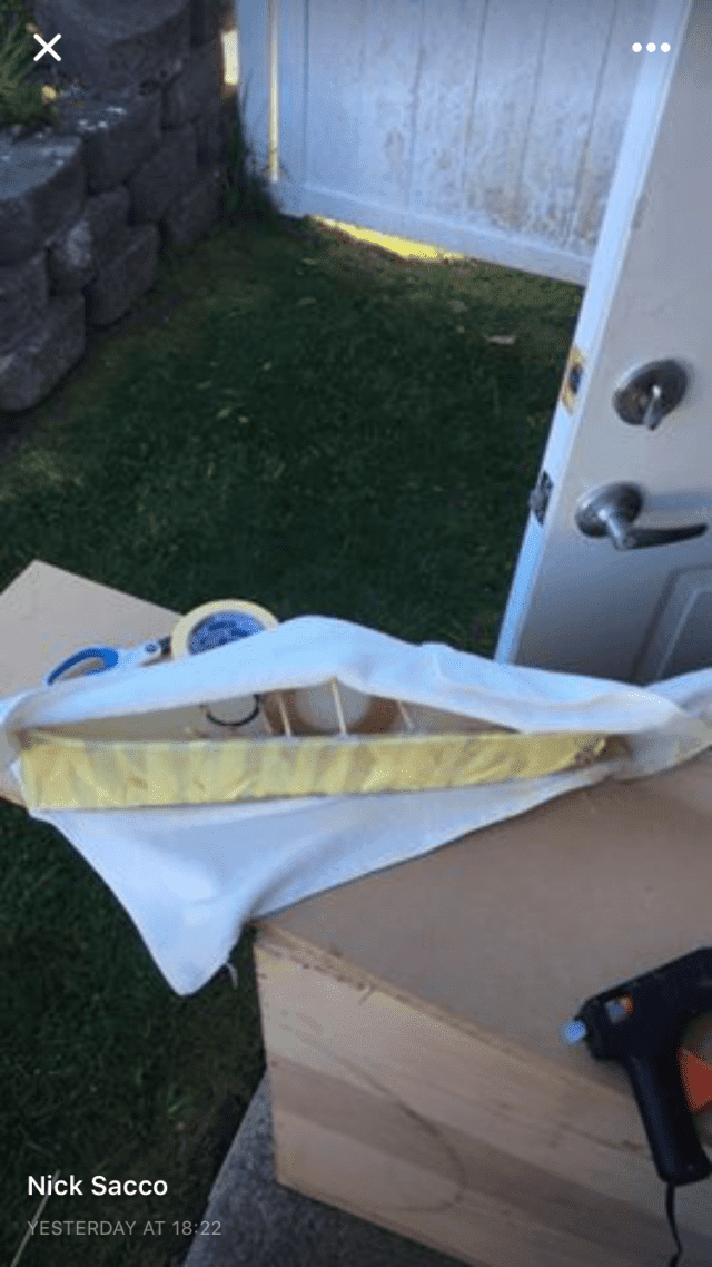

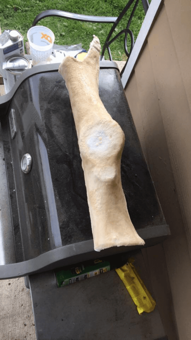

Life has caught me by the balla but build is still continuing. C-dsp is in along with all new rcas. Addictive audio elite 3 way components in as well. Next step is glassinf my a pillars and deadening the passenger door and roof, I have a bunch of screws knocked loose from my hybrid 15. Cscstang built me an enclosure that's 3.5 net @ 32hz, but for some reason doesn't like playing lower than 34 and plays up to 80-90 cleanly... so maybe in the future I'll be doing a blowthrough 6th order. Will take pics once the pillars are done.
I also plan on adding 2 more trunk batts and making a presentable amp rack, once I get the 6th order installed.
Life has caught me by the balla but build is still continuing. C-dsp is in along with all new rcas. Addictive audio elite 3 way components in as well. Next step is glassinf my a pillars and deadening the passenger door and roof, I have a bunch of screws knocked loose from my hybrid 15. Cscstang built me an enclosure that's 3.5 net @ 32hz, but for some reason doesn't like playing lower than 34 and plays up to 80-90 cleanly... so maybe in the future I'll be doing a blowthrough 6th order. Will take pics once the pillars are done. I also plan on adding 2 more trunk batts and making a presentable amp rack, once I get the 6th order installed.
