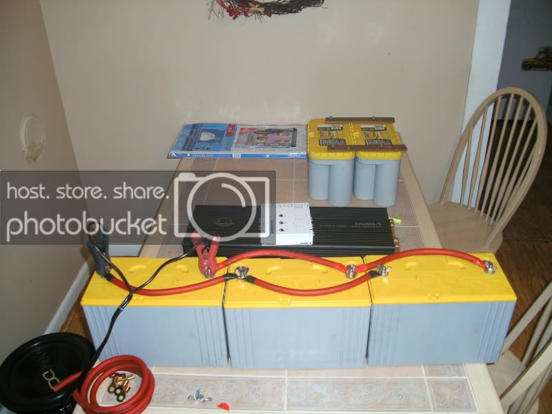

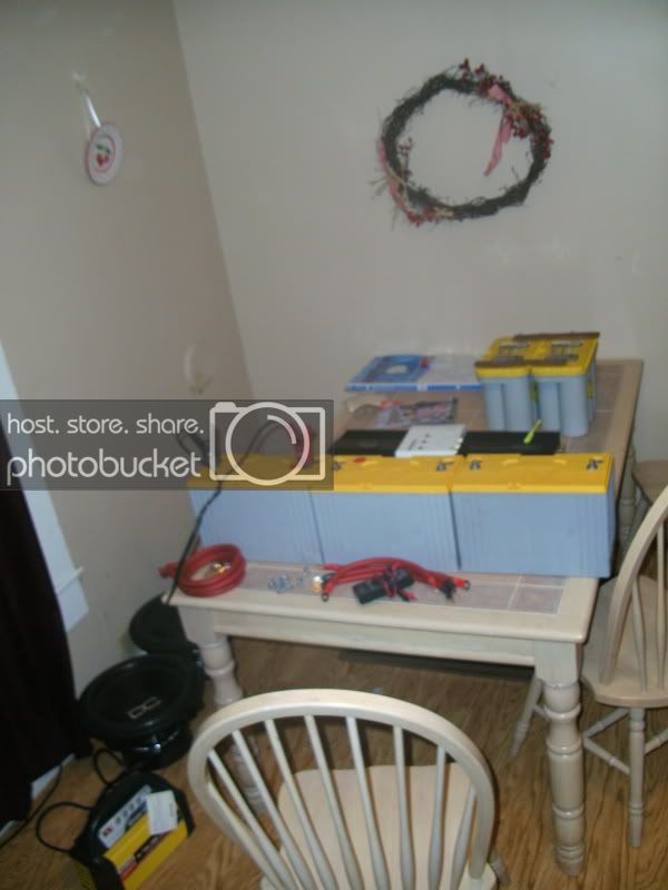

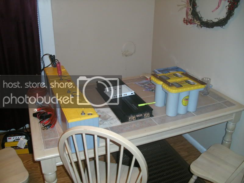

well...i got 1 up front .....had to rim some stuff....and it is kinda sideways b/c my wires werent long enough..... but now i only gotta get me a bungie cord to strap down the battery //content.invisioncic.com/y282845/emoticons/smile.gif.1ebc41e1811405b213edfc4622c41e27.gif......i really wish i would have done what my friend said...leave the yellow top up front....for starting the car ...run my power wire from alternator back to back 3 batteries.... the way i am gunna do the setup now is ....have 2 barreries in a line along the back seats...then have my bass amp directly in the middle..... now i just gotta find the time to do it ...here i got friday-sunday off but saturday i am going to SBN ...( not taking my car).....so i have to find time someday this weekend...might do it friday....if i can get some 1/0 wire here by then....
**** thats ugly!!!!!! ^^^^^^ lol i had to put the optima back in there haha... 3 dekas in the rear coming this weekend...
well..i finally got my amp and subs and box out...now i just gotta get batteries out and plann on how everything is going back in //content.invisioncic.com/y282845/emoticons/smile.gif.1ebc41e1811405b213edfc4622c41e27.gif......but it wont quit freaking raining....hopefully sunday i will have all day to finish it all up....
got the batteries wired up....now if my measurements add up correctly....3 dekas across back of seat....and IA 40.1 in front of them flat in the middle.... with line driver on the right or left side //content.invisioncic.com/y282845/emoticons/smile.gif.1ebc41e1811405b213edfc4622c41e27.gif.....pictures will be up in a few... stay tuned...
i finallly got it all put in...this is how it is gunna stay for a while...sooner or later i am gunna take the speakers out of back dash and back deck and put a piece of black metal mesh across so i can have it all as a port....and put the speakrs in the doors...i hardly have any room for air to move into cabin...but it still hits lol....cant really tell a difference in the voltage ....b/c i really thank my factory alt is like toast.... the new alt should be here by friday //content.invisioncic.com/y282845/emoticons/smile.gif.1ebc41e1811405b213edfc4622c41e27.gif
