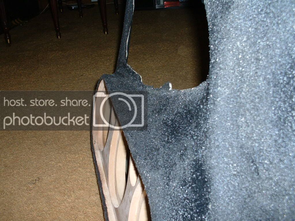

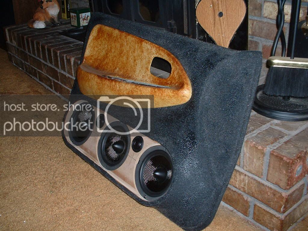

ok everyone I know it has been a few weeks on updates. With the holidays and bad wheather I have not had that much time. I did have a break in the wheather today so I did manage to get one of the doors wraped and ready glassing. Once I start the passenger side door I will take more photos of the process for ya.

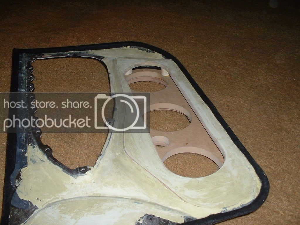

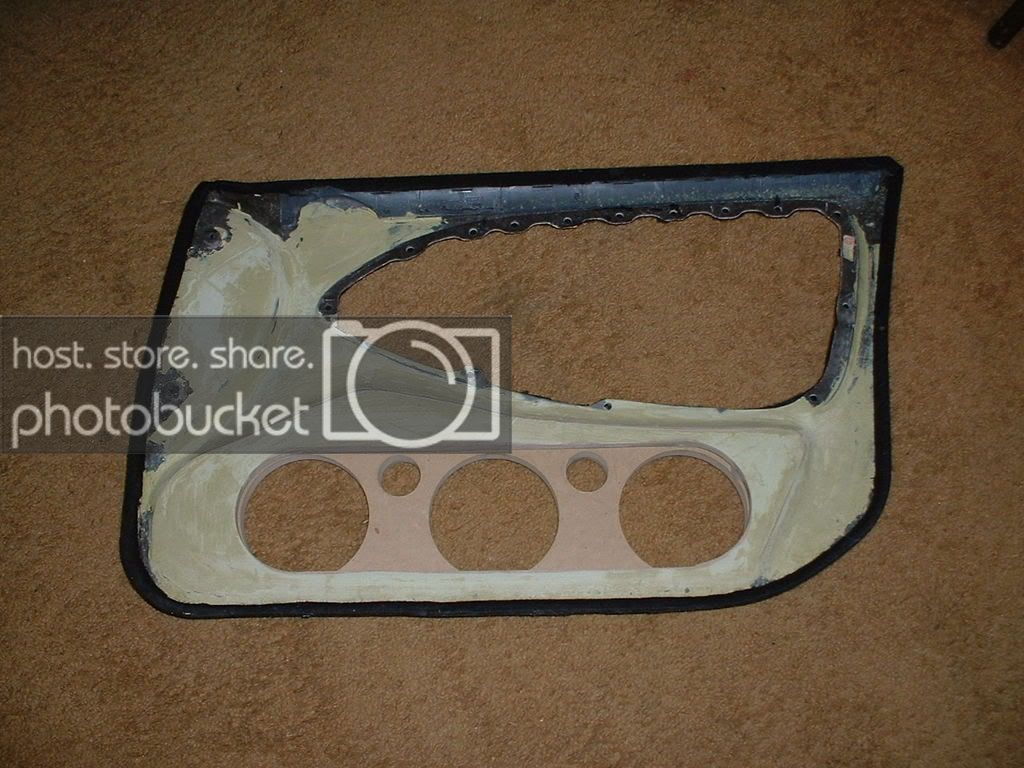

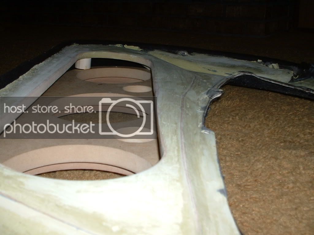

This is the door panel brace that I made last time all molded into the door. I bondoed most of the back side of the door panel for strength.

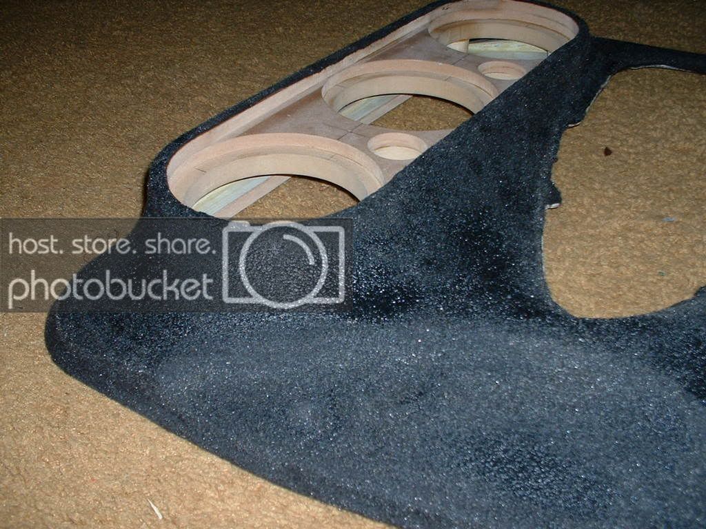

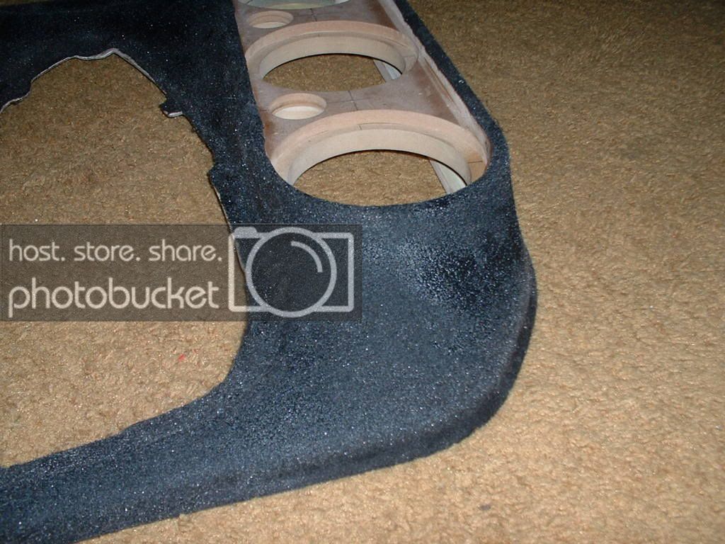

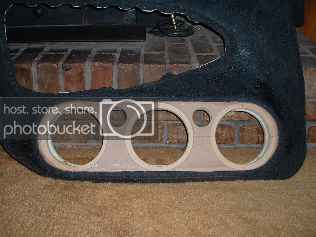

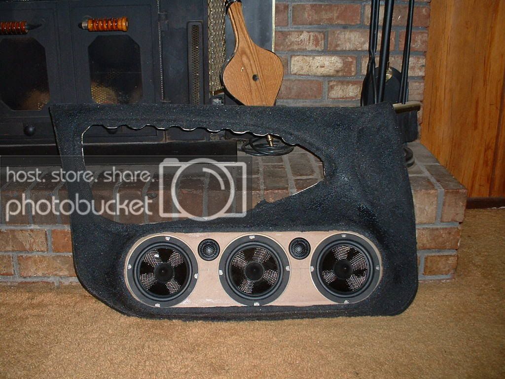

Here is the speaker baffle mounted to the door panel and wraped. I first removed the factory vinel form the door and the window weather stip off the door. I then took some flease and glued it do the door panel to fit all the contures. After that I applied resion to harden up the flease. Next week I will be glassing and finnishing up this door panel.

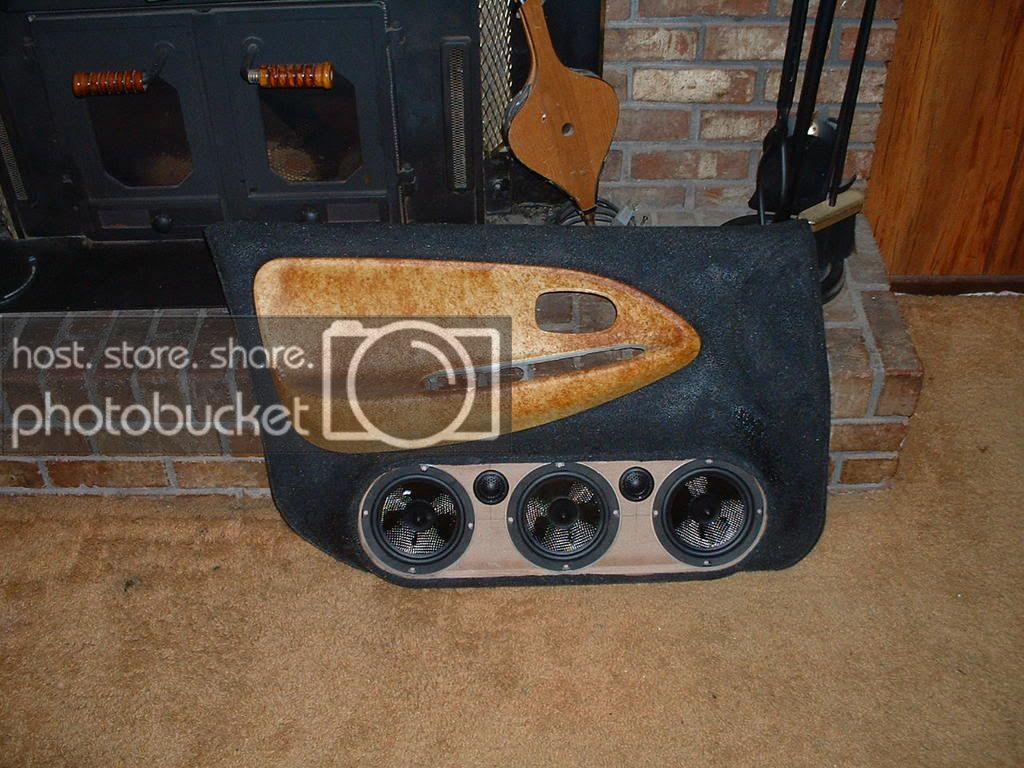

With everything in the door.
