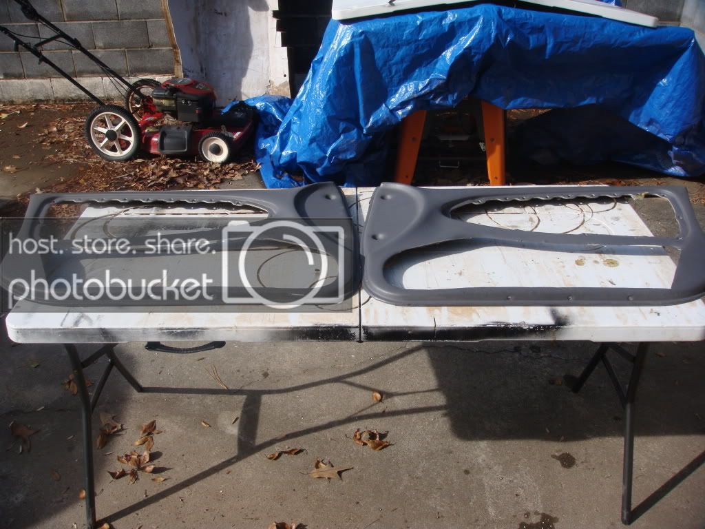

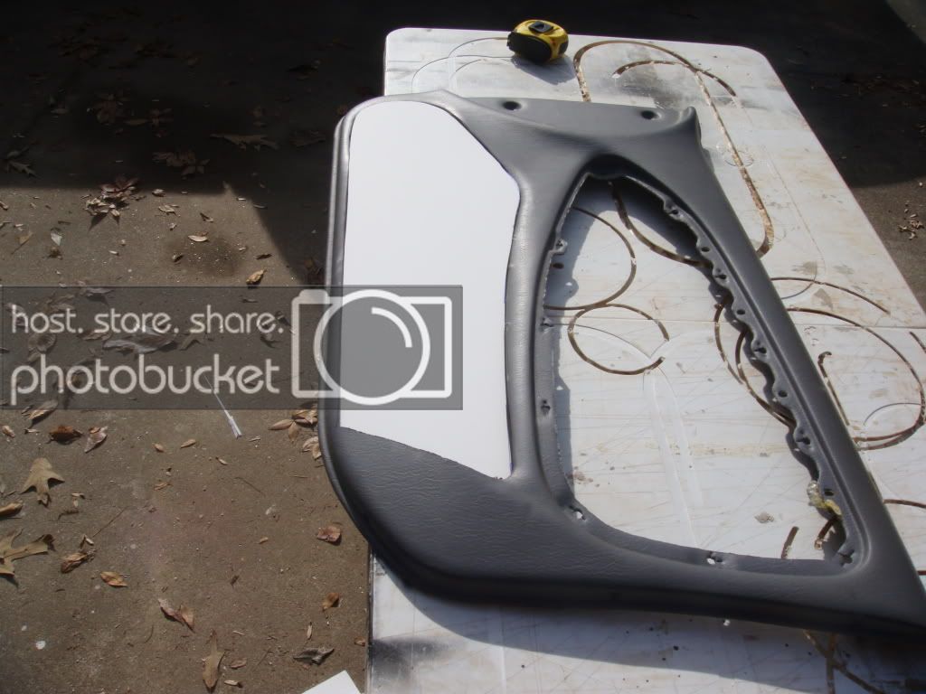

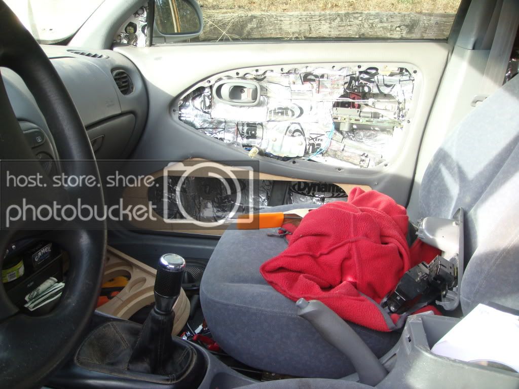

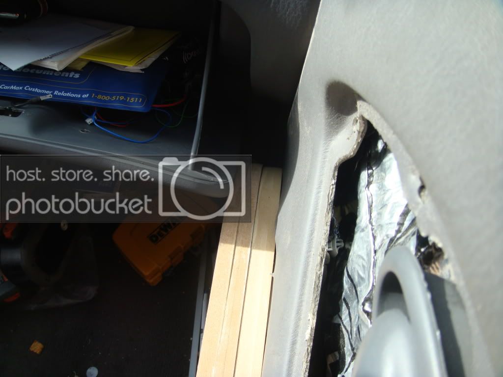

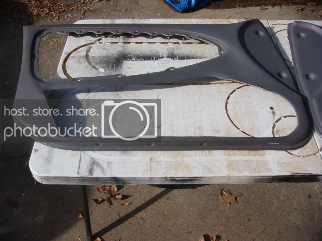

These pictures are of my door panels cut out which I did a few days ago

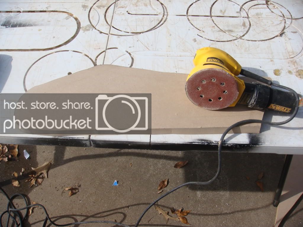

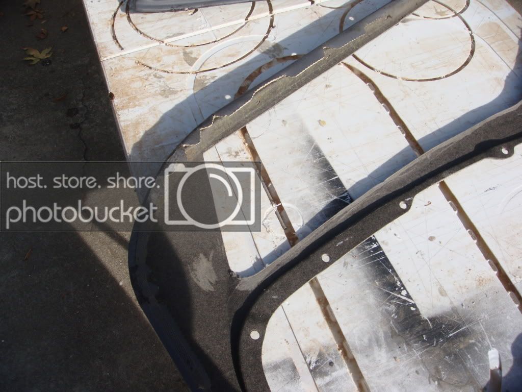

I grinded all the plastic down so that when I build my supports they will rest flush on the door panel.

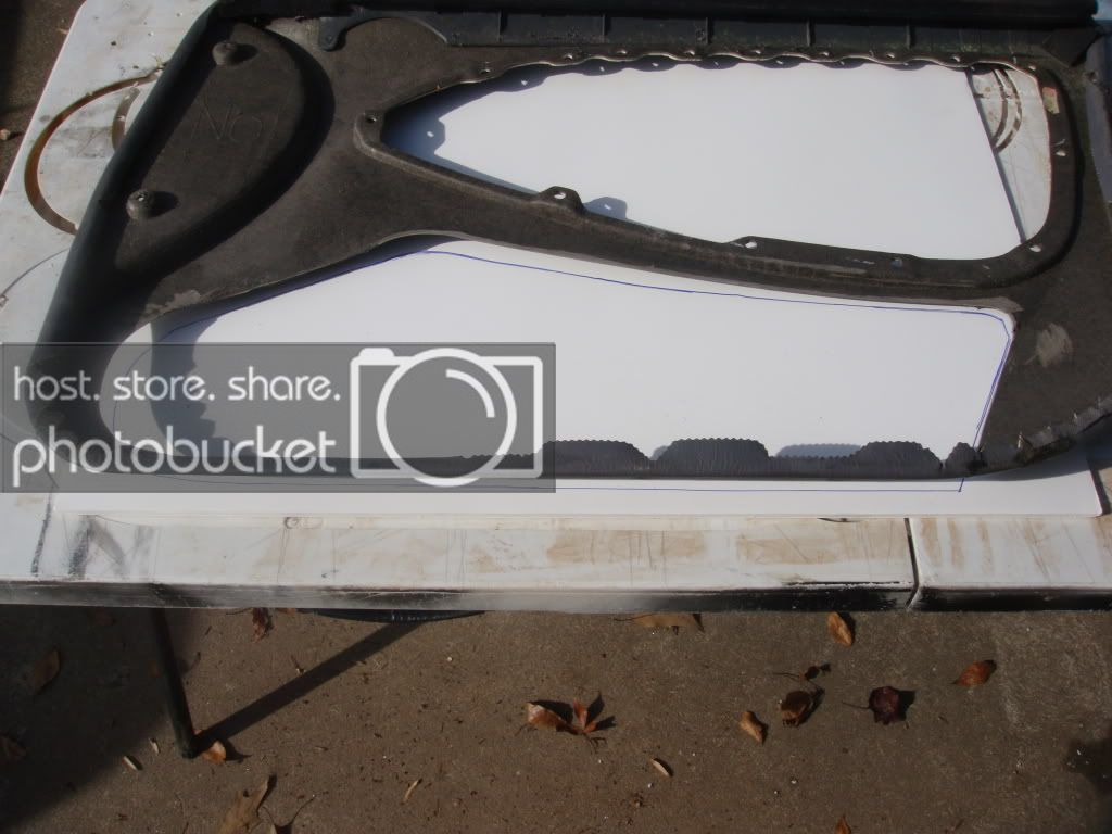

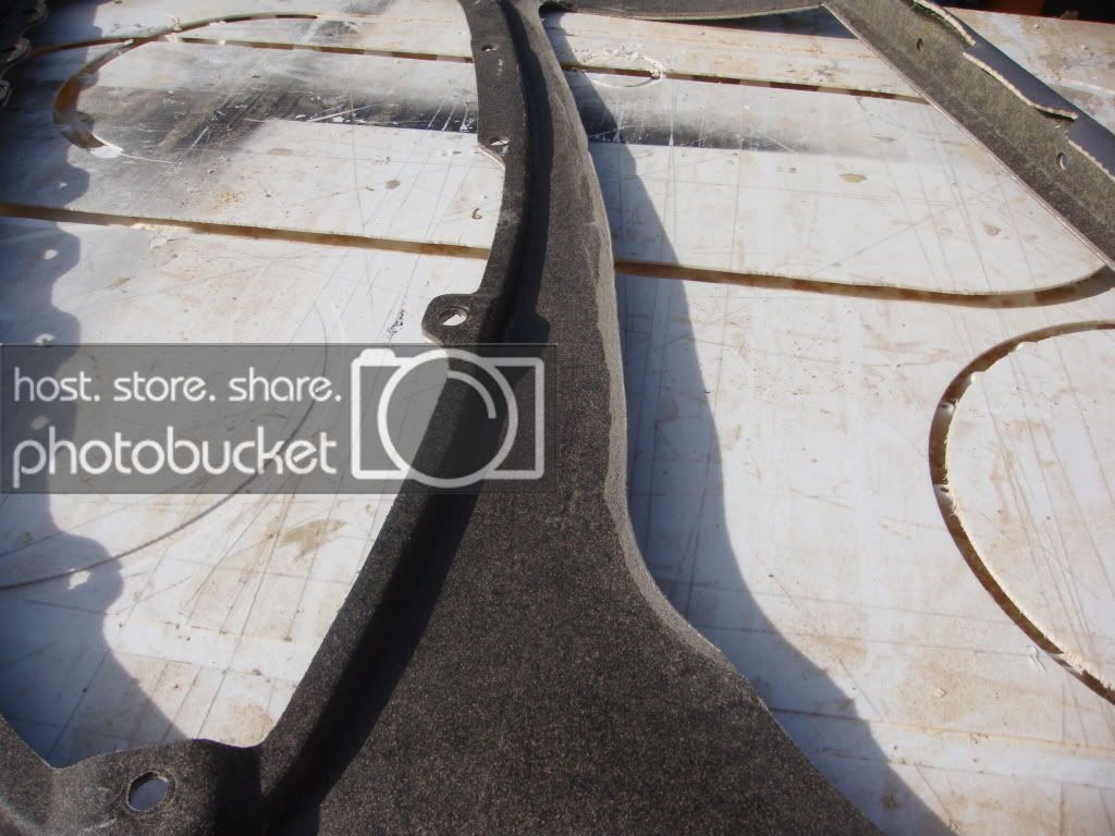

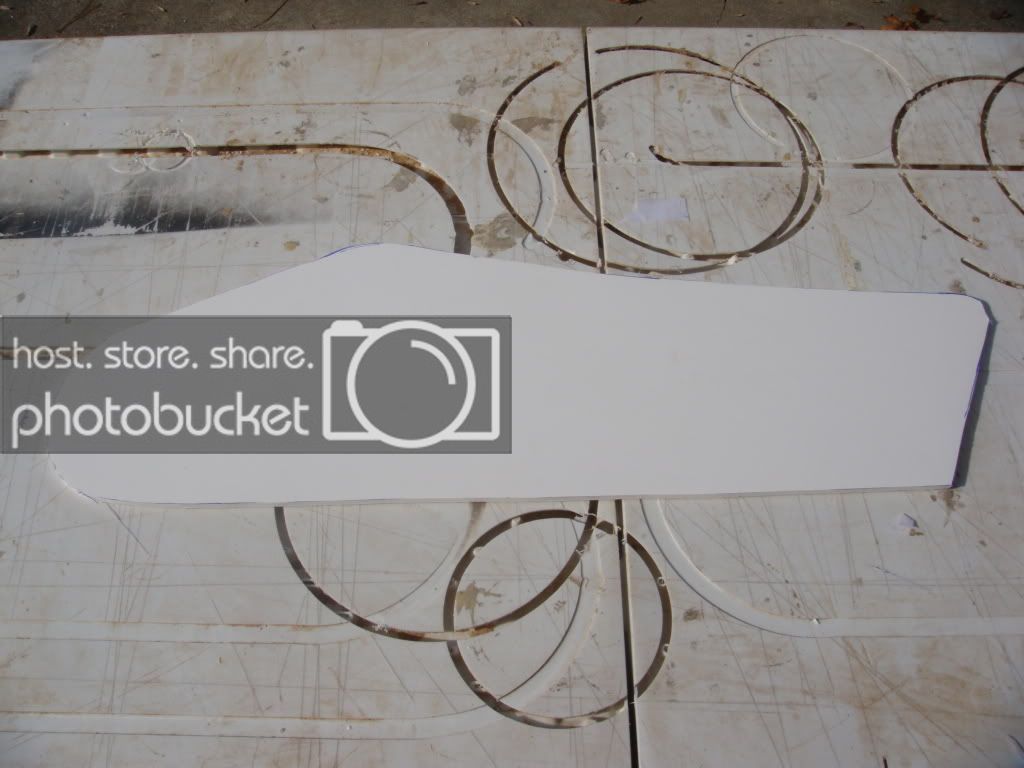

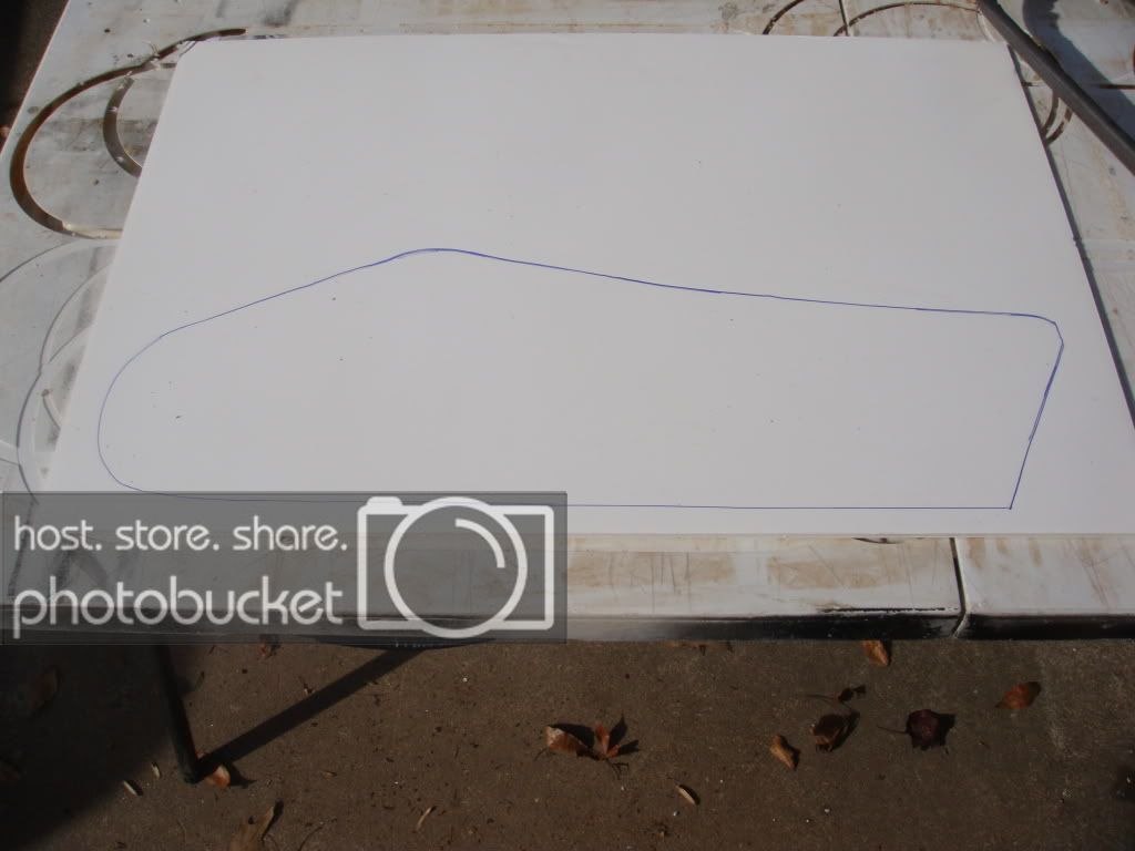

Here I am about to trace out the opning I cut into my doors so I can get the sape of it and make a baffle to mount the speaker baffle to as well as help give support to the door panel.

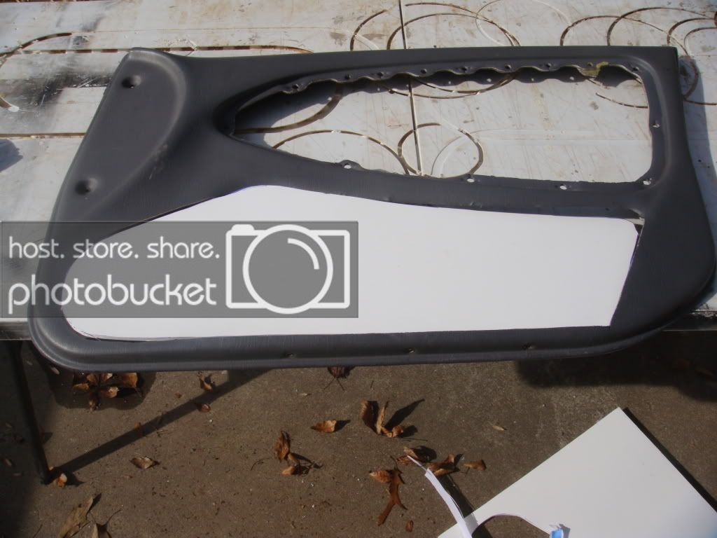

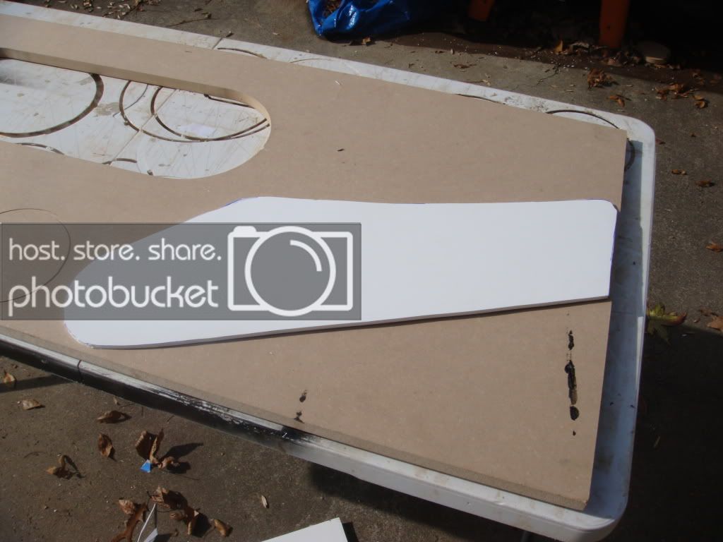

Got the shap all traced out on 1/4" foam core.
After it is cut out

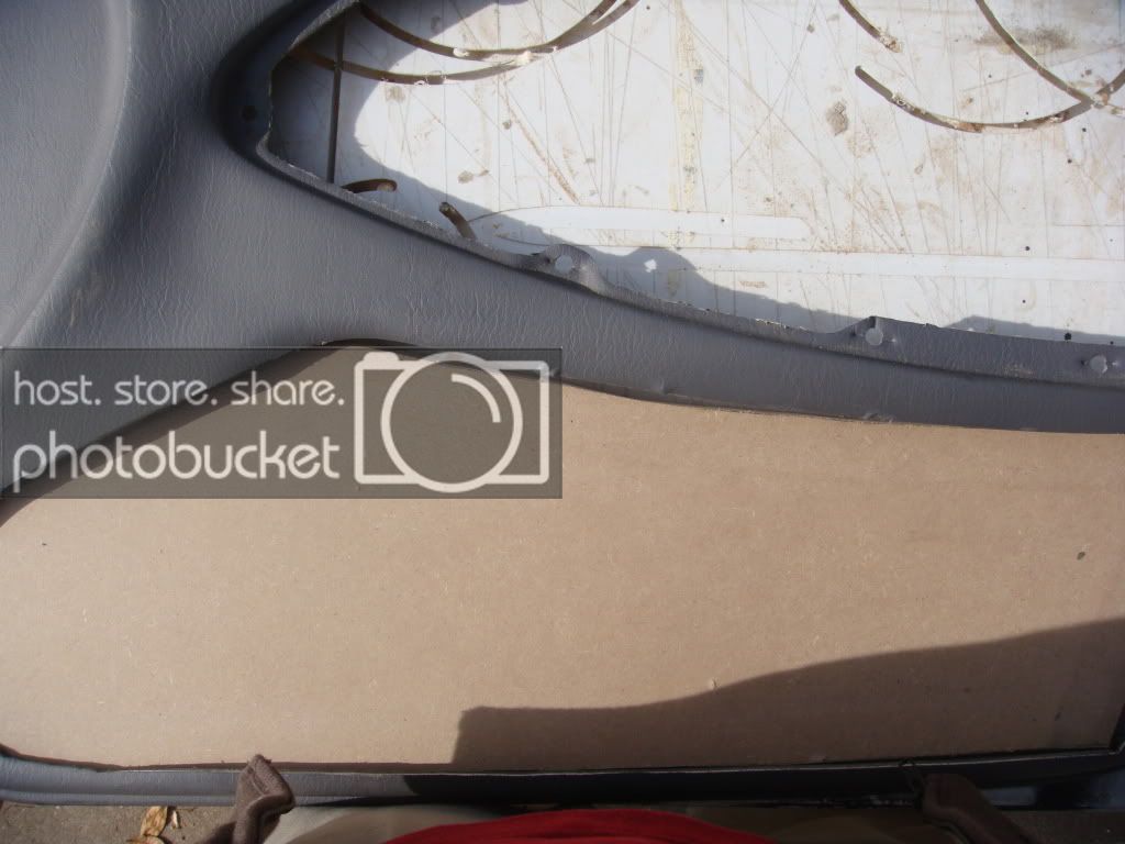

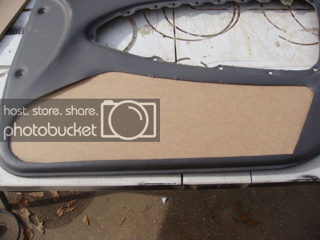

Test fitting it into the door panel.

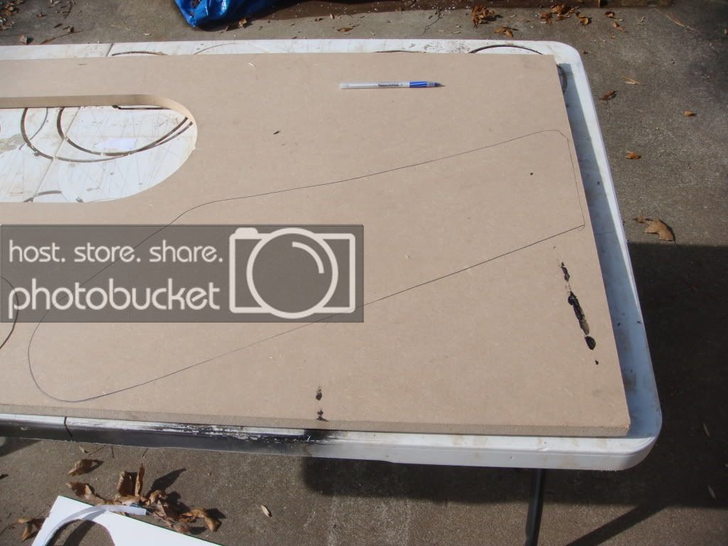

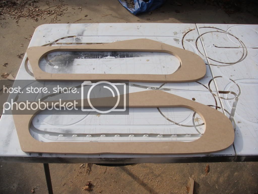

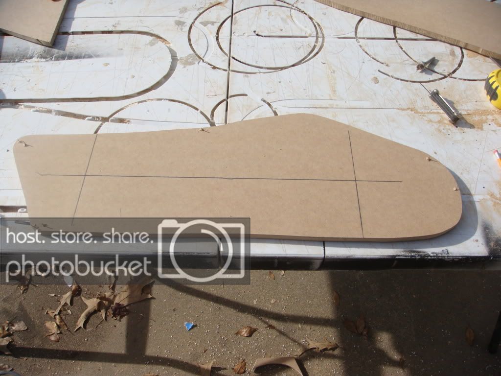

Now that I have the sape of the opening in the door panel I want to create that exact shap but with a 1/2" over lay on each edge of the pattern so that I can adhear it to my door panels. I fist traced out the pattern onto 3/4" MDF.

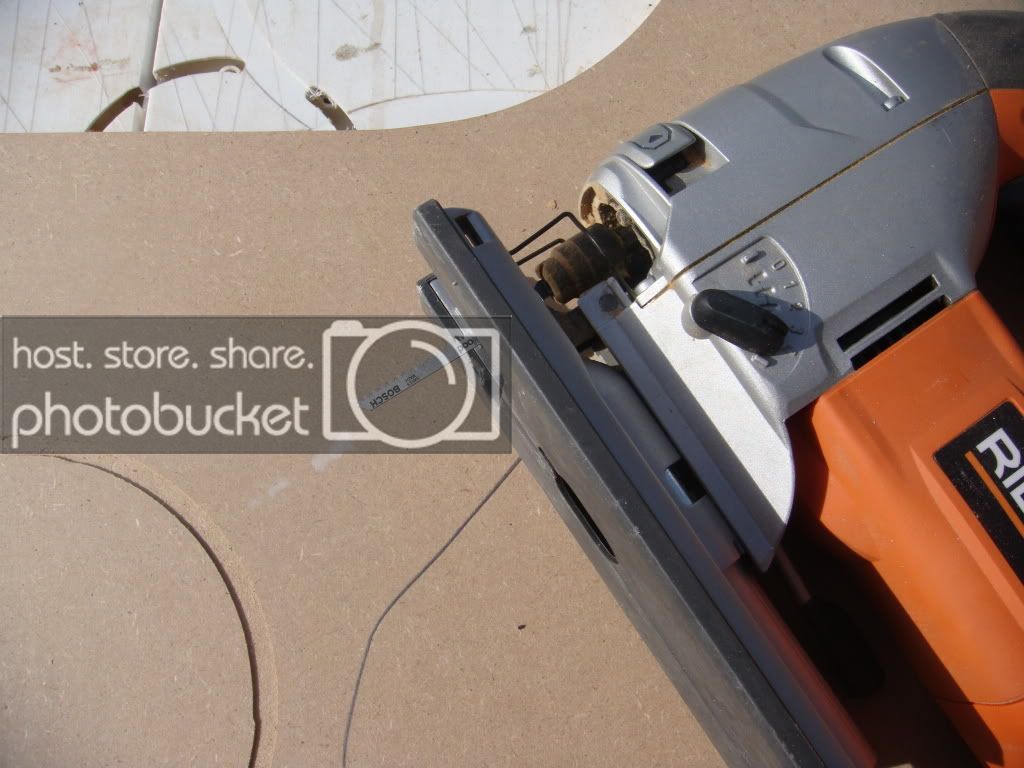

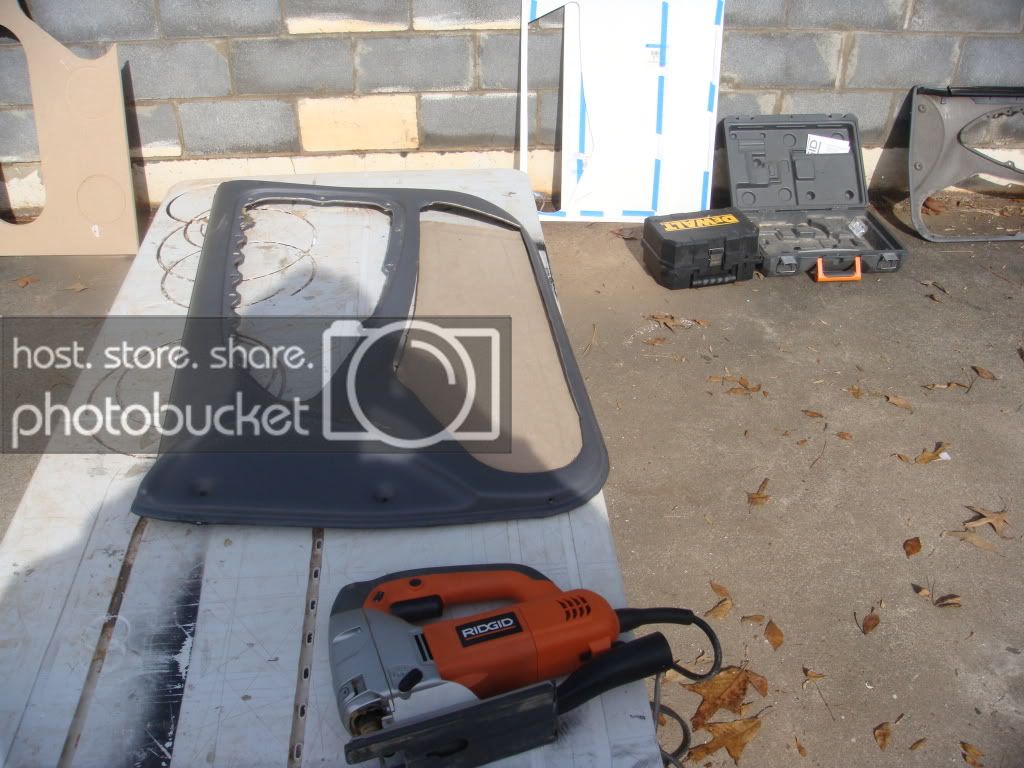

Now using my jigg saw with a fine cut wood bit and cut out the patern.
Got the pattern cut out and now doing a test fit in the door panel.

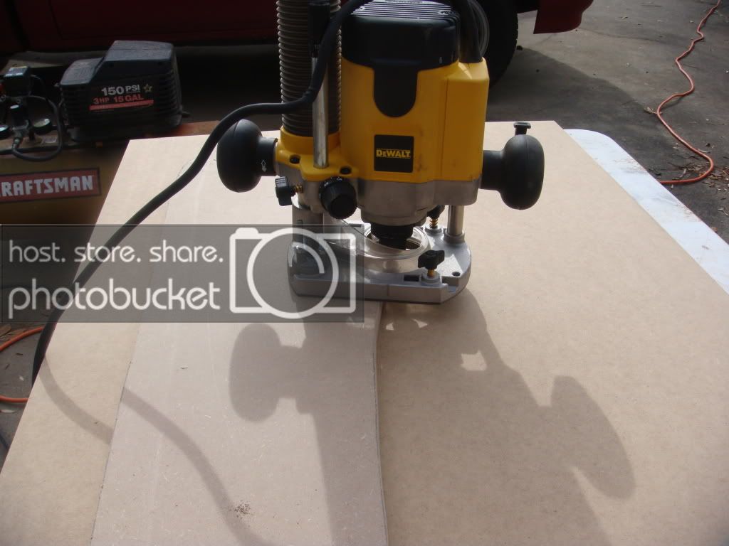

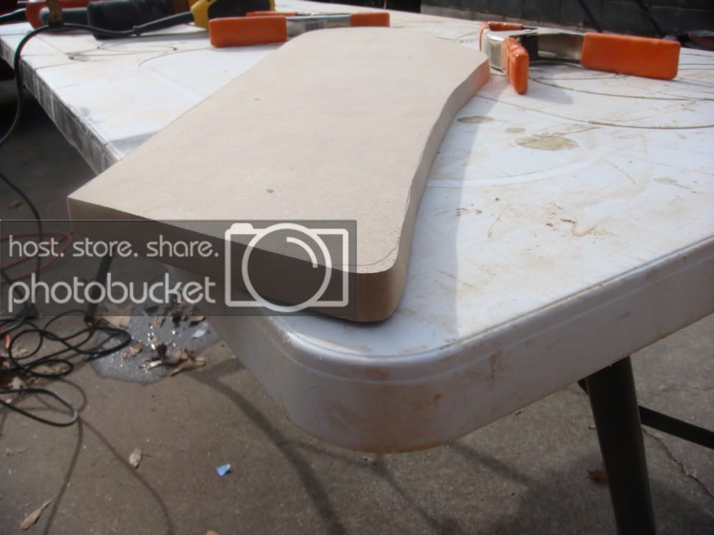

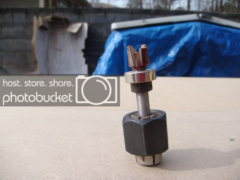

Since I am using this cut ot as a jigg to make my 1/2" over lay I had to fist sand down all the edges and any imperfectins that the roughter might pick up so that my tracer bit would slide over the jigg with each.

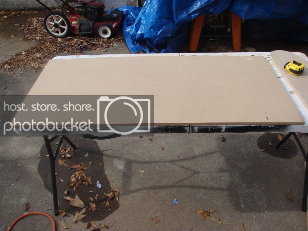

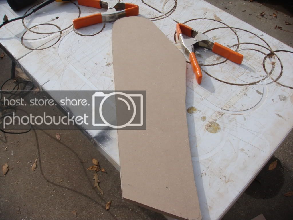

Now it is time to make my template for my 1/2" over lay. I will be using 1/2" MDF for the baffles.

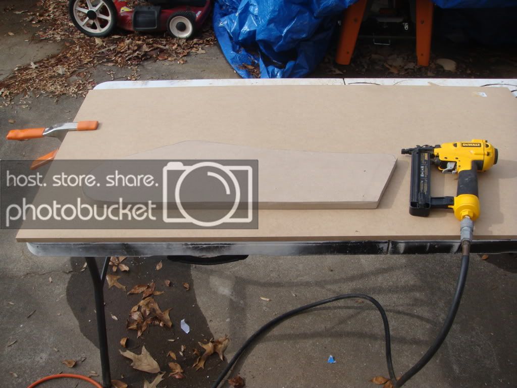

Placed the jigg ontop of the 1/2" MDF and brad nailed it down so it would not mover while I was using my tracer bit on it.
I used a 1/2" tracer bit to go over the pattern to make my template for the door baffles.

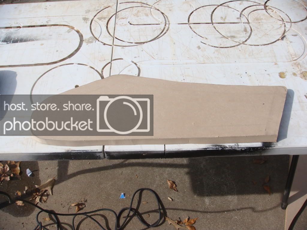

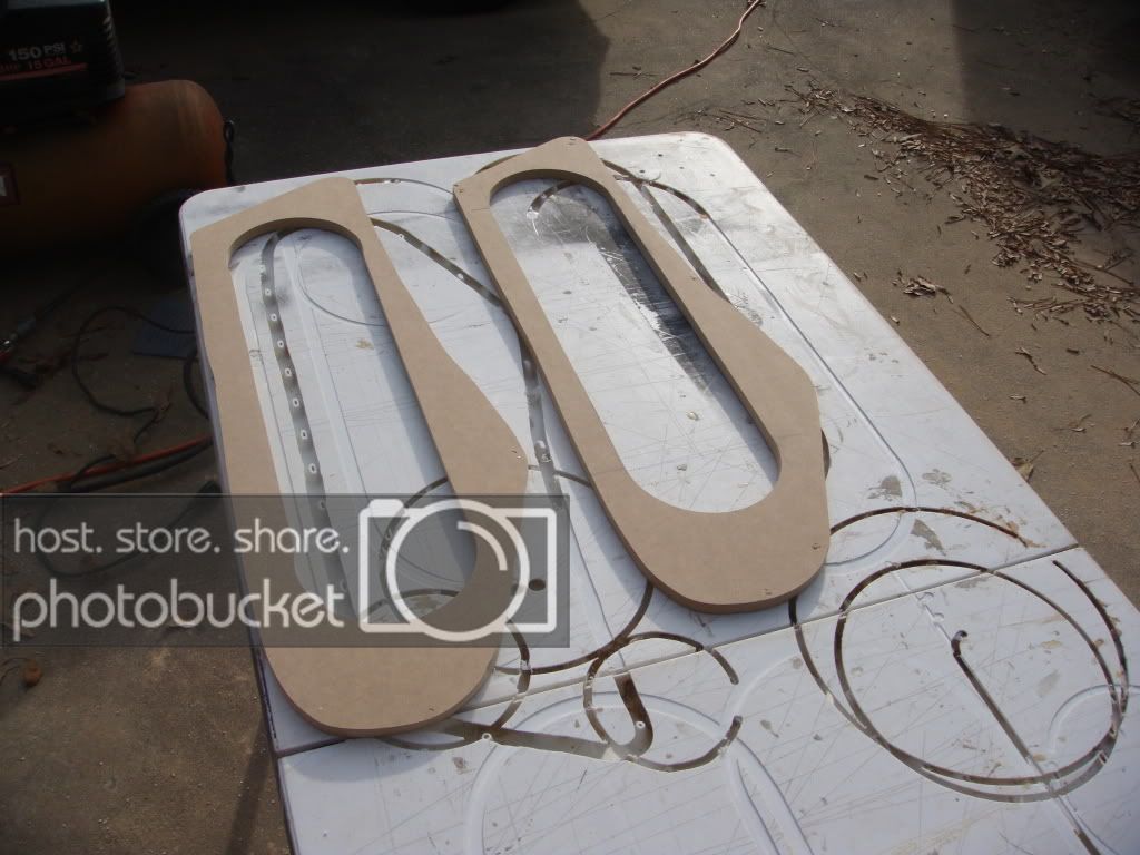

After I roughted out the template I traced the shape onto 1/2" MDF and cut the cut using the jigg saw.
As you can see it is the ame shape as the poening but a 1/2" wider on each side so that I can adhear it to the door panels.
This will giver me a better mount to the door and give the door panel more strength.

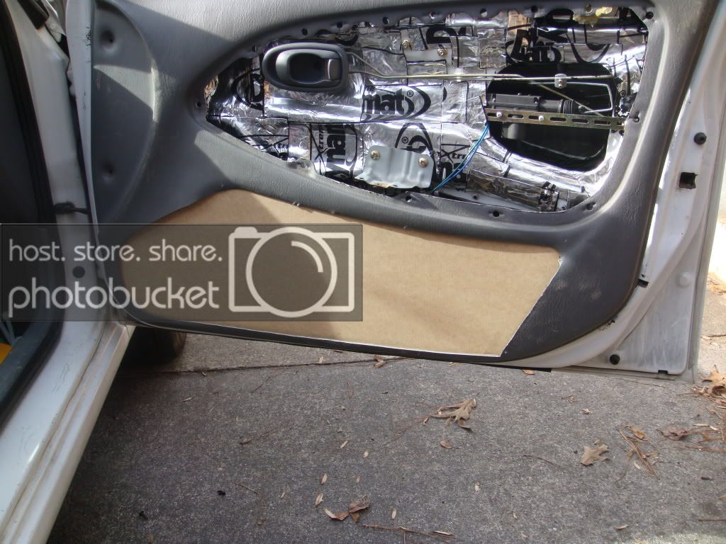

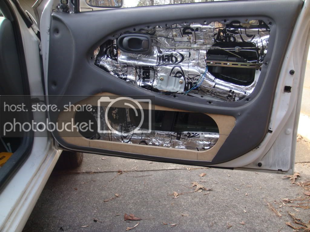

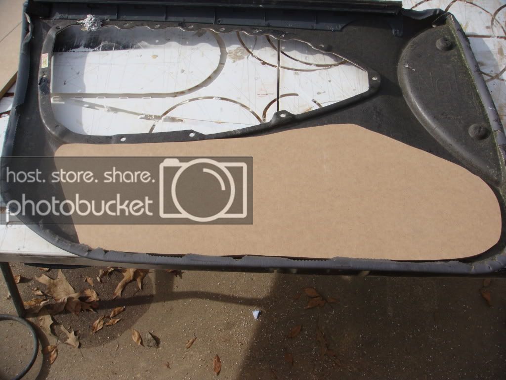

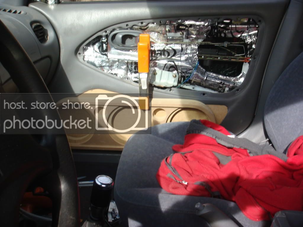

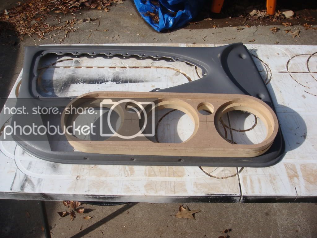

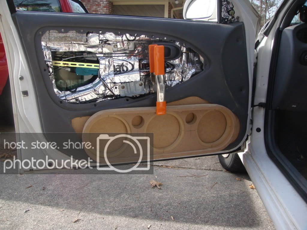

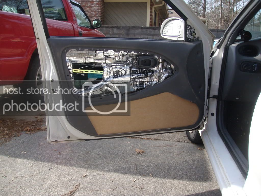

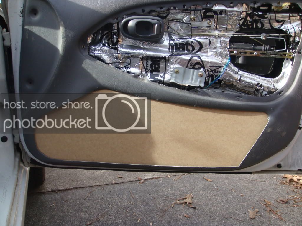

Put the door panels back on to see if everyhting fits right.

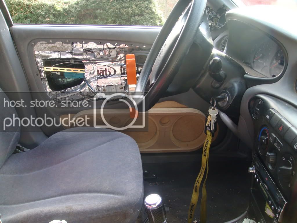

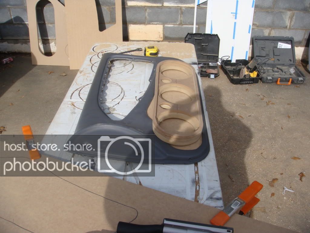

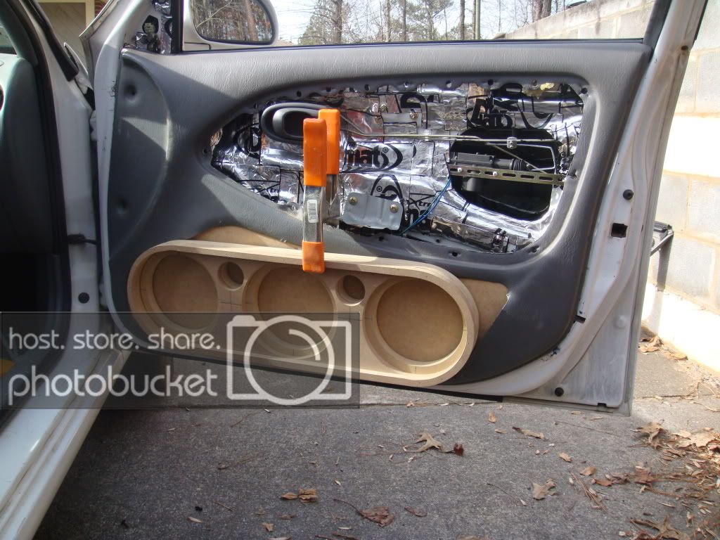

Now testing the spaeker baffle on the door to see that everything will look like.
I had to adjust the baffle a little in order for my glove box to stay functional.

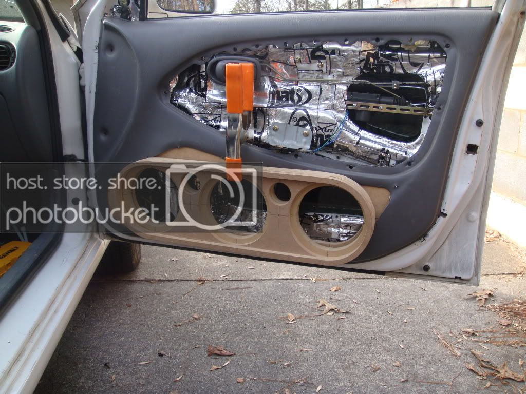

Now repating everthing on the driver side door.

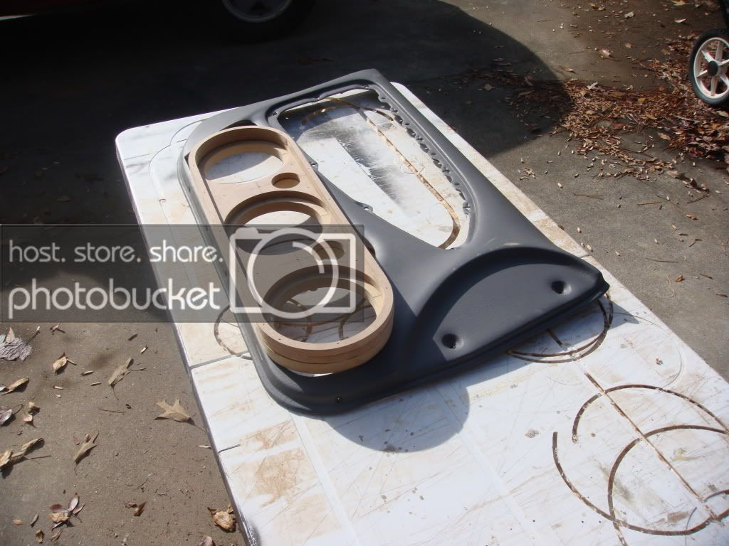

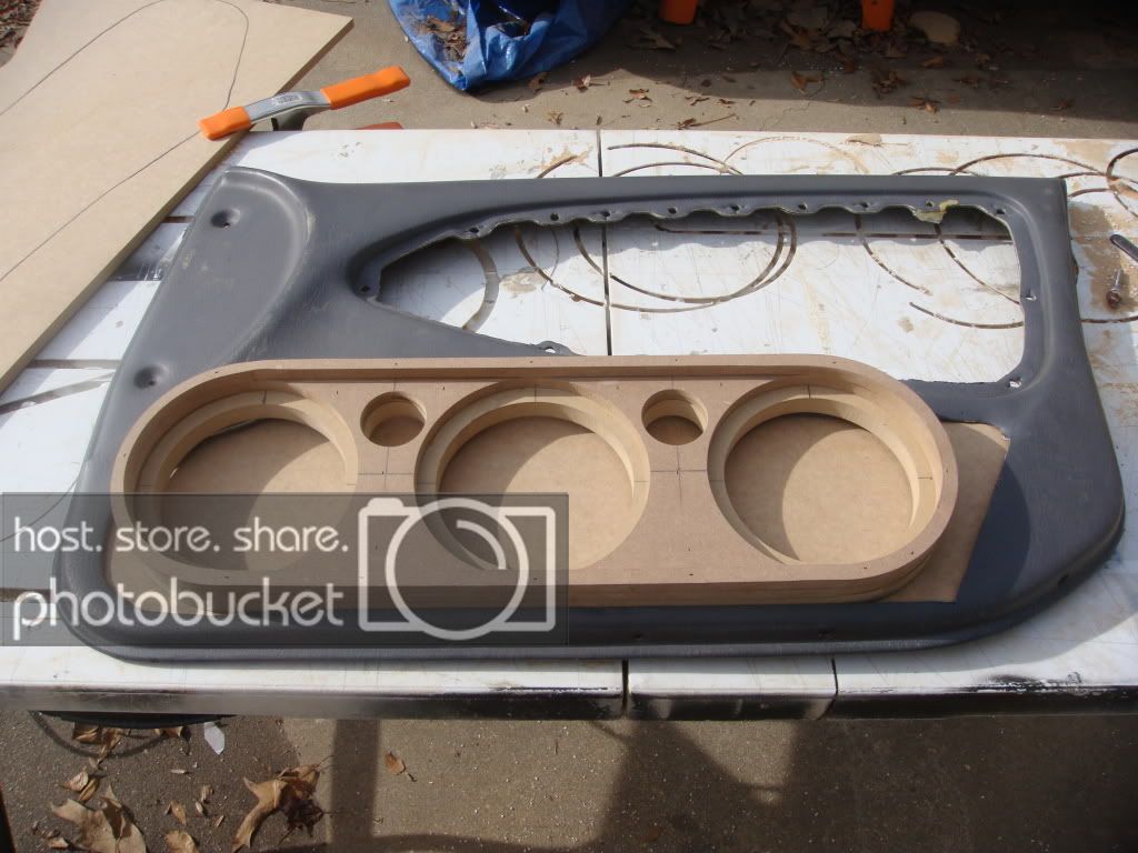

Ok now that everthing fits just right it is time to cut am opeing in the brace I just made for the door panel
After they have been both cut out.
