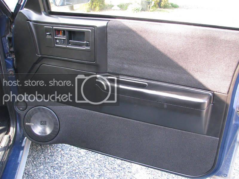

Old doors, which are now in the g/f's blazer.
