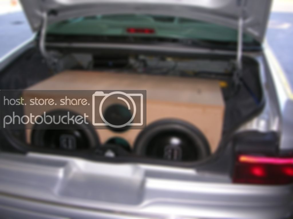

great build but let me tell you something if your demoing that thing bro an you smell coils turn it off or down, i know you should know that by now but i have learned that with these subs when i first put mine in an played it till it smelled an turned it back down now it don't smell at all myself.
haha yeah
Stinky Coils = Not Good

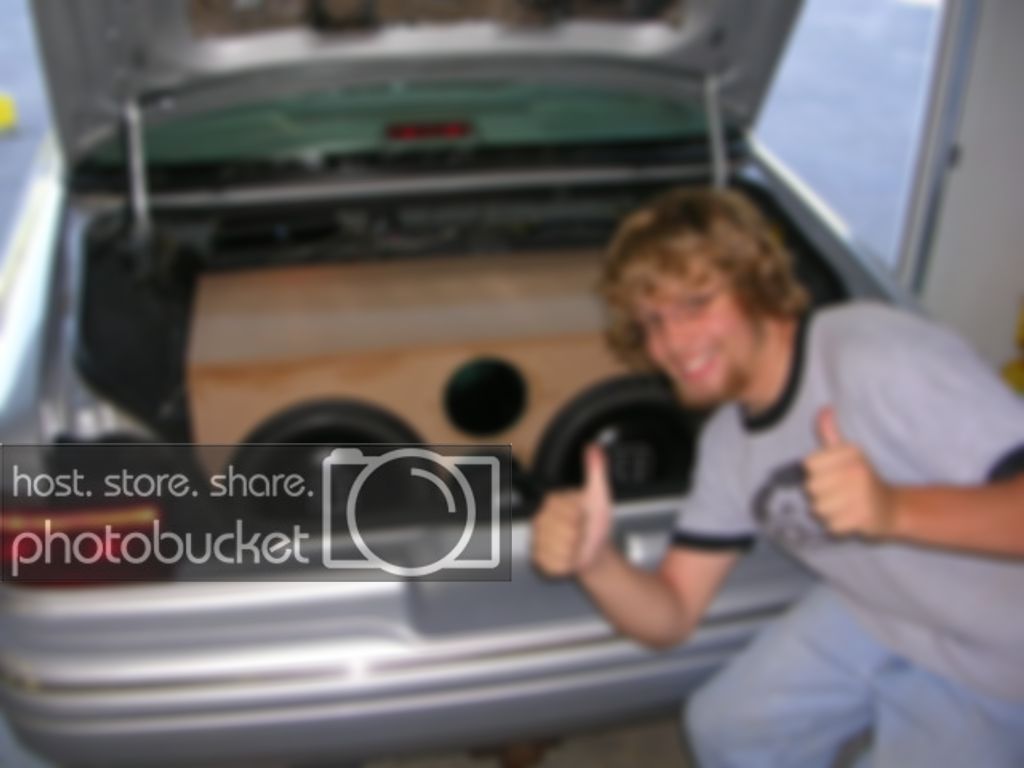

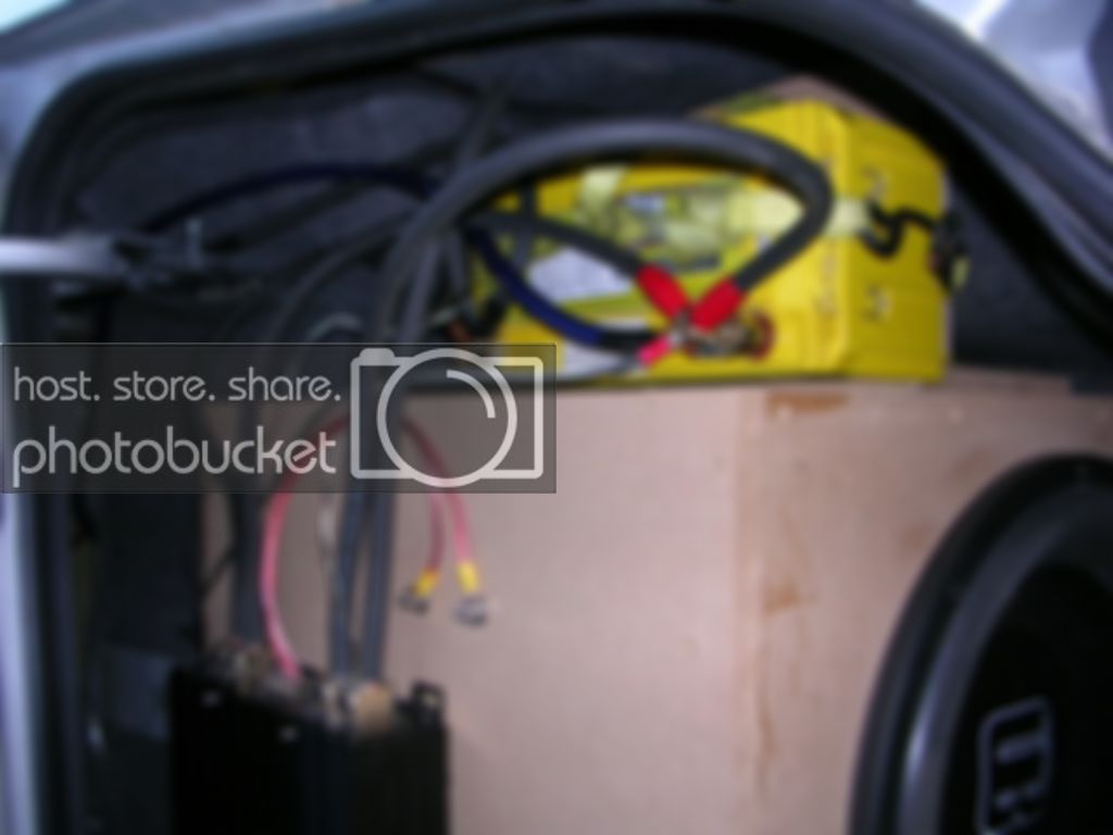

Some finished pictures will be up tonight, I got everything in and the bass is tripping my Fuel Shutoff switch in the trunk //content.invisioncic.com/y282845/emoticons/frown.gif.a3531fa0534503350665a1e957861287.gif
I think Im going to dynamat around that cause Im guessing its from the vibrations.

I would suggest either some rubber mounting feet or a small piece of MDF on top of the box to mount the amp to protect it from the vibrations, but other than that I think it looks great.
Im sure it will be fine, ive done it that way for years, but thats a really nice amp to take a chance with //content.invisioncic.com/y282845/emoticons/smile.gif.1ebc41e1811405b213edfc4622c41e27.gif
