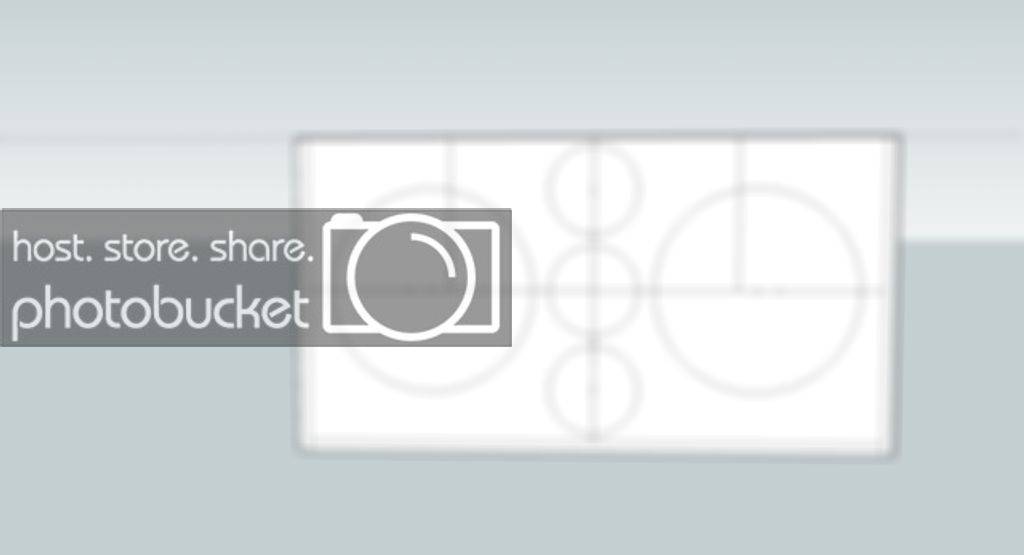

2 RD Alphamax 15s in 9 Cubes at 34Hz (Aero, Grand Marquis)
97 Panthers FTW...I wonder how many cubes I can get if I use the wings on the trunk as well. Gotta the the measuring tape out, I need at least 10.5 cubes.
Yeah I think I figured you can if you have 4" wings on each side around 8" up until about 22" or so and that gets close to your target cubes.
This box is 40" wide by 23" deep by 22" tall if I didn't say it already
You know those arent actually "aero" ports right? The flare is what gives them the efficiency, to be able to run less port area, the guy with 5 6" aeros probably had flares im assuming....

Yeah he has flares and I know PVC isnt technically Aero since I think that is a copyrighted name??? IDK Anyways It should be pretty good either way....

Aeroports are PVC pipes with flared ends. The flared ends help reduce port noise and smooth out air flow. When you use aero's you are supposed to be able to get away with less port area, if you just use straight PVC it won't help as much.
still PVC or what ever round port works better than slot port,i had a box for 2 12" with remobable port and had slot and round and got better response with the round one with the same port area //content.invisioncic.com/y282845/emoticons/biggrin.gif.d71a5d36fcbab170f2364c9f2e3946cb.gif
Unflared pvc is no better than slot
Heat the fvcker up and flare it!!
argh well I might but I dont have much room and if I flare it then my ports are too short...
What if instead of flush mounting the aero I inlayed it like .75-1" and did a round over on the front baffle so that it was the "flare" would that work?
yes that would help flare the pvc.

As soon as my dad wakes up I'm going to router the holes, unless I get a good reason behind flaring but I don't see it making a BIG difference.
Ok then I might do this

Got the holes cut, no pictures of that but I will post em tomorrow
As for bracing I think I'm going to do either 2 or 4 2x2s front to back down the middle of the box to add strength.
