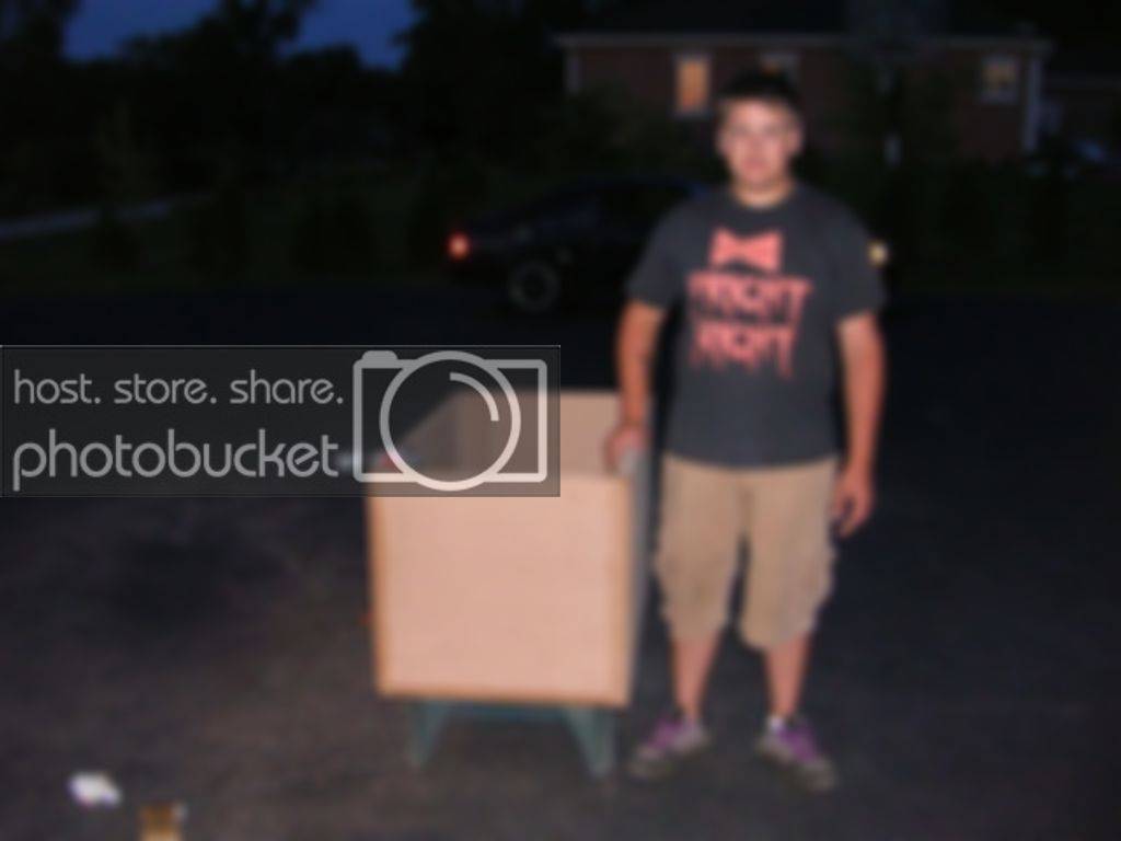

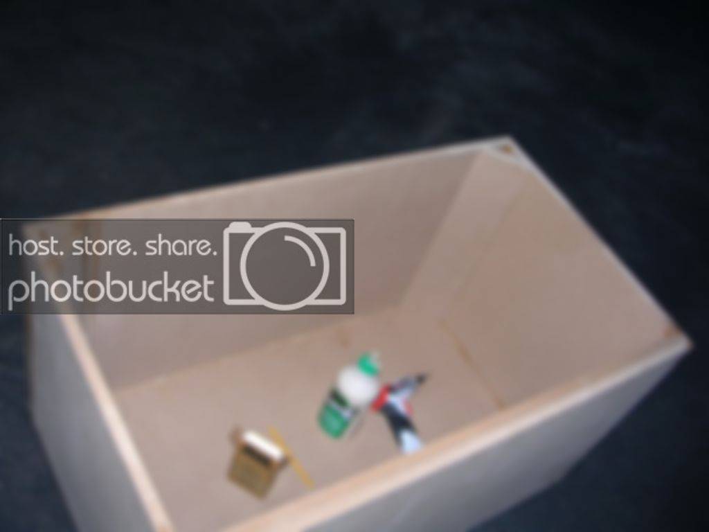

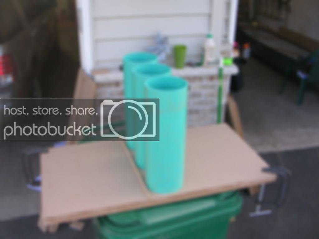

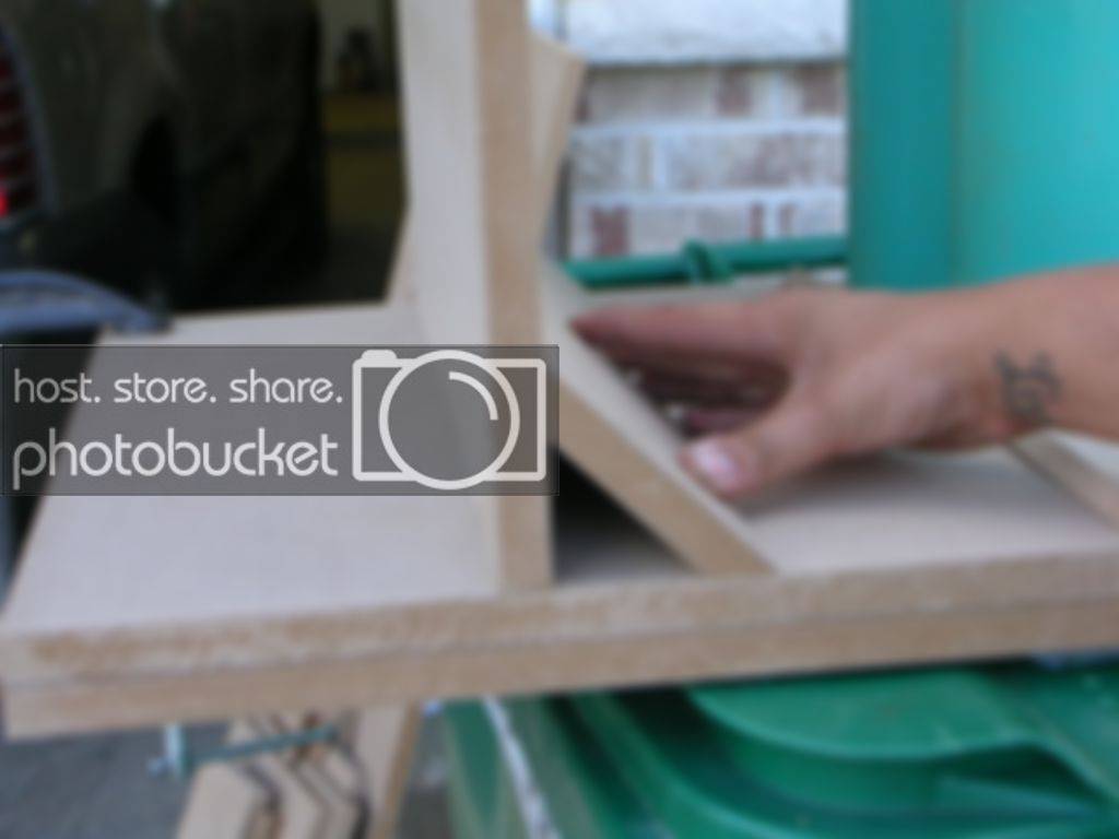

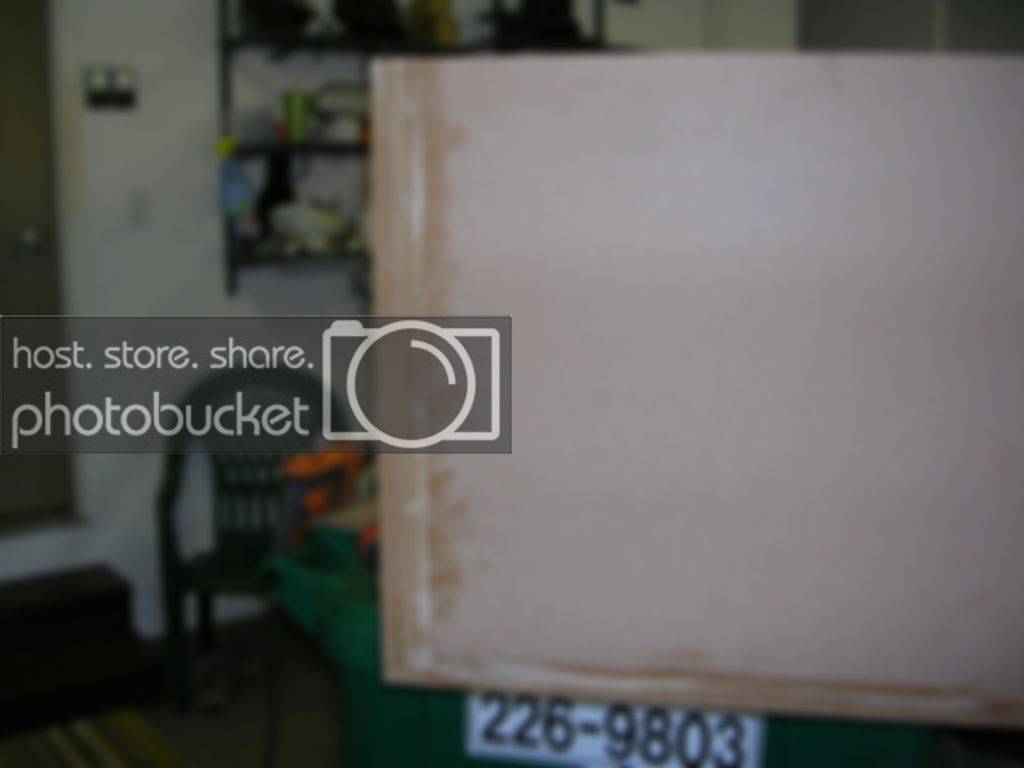

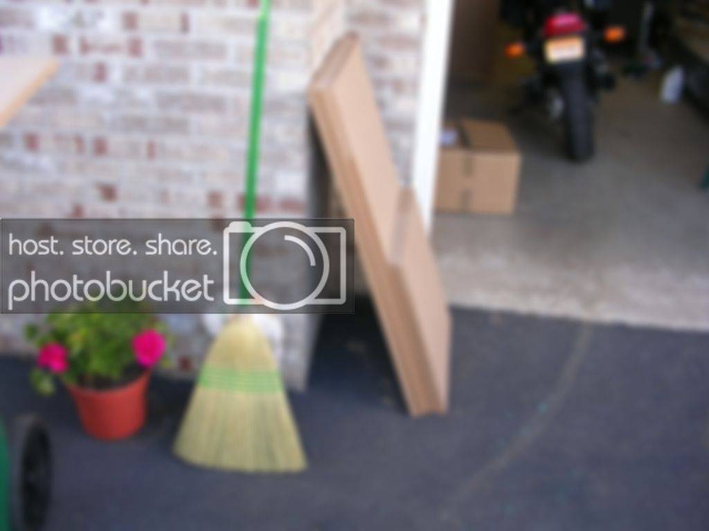

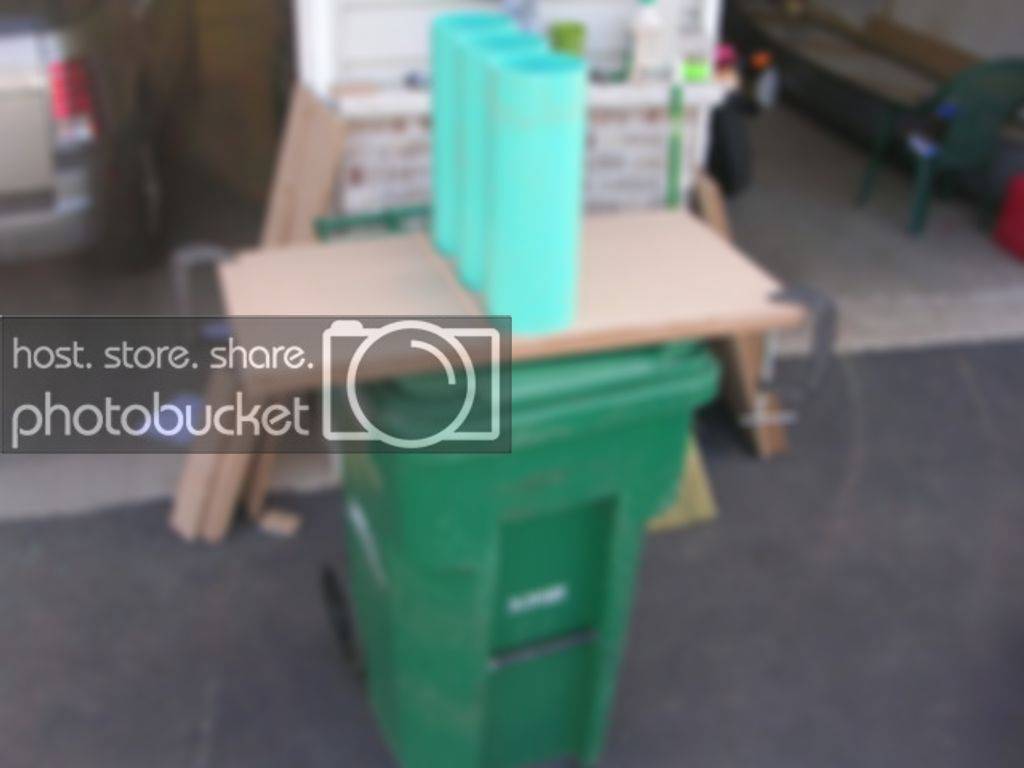

So I did it, went and got 2 15s..... Just a small upgrade from my current 10s
2 RD Alphamax 15s
~9.1 Cubes @ 34hz

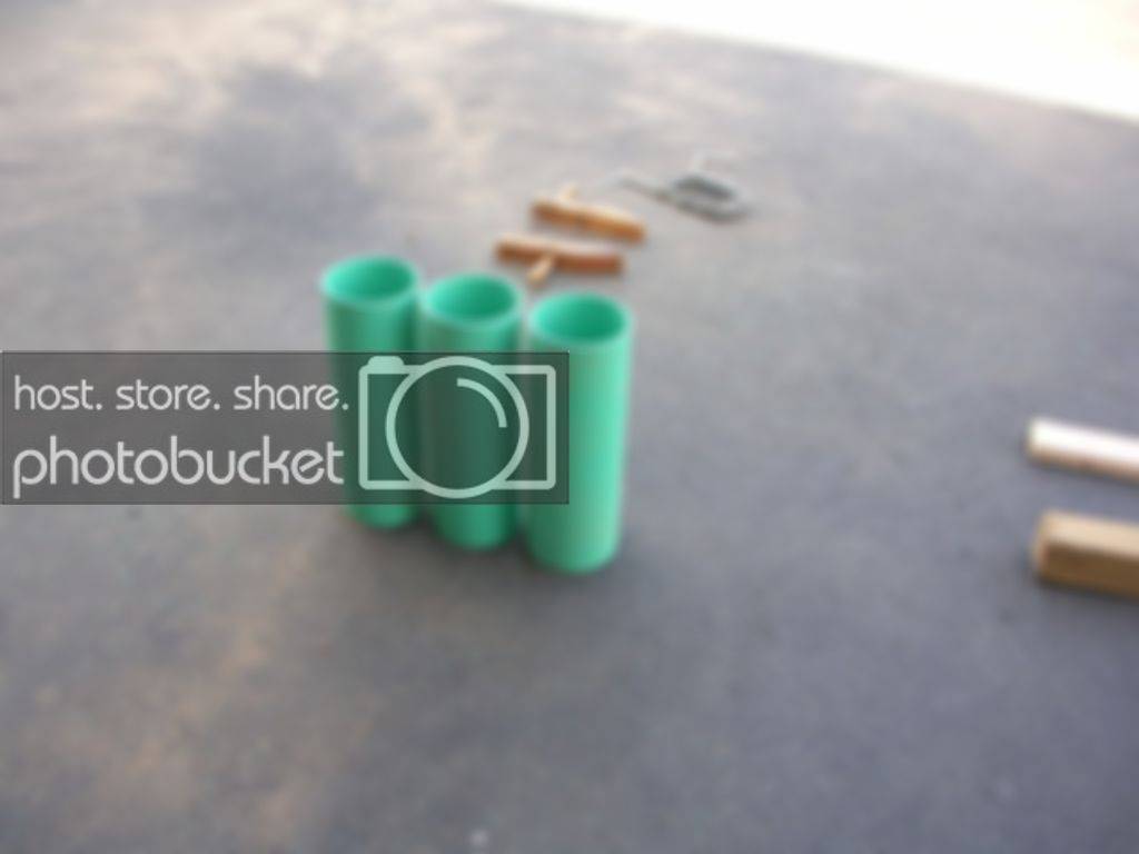

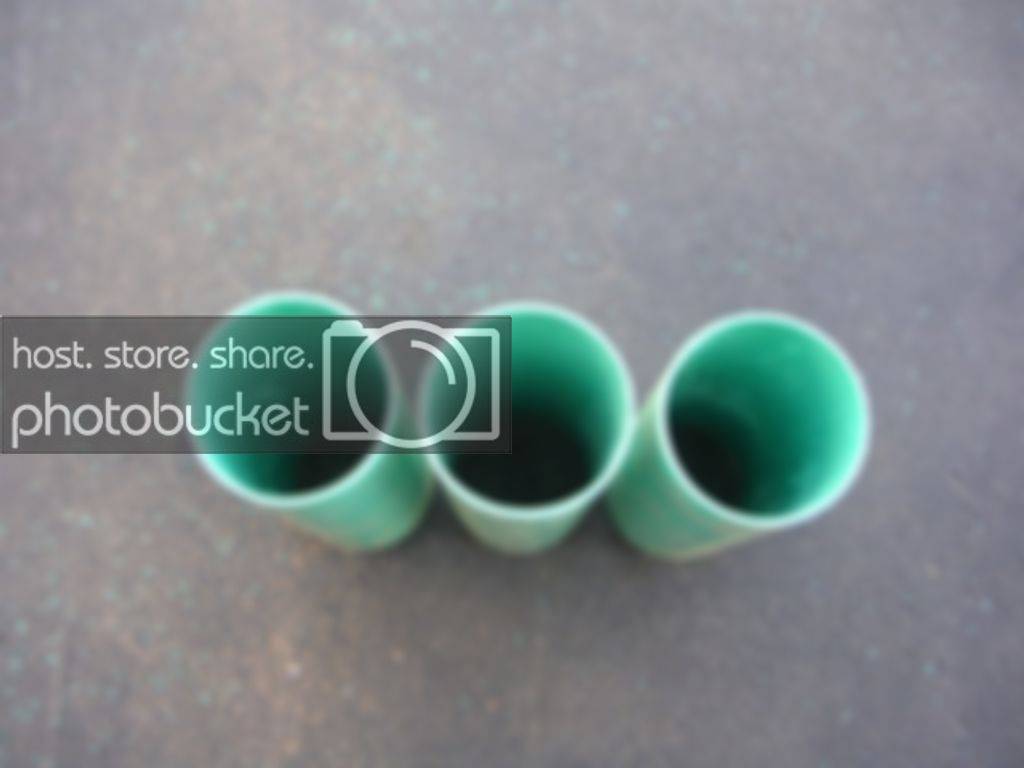

3 6" Aero Ports

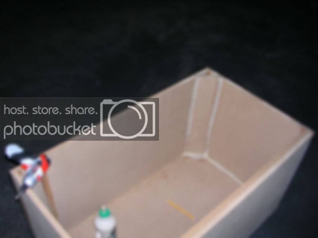

45s in the rear of the box
Double baffle front

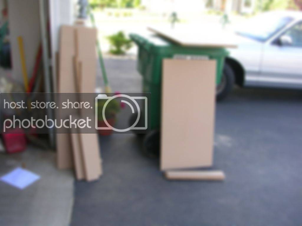

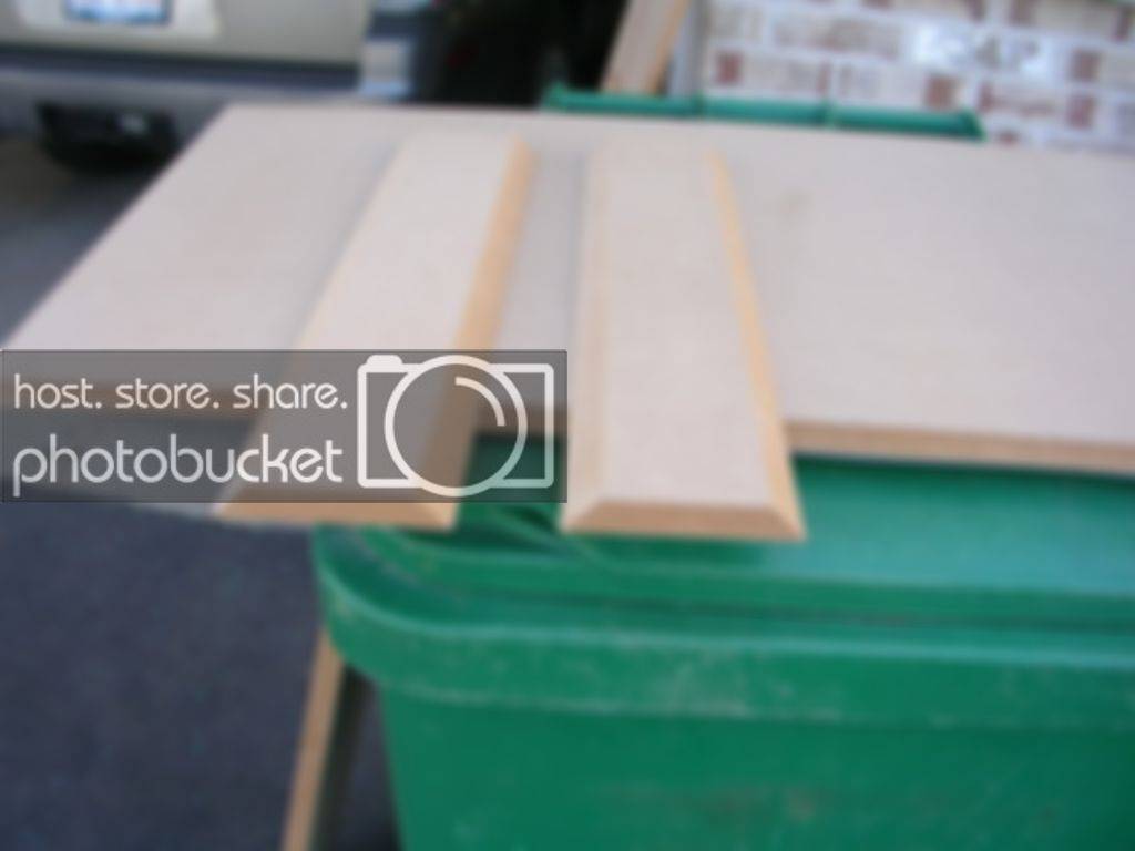

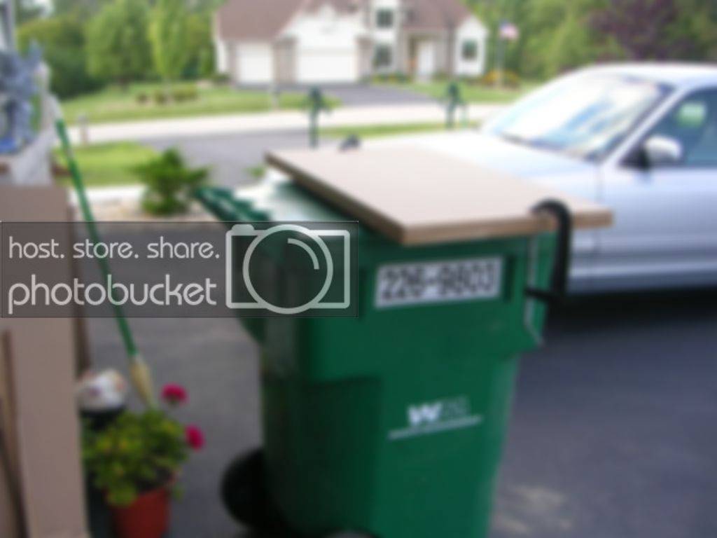

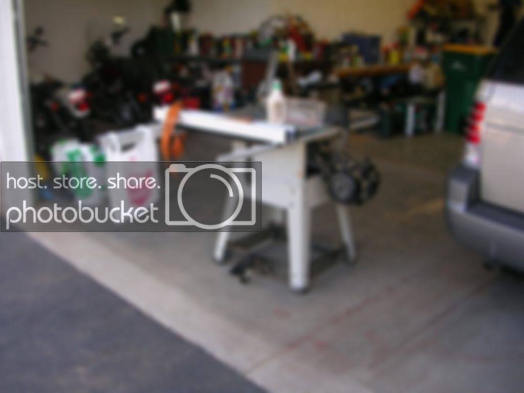

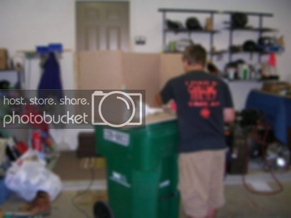

My buddy Josh came over and helped with it, also my dad helped us cut the massive 4x8 sheets haha
On with the pictures

nice box men, i also have a 9.1cuft @ 32hz box, taught about 3 6"ports but went with 2 8",keep the pictures coming
Thought about doing that but I dont think I have the room, maybe... either way I had a 10ft section of 6" PVC just begging to get cut //content.invisioncic.com/y282845/emoticons/biggrin.gif.d71a5d36fcbab170f2364c9f2e3946cb.gif

You know those arent actually "aero" ports right? The flare is what gives them the efficiency, to be able to run less port area, the guy with 5 6" aeros probably had flares im assuming....
Looks good though
