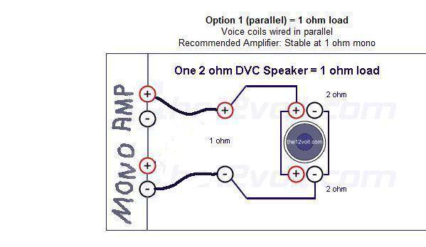

I have Cadence A7+HC and a SoundQubed HDS312. I want to verify so I have it wired properly
The amplifier has two speaker outs. Each pair is labeled 2 Ohms. Then each outside terminal is used for 1 ohm.
Like this:
[*][*][*][*]- Terminals
[2][2][2][2] - 2 ohm each pair
[1][X][X][1] - 1 ohm to outside terminals.
I can't take each sub +/- to each amp +/- for the amp to see a 1 ohm load or do I have to set it up like this:
So, it sees 1 ohm either way? or only sees 2 ohm load if not like pictured.
Not sure how to get two 10 ga wires in one sub terminal to do it as pictured.
