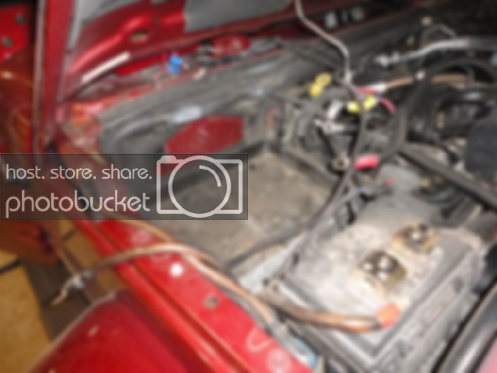

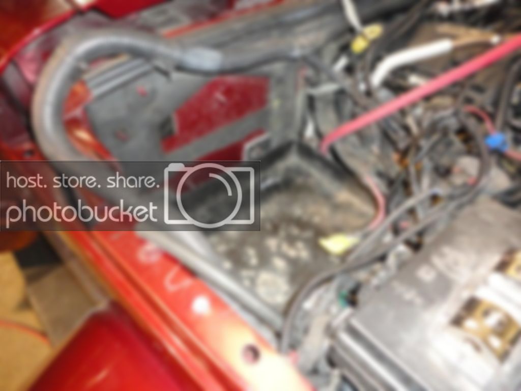

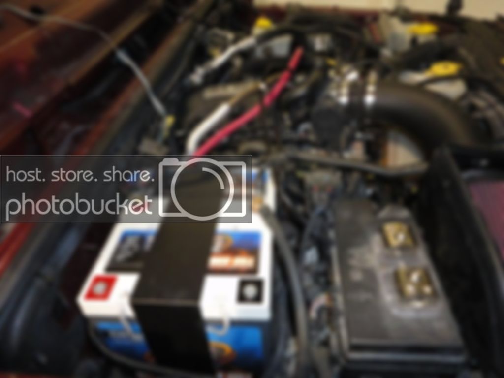

out with the old

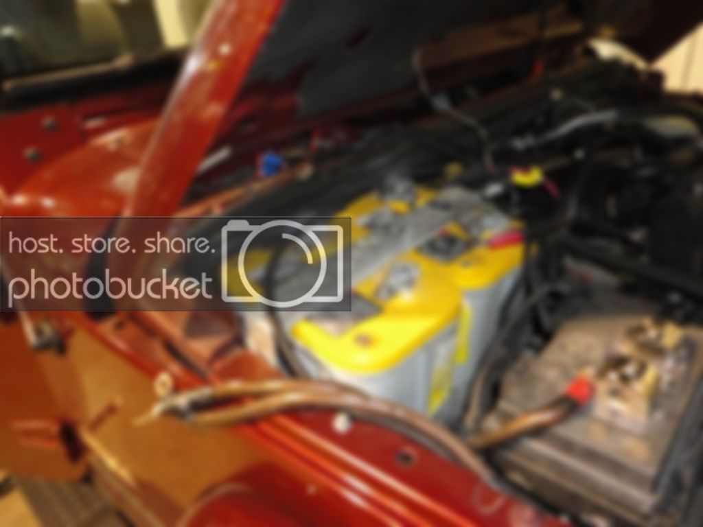

Had to move the bracket down 2 inches for the XS d5100s

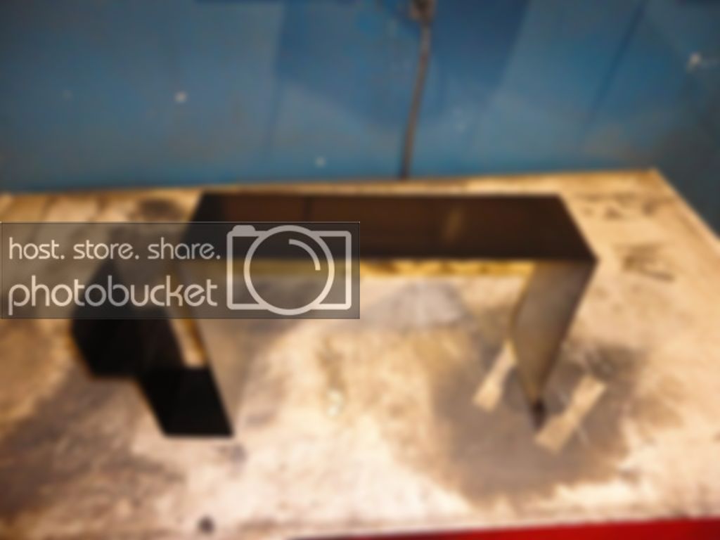

Made a custom aluminum bracket for my batteries, painted semi gloss to match

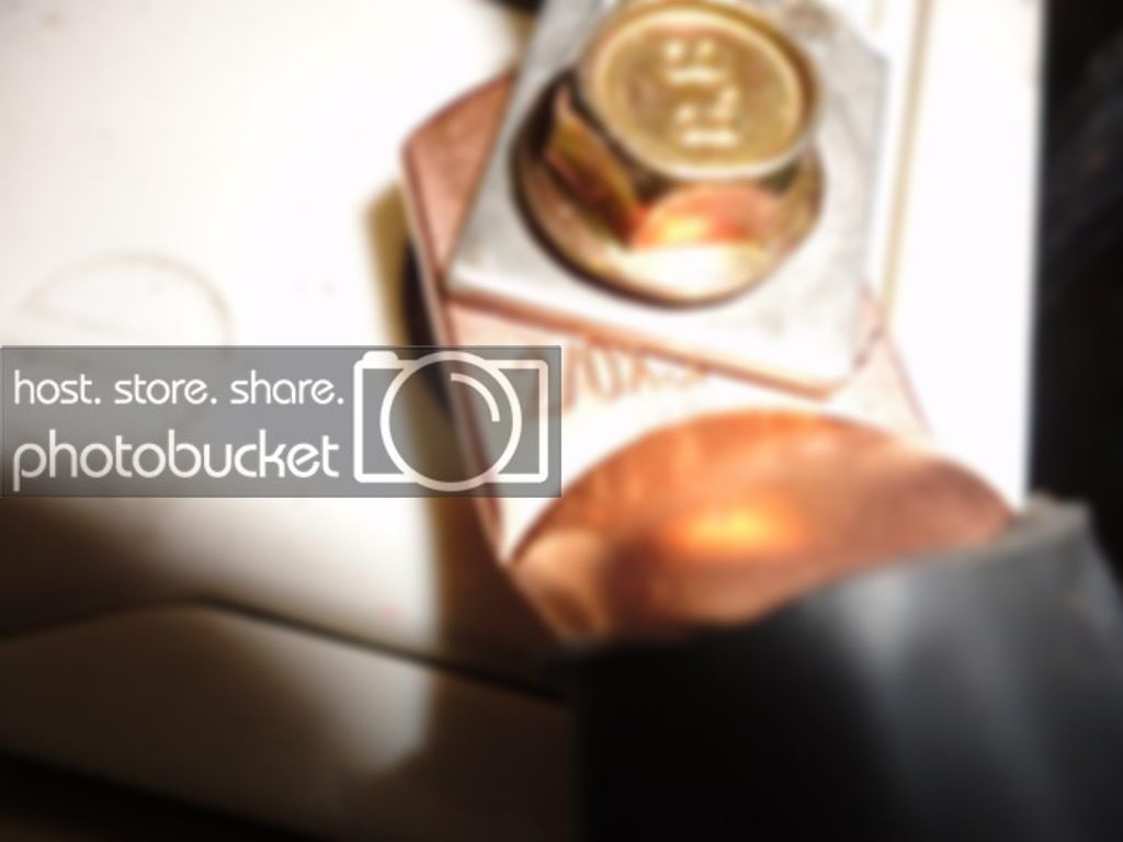

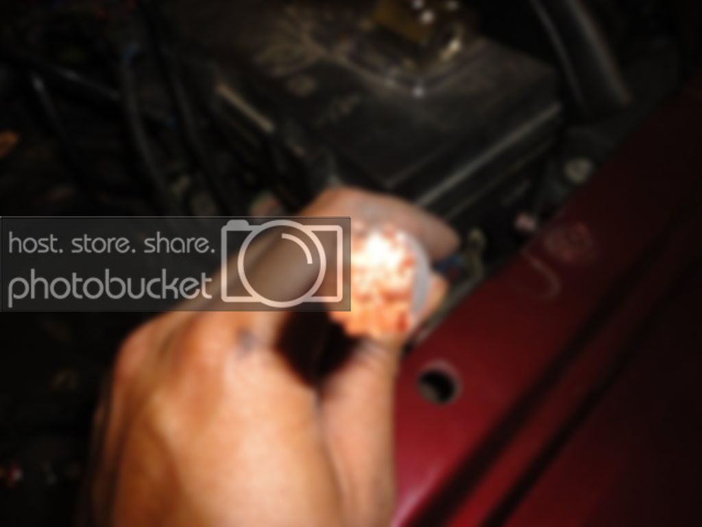

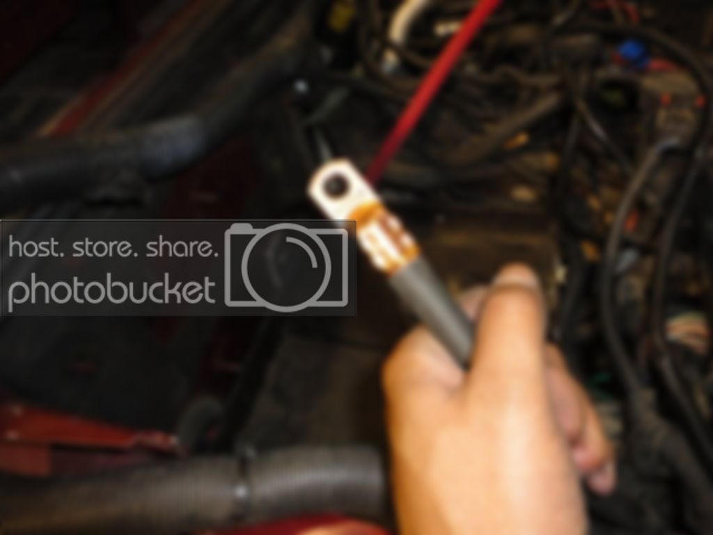

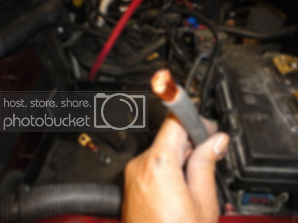

2/0 gauge welding wire i got from my supplier
Thick and flexible
I used soldering pasted and melted that, then i crimped it
more pics on the way //content.invisioncic.com/y282845/emoticons/smile.gif.1ebc41e1811405b213edfc4622c41e27.gif
